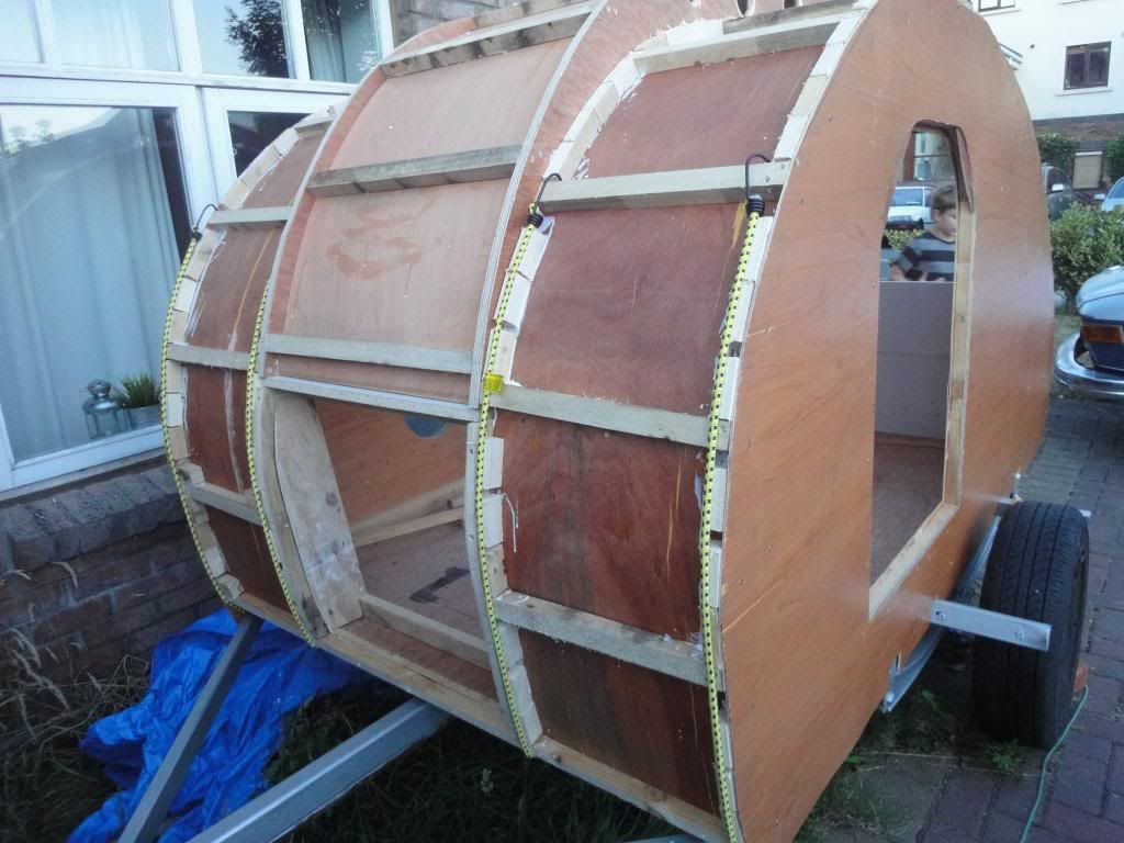

Bit more done today.

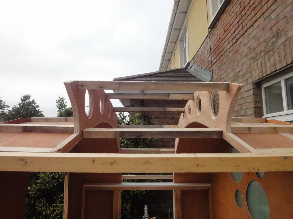

Made the rest of the spars for around the front box..
Managed to stick on the one on the right crocked and by the time i noticed the glue had set so i just left it :oops:

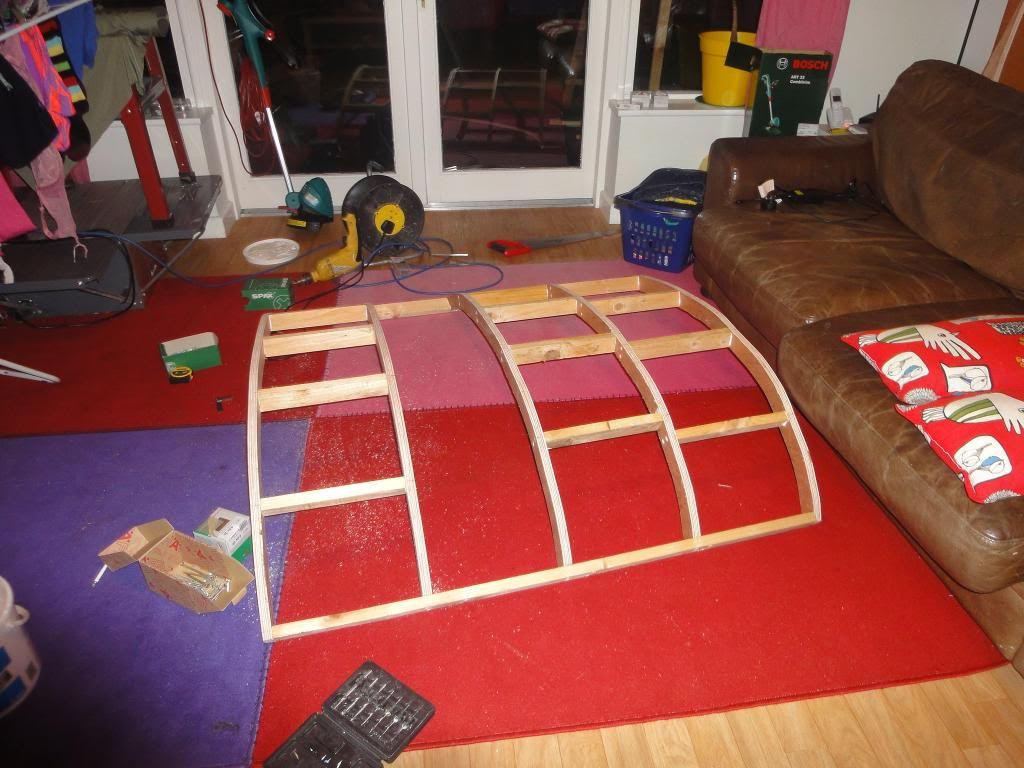

Then i made the spars for the trolley top bit.
I also got another 4 layers of PVA on so i'm up to 10 layers now.

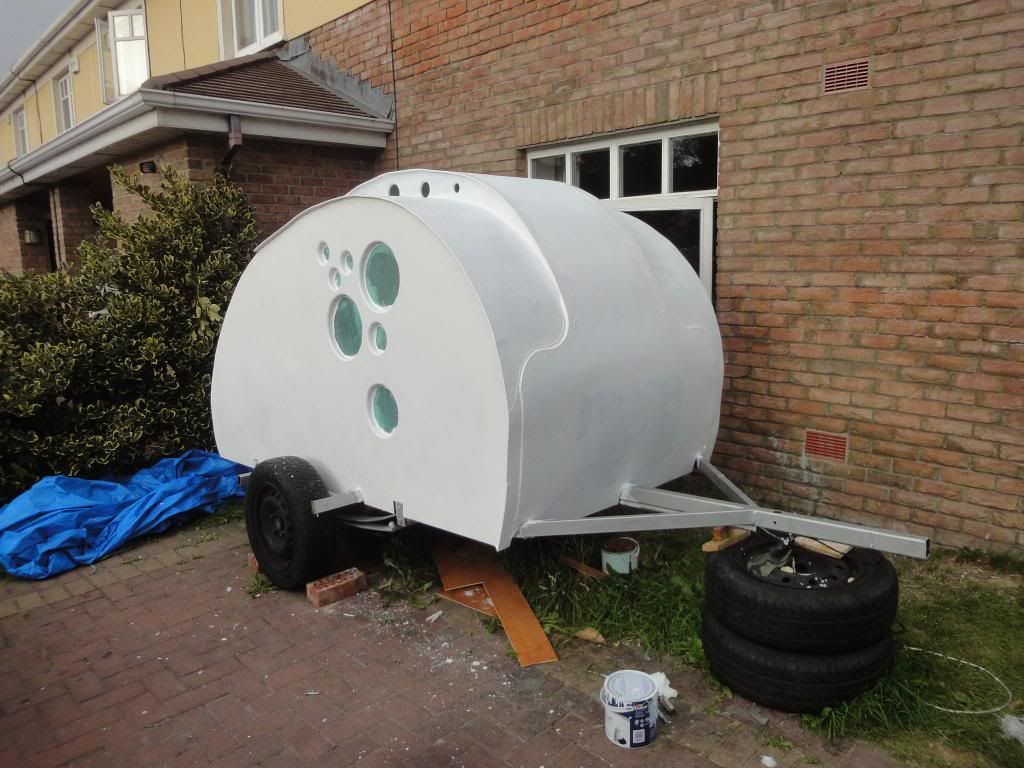

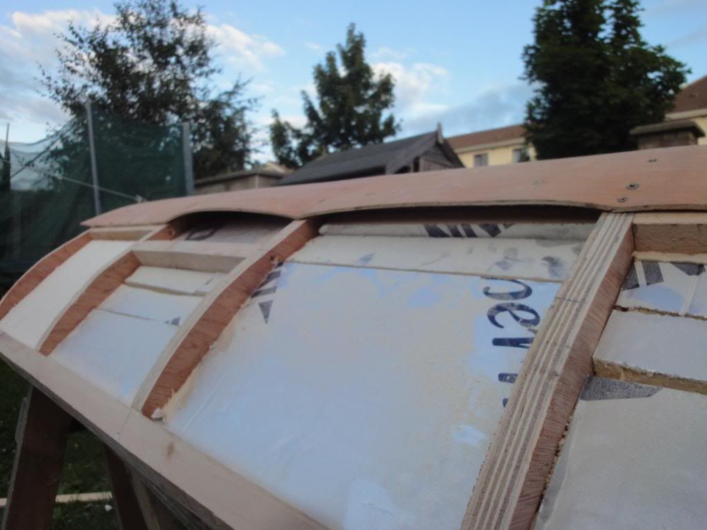

Well the drought is over, we had almost one month with no rain and it made up for it in the last few days with 2 months worth of rain in 3 days.
But i still managed a few bits between the showers.

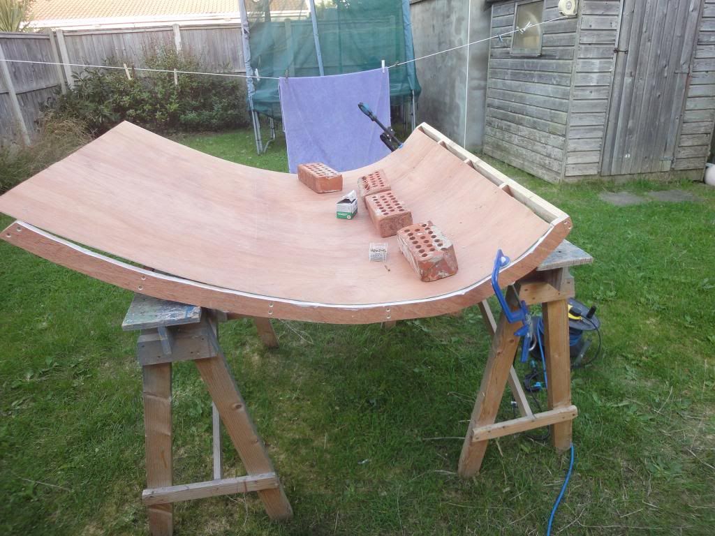

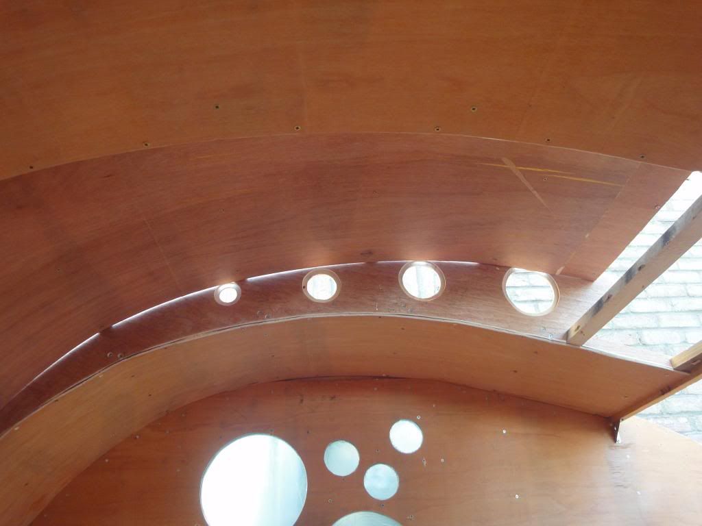

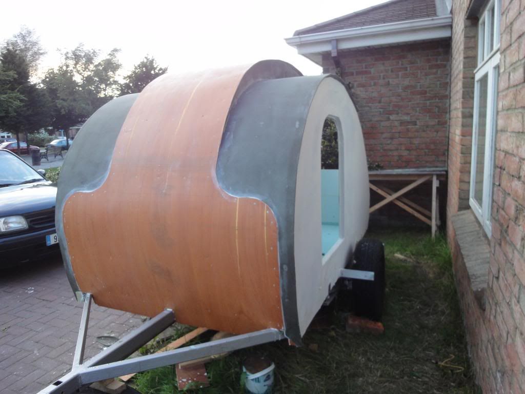

First was the remaining piece of the interior roof. this bit was more trouble than i taught it would be. I cut it to the right width but it was to tight to get in so i cut it abt smaller and it was still to tight. After it was cut for the third time it went in ok but cracked right across the grain when i went to bend it in place.
So i put the damaged end where it will be hidden by the vent later on...Also you might notice the slight miscalculation in the placement of the tolley side windows :oops:
I'm not changing them now. just another design quirk :roll:

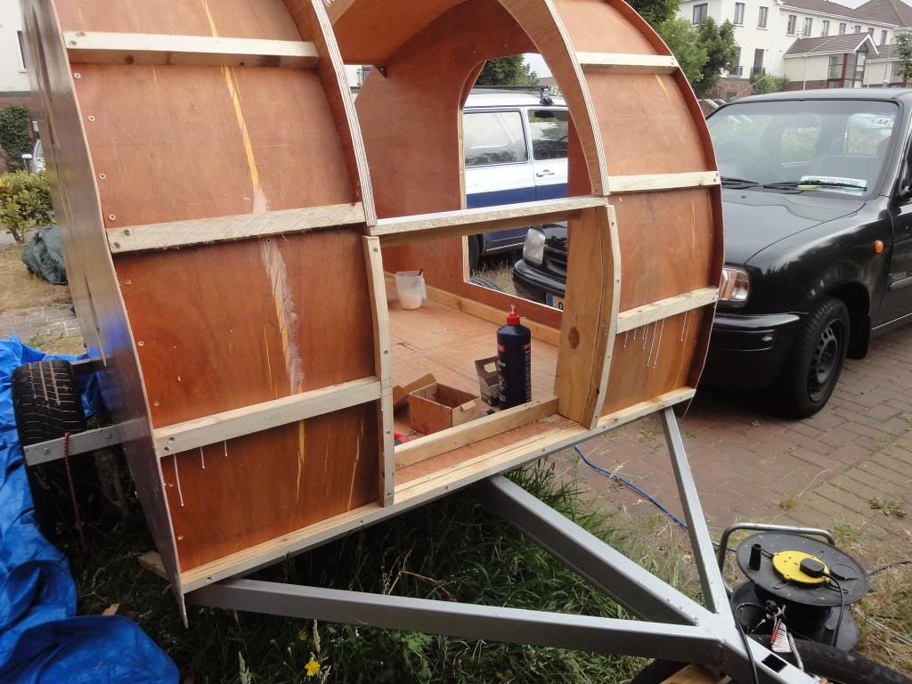

Next i cut all the little blocks for the blocking and spent a few hours glueing them all in..
Then it was time for the biggest experimental part of the build. I have a large roll of tshirt type material left over from an old job i did a few years ago. This type of material works great for fibre glassing weird shapes so i taught it might work to cover the trailer but instead of resin i'm trying it with a 50/50 mix of water an pva glue.
Hopefully it will stick and also tighten up when the glue dries. I'm putting the sides on now so the roof will over lap them later.

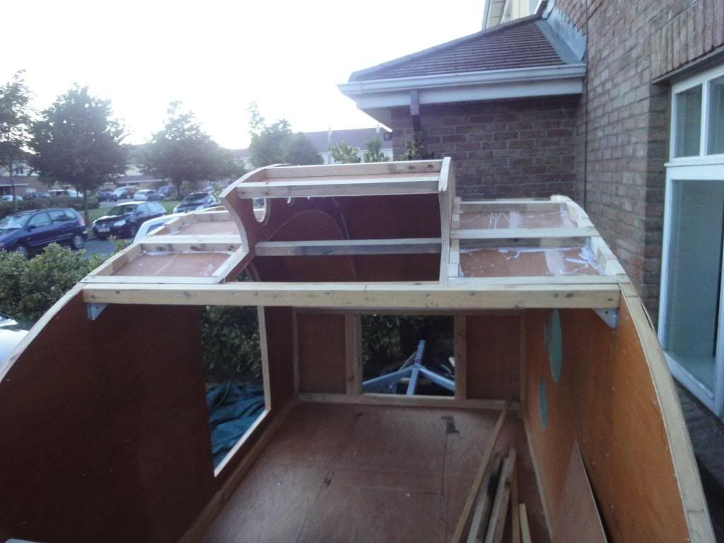

Lot's done today. My helpers came back from holiday so things are speeding up at last.

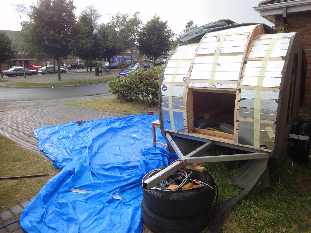

we got the insulation in the roof done and then turned the trailer around so the sun would help dry the multipal layers of glue we would be painting on the cloth covering.
then i assembled the 3 bits of the roof upside down so i could seal the underside of the join with the same cloth and glue mix.
then we threw covers over everything and waited for the rain to go away :worship:
and the final bit for the day was to skin the roof... :applause:
feels more like a teardrop now :R

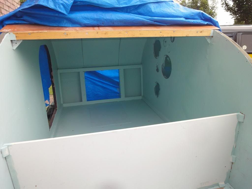

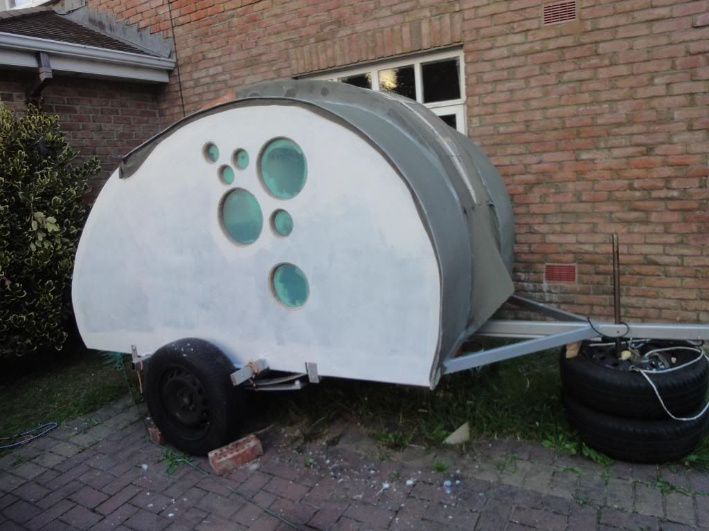

Doug, there where two errors made while making the trolley sides. The first was i corrected the wobbles that didn't need correcting and the second was i made the spars thicker than they where originally designed to be to allow for the over thick insulation but never adjusted the sides in height to allow for the extra thickness. It's my first teardrop so mistakes are plentyfull :oops:

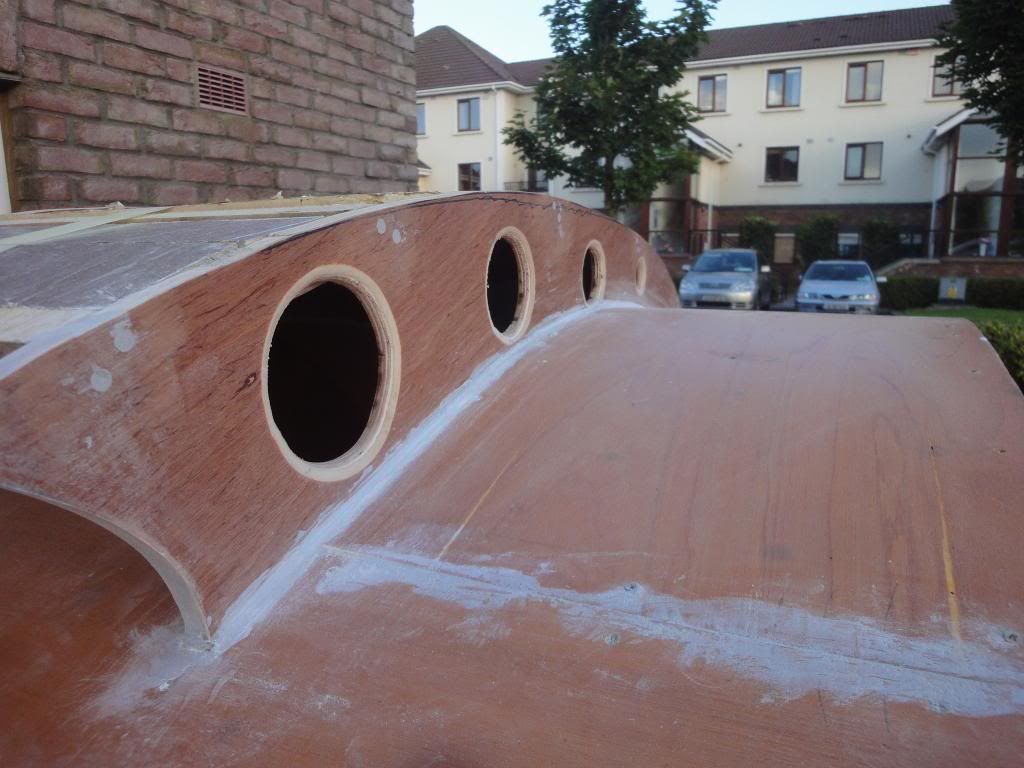

In the last few days the rain has decided to stay so not much building got done but i did manage to get some bits done.
The first was to fill the joins in the roof to make sure no water could find it's way in
also filled tons of screw holes and spent many hours sanding. :SH

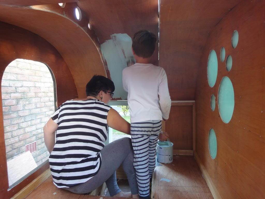

while i was doing all the sanding i got the other two to start undercoating the inside.
I found an old tin of mint green emulsion in the shed.. yucky colour but good as an undercoat. Here it is after 2 coats...
good thing i left those windows masked :lol:

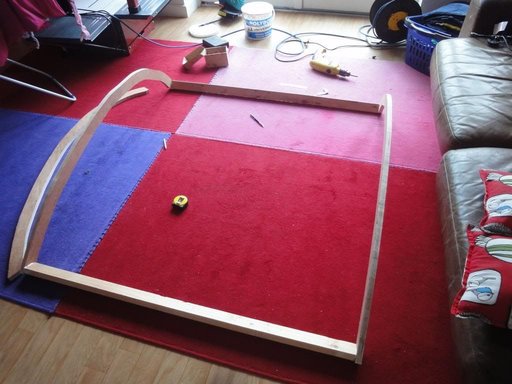

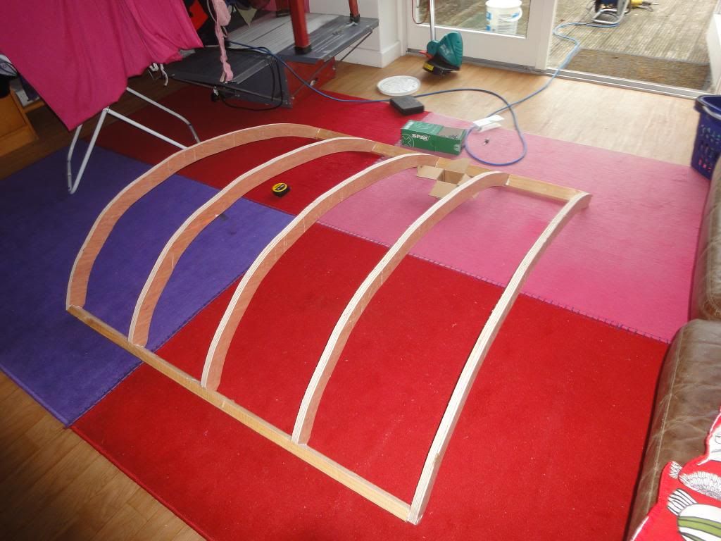

Seeing as i couldn't get much done on the trailer out doors i decided to tackle the hatch indoors.
Then i ran out of the right screws so had to stop :thumbdown:

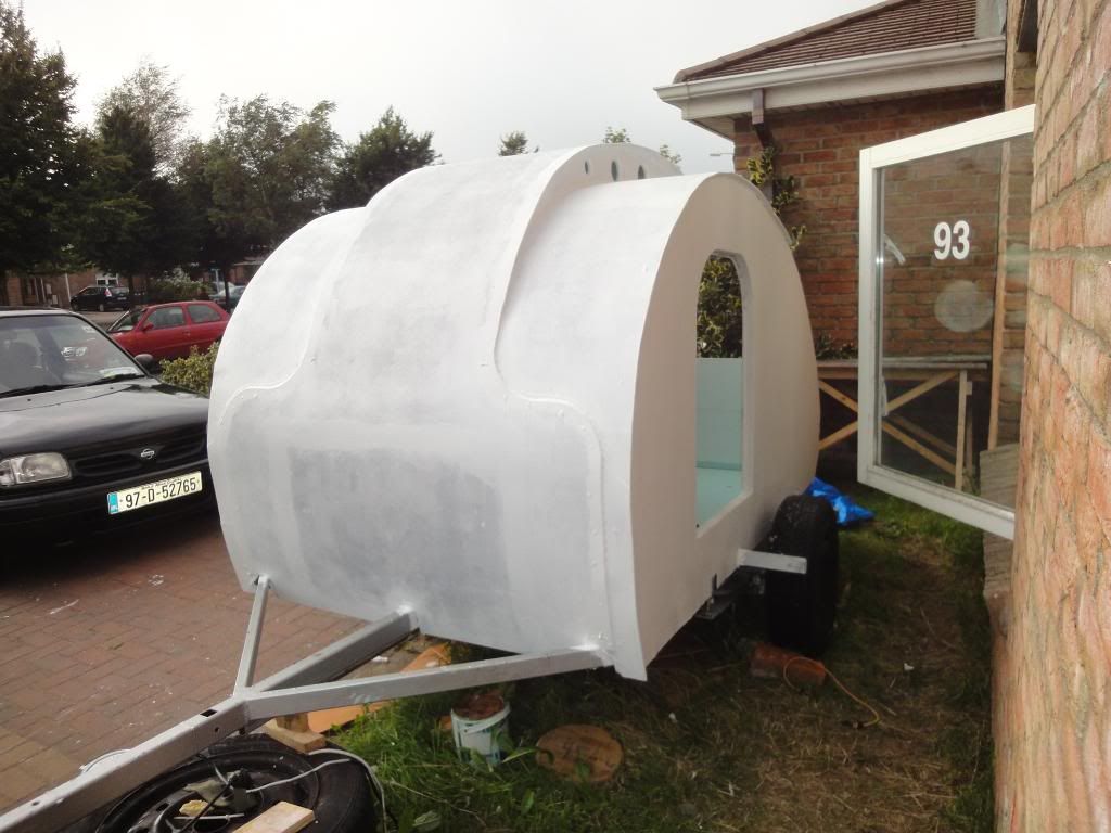

Lot's of bit's done since i last posted.

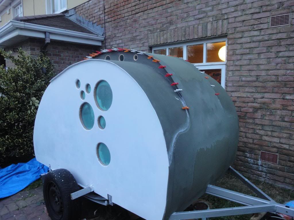

Finally got the fabric on the roof and all coated in 8 layers of PVA.
Then got it all coated in 4 layers of an oil based undercoat.

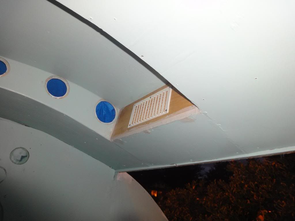

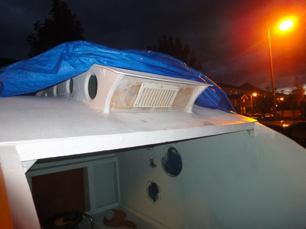

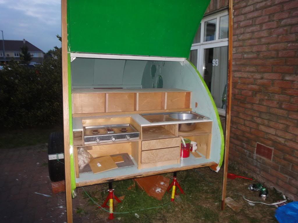

Next job done was the roof vent. So glad to finally get this hole filled in..
Then the inside of the hatch got painted and the outside started...

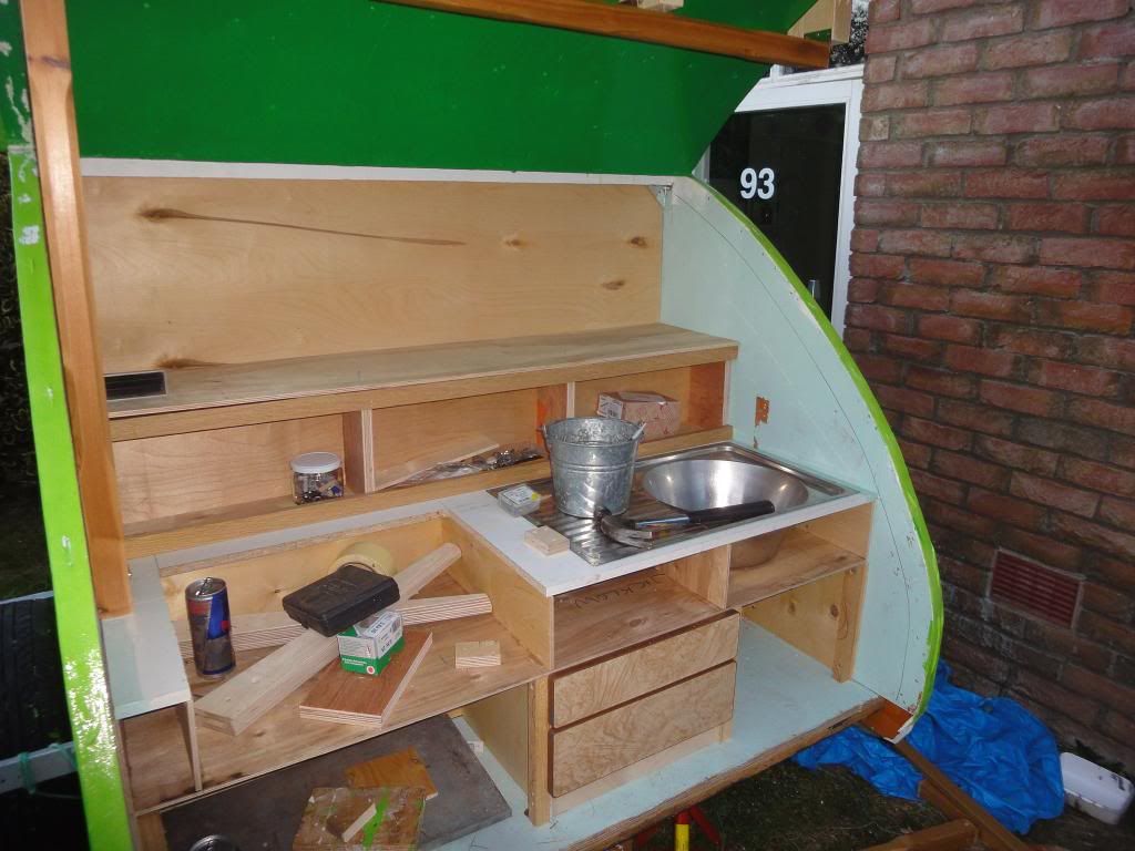

And while all the painting was going on i made a start on the galley..
I was able to reuse a ;ot of the bits from the folding tent galley but there's still lot's more to do. But it's starting to look like the end is in sight 8)

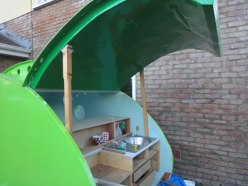

Postby 3nero » Sat Aug 31, 2013 6:26 pm
Ha Ha!! Yeah it's an under 8's standie, all others must kneel :lol:

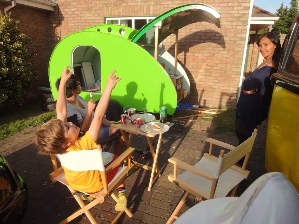

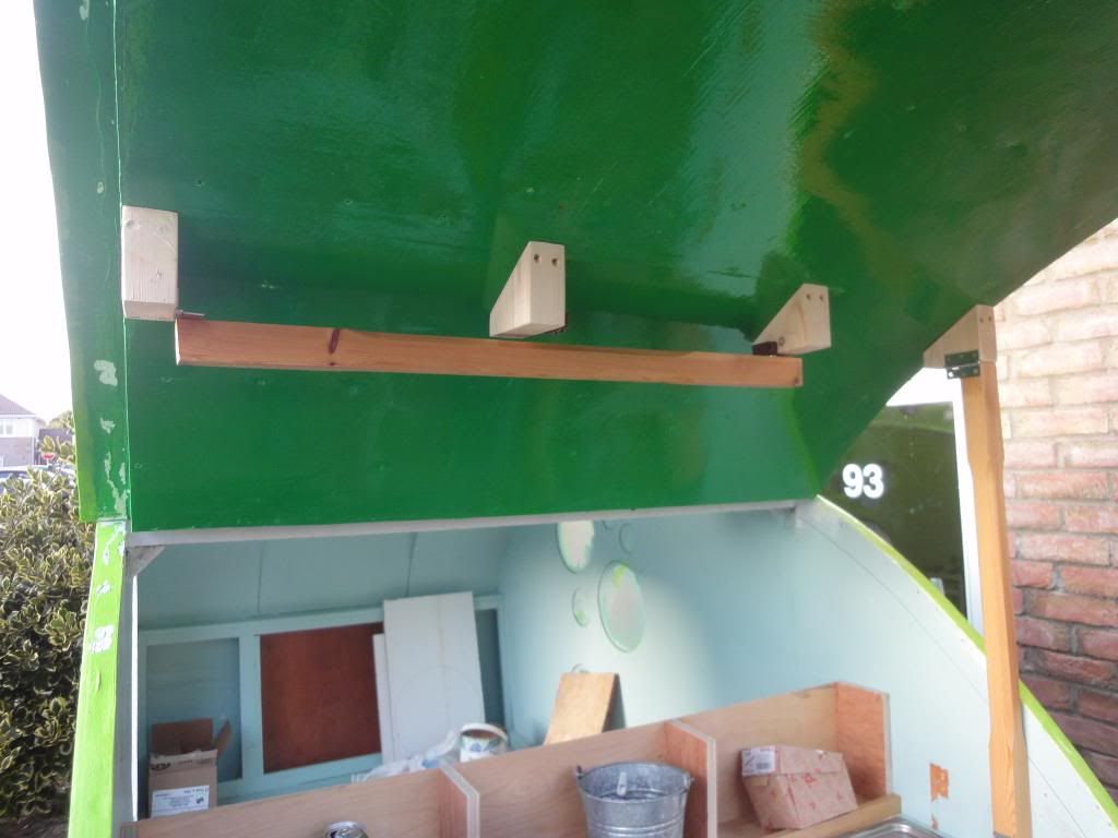

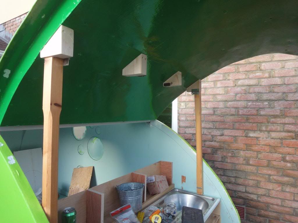

Well i got a few other bits done since the last update but not as much as i had hoped.
We where using 2 sticks to temporarily hold the hatch open and the wind caught the hatch a few days ago. both sticks shattered and the hatch came crashing down. Luckily none of the kids where near it when it went, mainly because i had banned them all from the the area while the hatch was open. The hatch itself suffered some slight damage but i'm sure it's not a hard fix. Due to the mishap the building of the cupboards was instantly put on hold and building of the hatch supports became the number one priority.
several designs where taught up and some where made...
This was one of the rejected designs.
finally after 3 days of playing around with them the supports where given the seal of approval.
Here's what we settled on...
the hinges will be replaced later for some more attractive looking ones and the bases of the uprights will have locks that will attach them to the side walls to stop any lifting caused by the wind. but for now they are doing the job of keeping the hatch up.
I was such a relieve to get have the hatch save that we kind of had a "safe hatch" party slash picnic type of deal 8) :beer:
and then it was back to building cupboards..
Measure once, cut twice....throw away and repeat.
