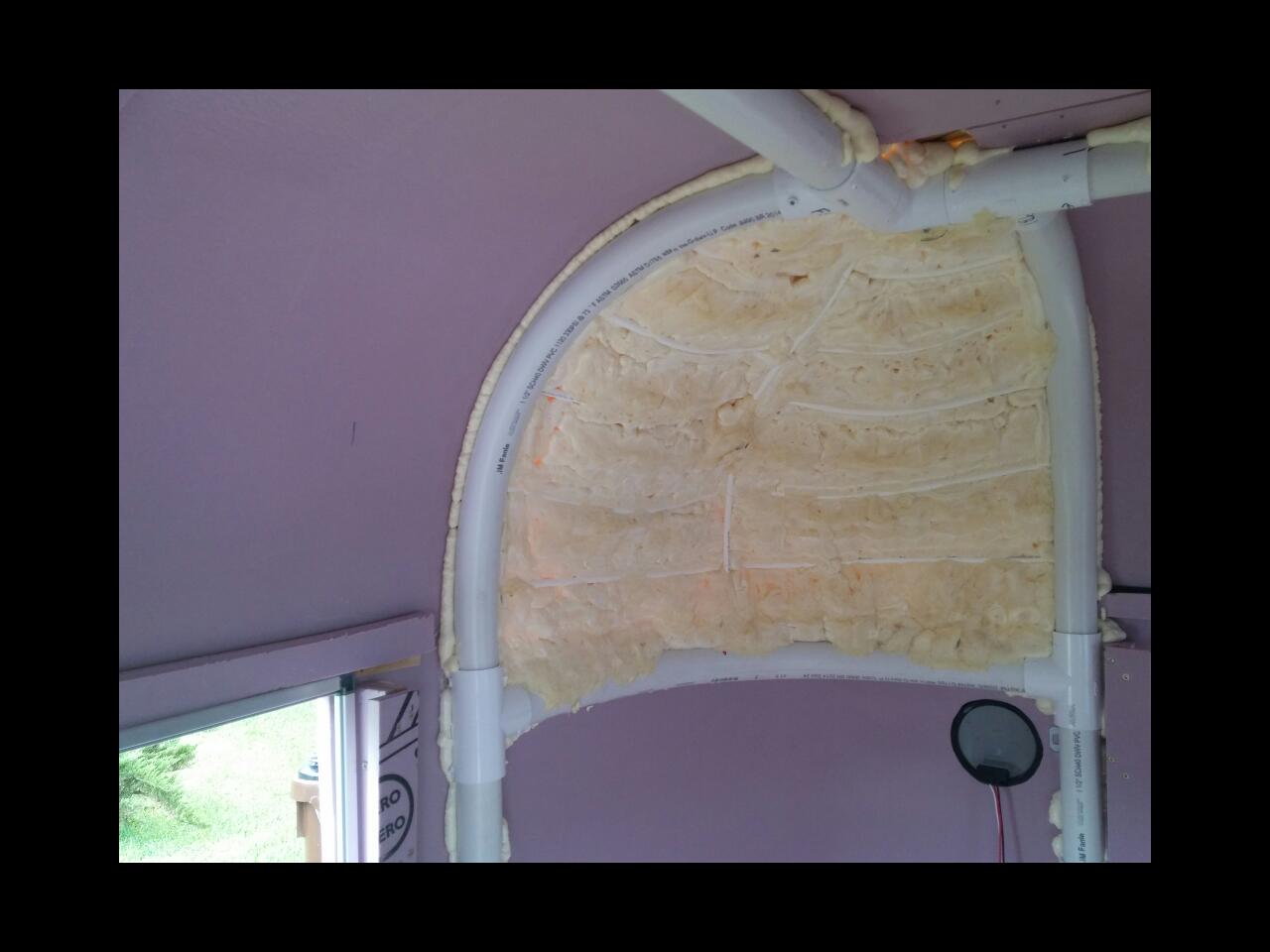

In a fit of frustration I installed the skeleton frame in the remaining 3 corners, duct taped the corner from the inside, and built up spray foam on the outside. I did not take pictures.
I was going to have to hand shape the corners regardless, and by spraying it directly on the trailer, it will encapsulate the corner skeleton, making a stronger unit.

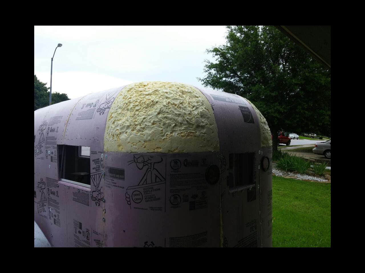

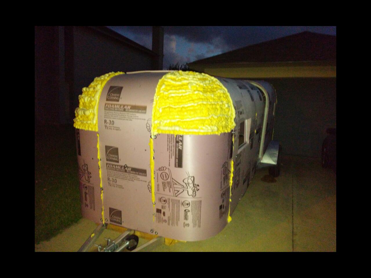

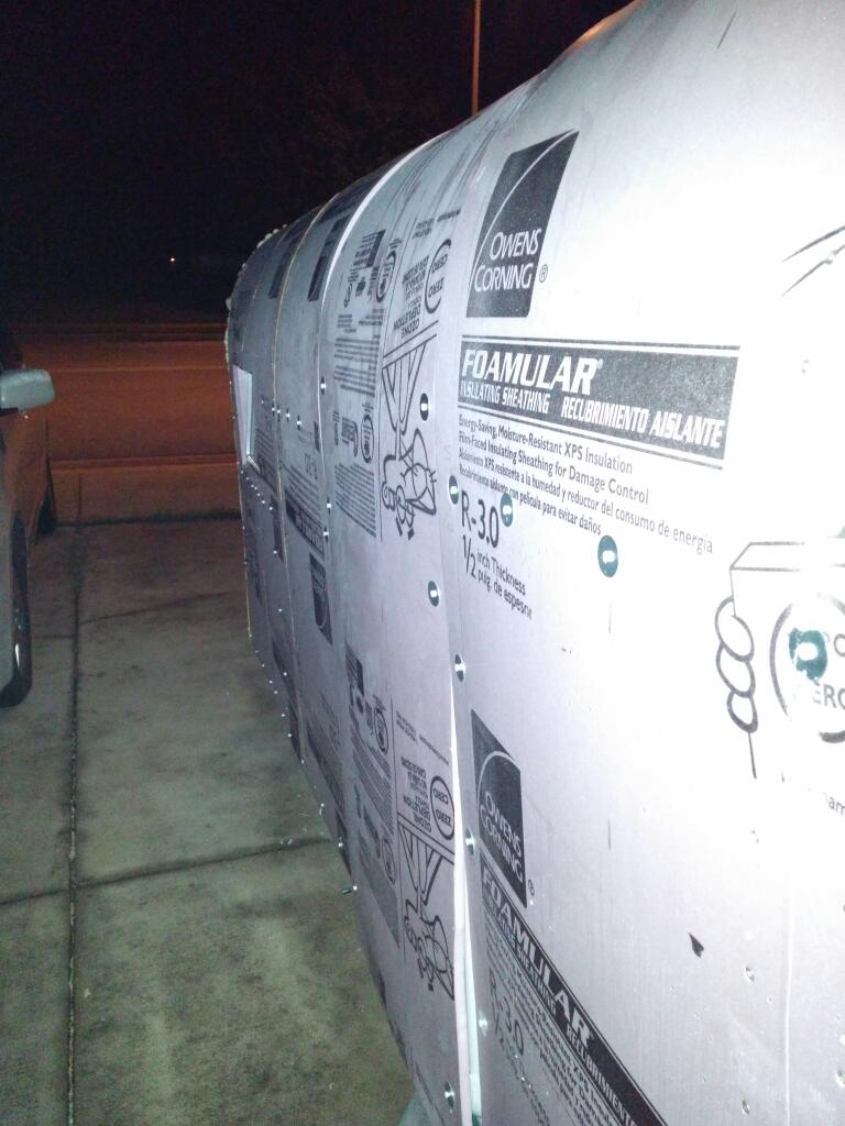

Thanks for the words of encouragement everyone. I am having fun building this thing. Here's a shot of the corners with the spray foam. I still have to build them up a little more. I'll use the cardboard template idea to cut out the high spots and see where I need more filler.

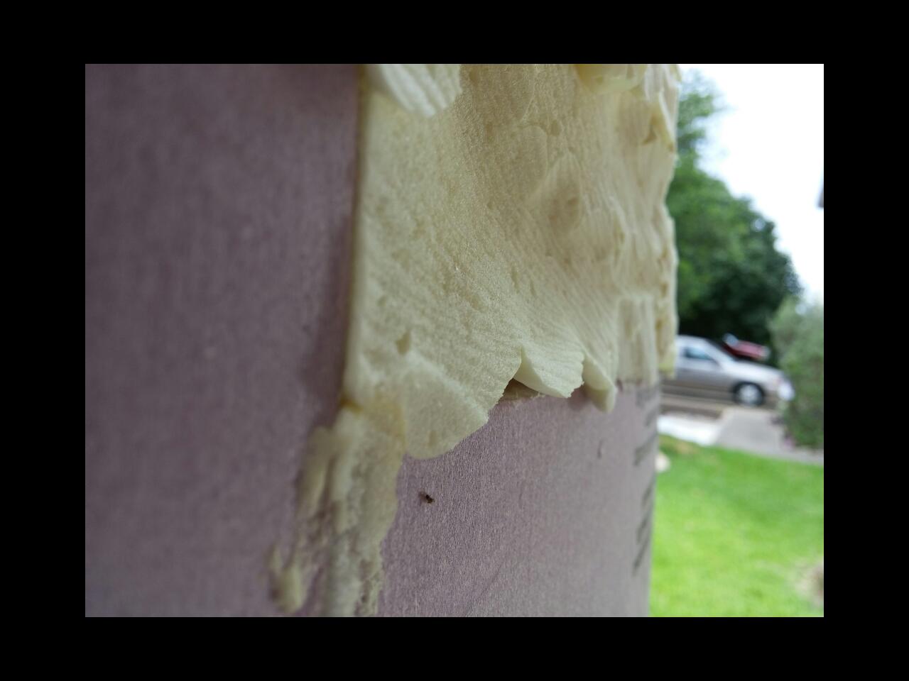

In many of the areas I cut down the high spots with a bread knife. The next day, each head has formed a slightly concave surface. Maybe I didn't let it cure long enough before I cut it?

You should be ok, just need to be a little more patient with this GS spray foam. Usually it takes longer time, sometime few days to fully cure deep inside. I would just keep fairing and then add or cut the foam as needed to the shape until it is completely cured and stabilized. It is important for the foam to cure completely whole depth with access to air moisture, otherwise later it may unexpectadly bulge from inside, but I don thinnk it is hte case here, you are opening the pores by cutting the foam and let more air inside the thickness.

Good progress this weekend!
I did a lot of filling, shaping, and sanding on the corners. Unfortunately, I need to let this stuff cure for several days before I carve it.. A lot of my nice smooth spots were concave the next morning. But the stuff that had sat on there for a couple days prior to shaping stayed nice and flat.

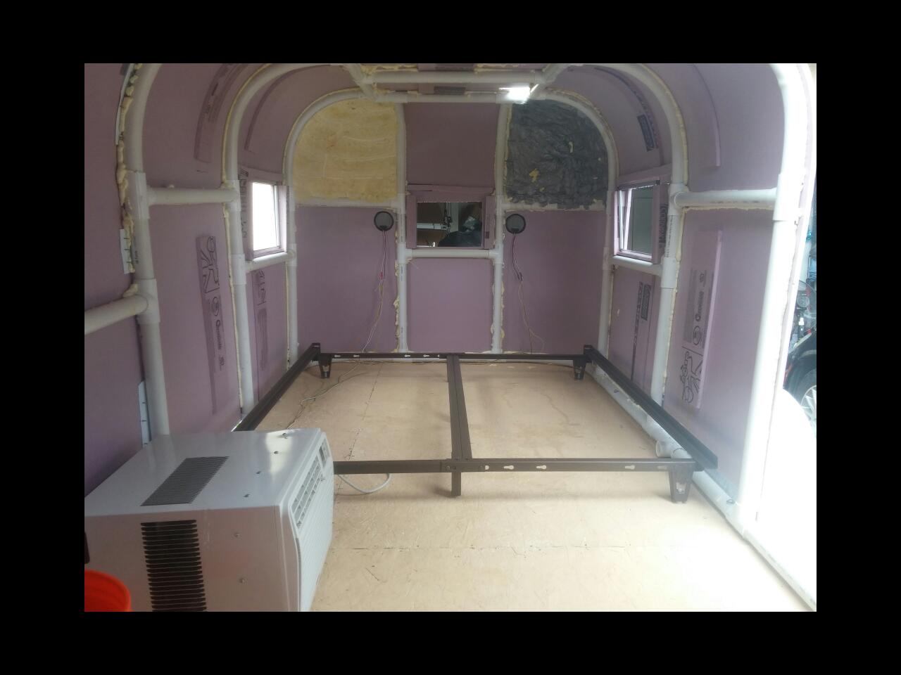

Here is the inside from the front, showing tentative placement of the AC and the bed frame. You can see the duct tape on one corner, the other you can see how the foam wrapped around the corner frame.
