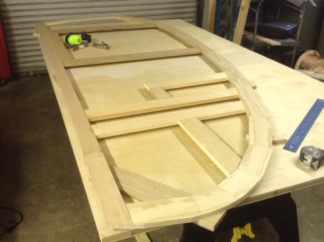

Re: Off-road Teardrop Design/Build
Postby kokomoto » Tue Mar 07, 2017 2:48 pm

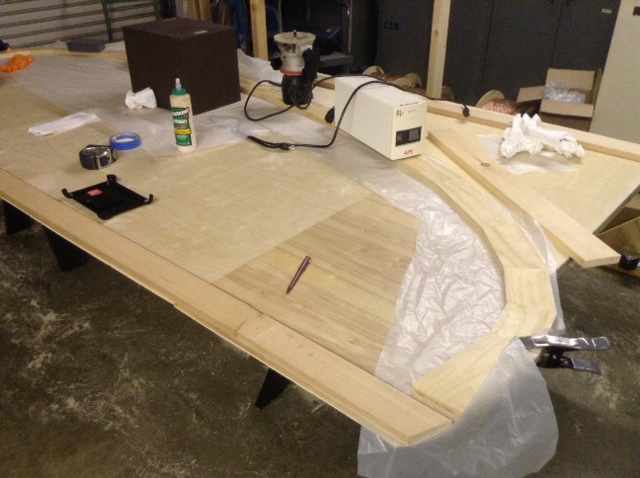

I finally got around to the walls. I'm glad that I bought the biscuit joiner. After the top arch glue joints dry, I'll add the vertical pieces and bottom board.
Wall 1
Wall 2
The other wall

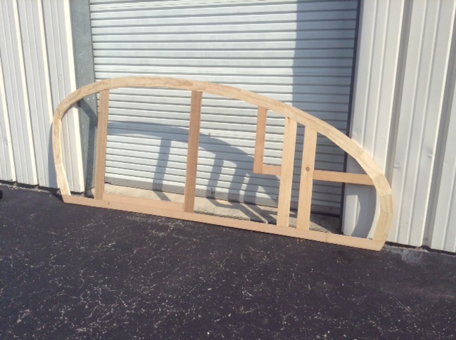

Postby kokomoto » Tue Mar 21, 2017 3:48 pm
Finally finished the skeletons. Now getting all of the pieces together to glue them up with 1/4" plywood.
Skeleton 1
Skeleton 2

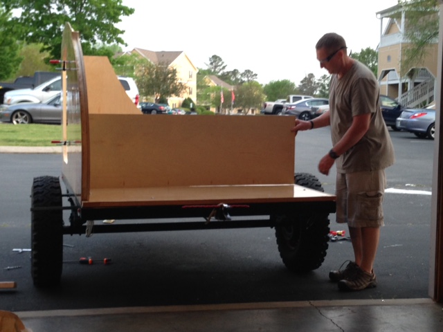

Postby kokomoto » Tue Mar 28, 2017 12:52 pm

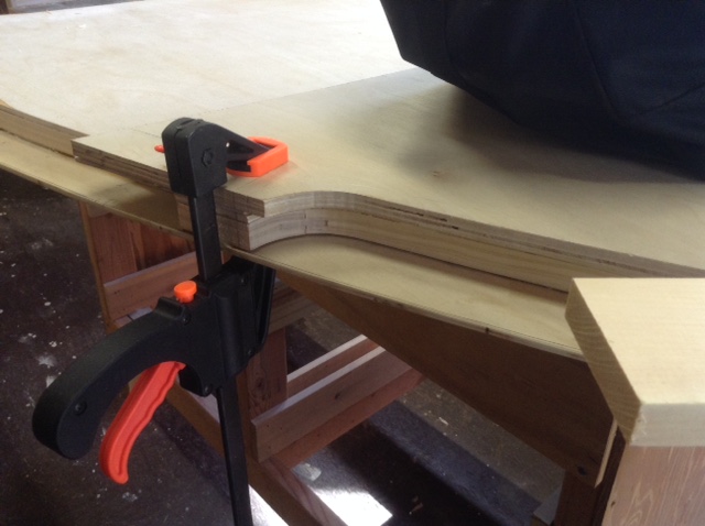

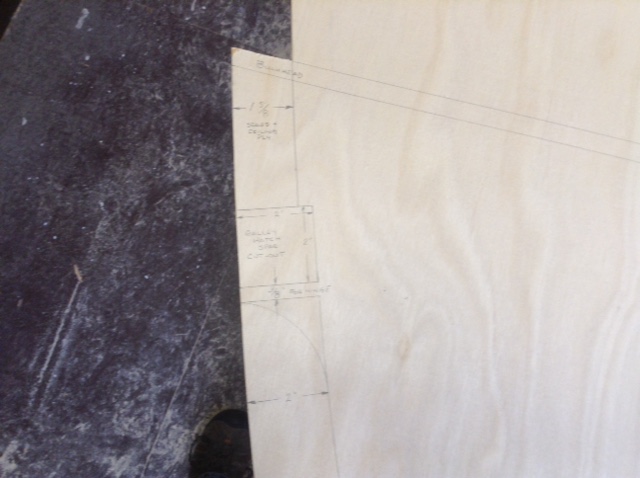

After gluing the skeleton to the inner wall plywood, I cut the 1 5/8" ledge for the spars. I stopped the cut at the forward edge of the upper bulkhead.
Before cutting the rear part of the wall for the galley lid notch, I wanted to confirm that it is 2".
Wall 1
Wall 2
Wall 3

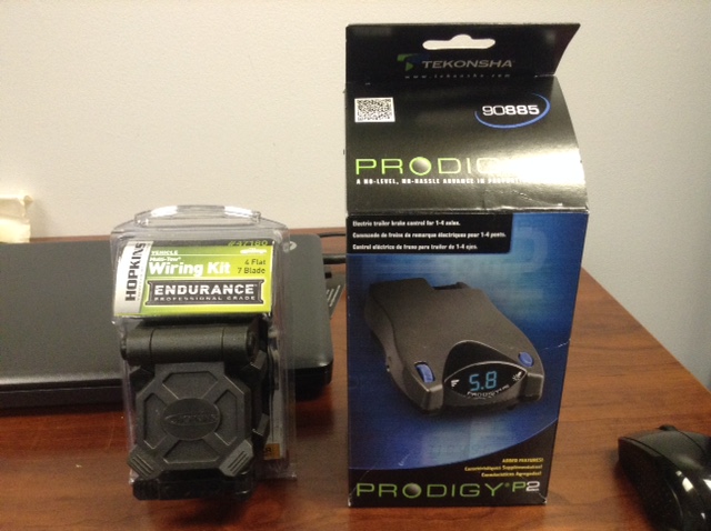

More goodies for the TD.
I bought two of these lighting fixtures. One for the cabin and one for the galley.The two lights can be turned on separately. I plan to replace one of the two with a red led bulb so that we can use red lights when needed instead of the white.
lighting fixture
s-l400 (1).jpg (15.41 KiB) Viewed 2904 times

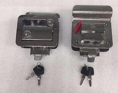

Here are the door locks/latches with deadbolt. Keyed alike.
latches

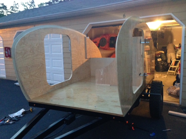

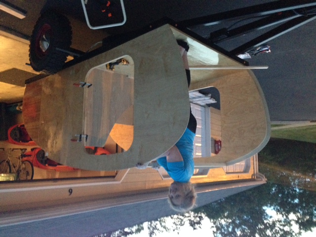

The walls are up!
Postby kokomoto » Fri Apr 14, 2017 9:11 pm

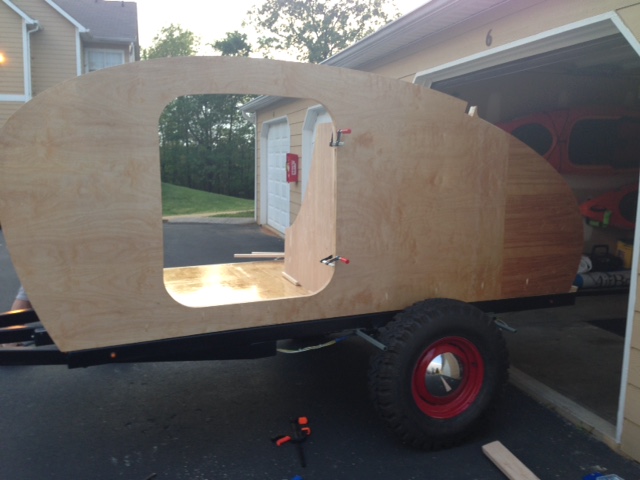

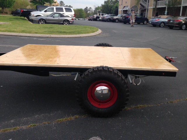

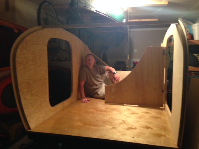

Lots of progress this week. The walls are up as of tonight. PL premium drying while the Kreg screws hold it them in place.
Just waiting on a delivery of 5x5 1/8" birch for the ceiling so that's on hold. Time to start on the doors, and maybe the hatch frame in the meantime.
Floor installed
Port wall up
Port profile

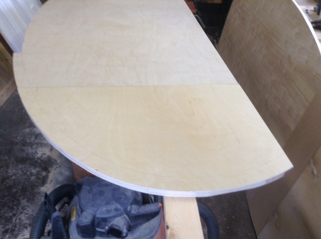

Postby kokomoto » Tue Apr 25, 2017 9:35 pm

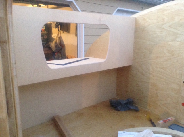

I have installed the door jambs fabricated from1/2" birch ply.

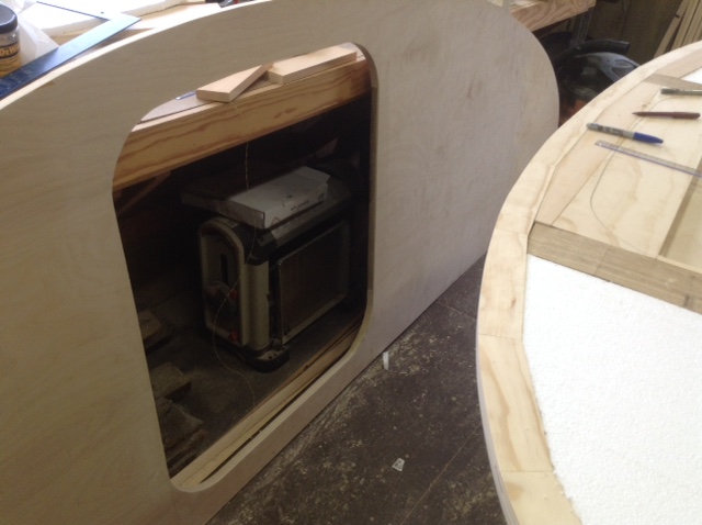

I decided to cut a window in the back wall. Not sure if it's a good idea or not, but I like it for some reason. First ceiling panel is also installed. I'm starting to get to the point where a lot of things have to be done in order. Have to be careful.
Still dreading the hatch and door construction.
First ceiling panel
Rear bulkhead window

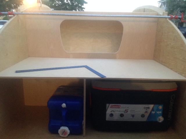

Also picked up a new cooler and water jug to keep in the galley.
Galley so far

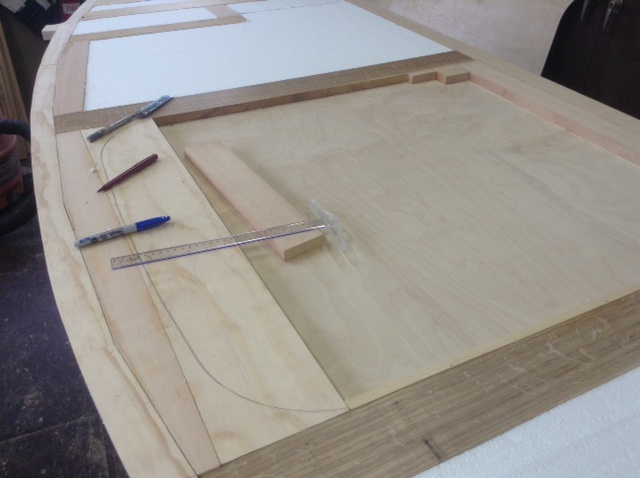

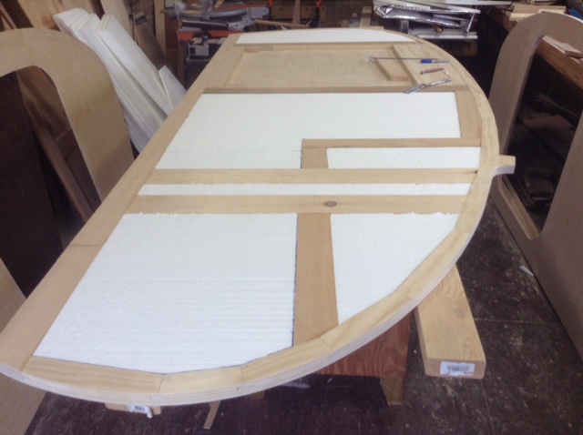

Postby kokomoto » Sat May 06, 2017 4:56 pm

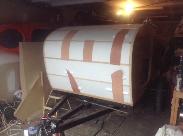

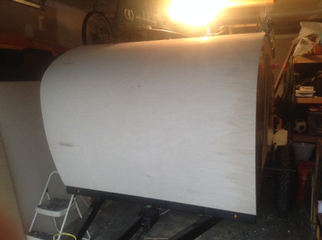

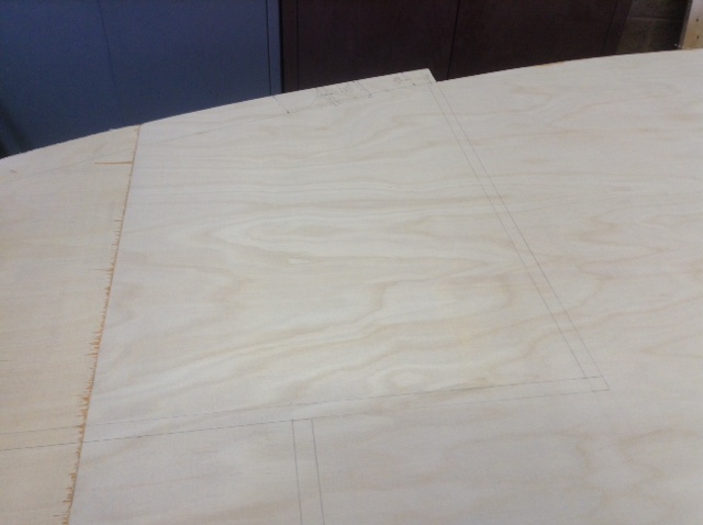

The roof is now half completed.
Roof foam
Outer skin

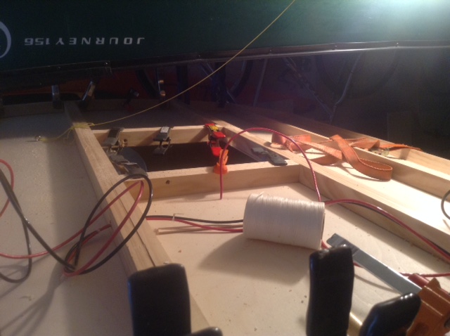

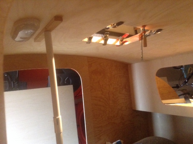

Installed dual LED light fixture in the cabin.
Cabin ceiling
Also cut the hole in the ceiling for the Fantastic fan.
Fan hole
