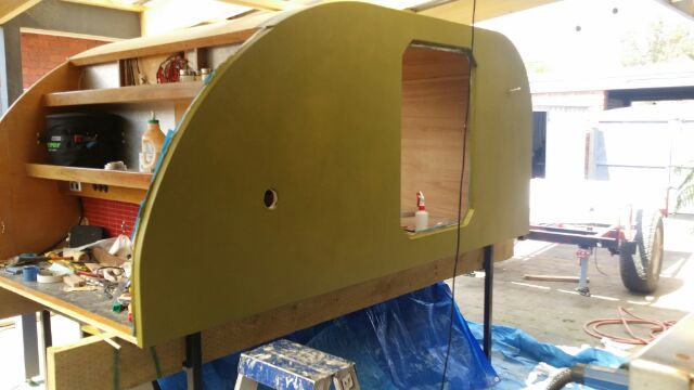

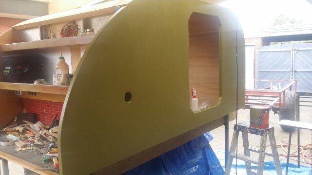

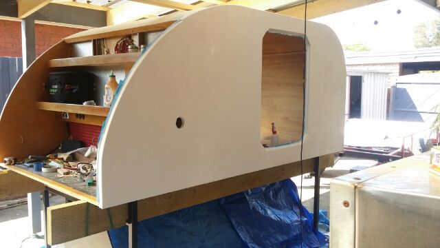

First coat of zinther superprime on today.
Hope to get 3 coats of topcoat on today and the canvas on the other side.

Postby dales133 » Sat Oct 10, 2015 11:06 pm

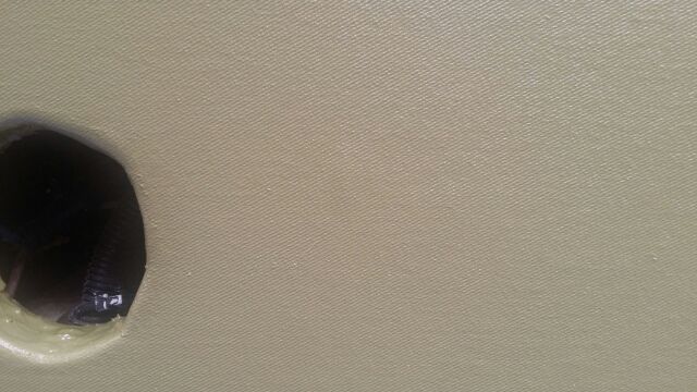

Just got a second coat of top coat on and i gotta say im impressed.
I expected a blemish or two and there are verry minor ones but on the wbole its 10 times better than the hatch witch i was already happy with.
Ill get some pics soon

Postby dales133 » Sun Oct 11, 2015 1:40 am

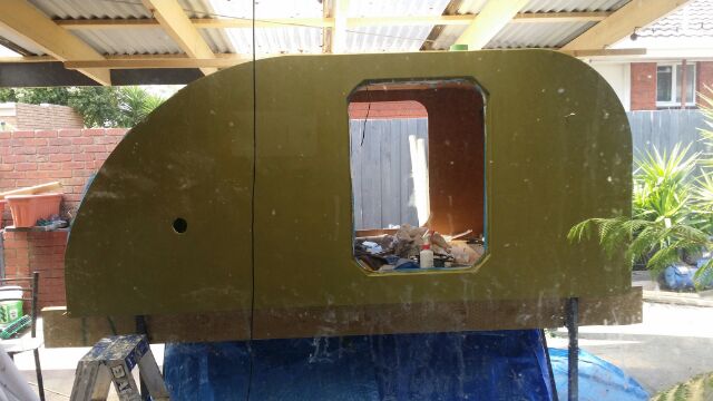

And done!
Didnt get the second side canvased but got one side completed so im happy.
Finish looks good.

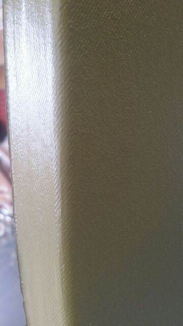

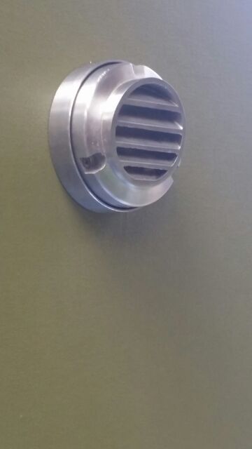

Postby dales133 » Sun Oct 11, 2015 8:58 pm
Cheers kc and sharon.

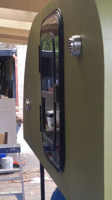

Couple more pics.

Postby dales133 » Sun Oct 11, 2015 8:59 pm
Its a realy interesting colour and changes alot in different lighting conditions
