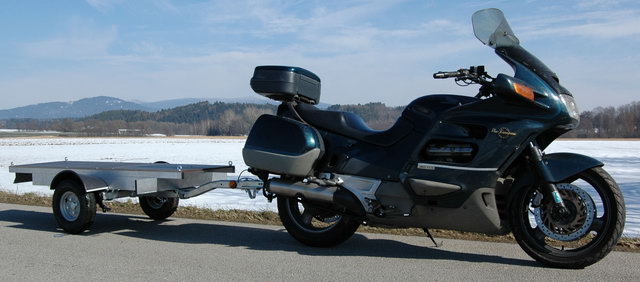

Postby ST1100 » Sat Mar 02, 2013 12:12 pm
Here the first picture after the first ride.
I do not see the trailer in the mirrors and I do not feel the 60 kg while driving.
PERFECT !

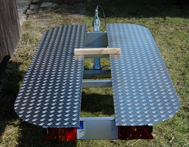

24: Stainless Steel Micro-Airstream behind motorcycle
Postby ST1100 » Sun Mar 03, 2013 1:22 pm
Okay - removed the plywood that was only to get my title and made a pattern to cut the aluminum sheet, that will build my full size deck.

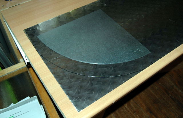

25: Stainless Steel Micro-Airstream behind motorcycle
Postby ST1100 » Sun Mar 03, 2013 1:23 pm
Then cut the corners with a jigsaw and made a fitting test.

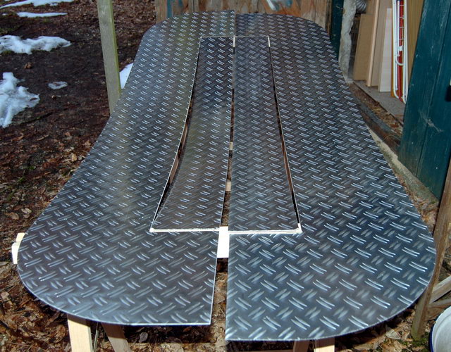

Postby ST1100 » Sun Mar 03, 2013 2:27 pm
Last step for today, cut from every sheet a stripe 140 x 14.3 cm that I will rivet at the outside of the middle section of my frame to make it stronger.
Into that two stripes I will drill the holes for the rivets within the next days
The hole in the middle of the deck will be closed by two doors, one for a baggage compartment for cloth, the other for a step in box for my feet, when I'm sitting inside the trailer.

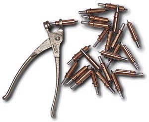

Re: Stainless Steel Micro-Airstream behind motorcycle
Postby ST1100 » Mon Mar 04, 2013 8:10 am
Ordered a set of 24 clecos with pliers at aircraft spruce and the first sheet of stainless steel plus 24 meters of aluminum tubing at my local steel dealer.
Postby RandyG » Mon Mar 04, 2013 5:01 pm
Oooo clecos, invaluable tool! One thing about that diamond plate with rivets, getting your rivets to sit flush with the ridges is a pain in the... You can either plan ahead and place all your rivets, or bolts, in between the ridges or shave the ridges down. If it were me I would drill between them. I'm sure you may have thought of that but just some advice doesn't hurt. Lookin' good so far and good luck!

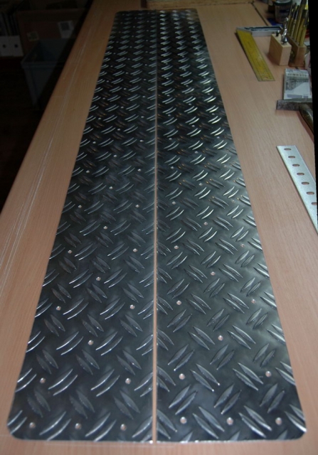

Postby ST1100 » Tue Mar 05, 2013 5:16 pm
Today I drilled 94 holes into my support sheets, that I will rivet on the outside of my frame to make it more solid.
Deburring both sides makes 188 times !
