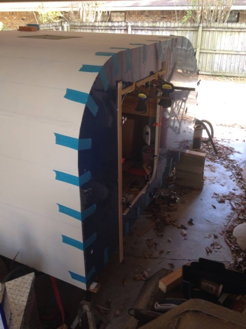

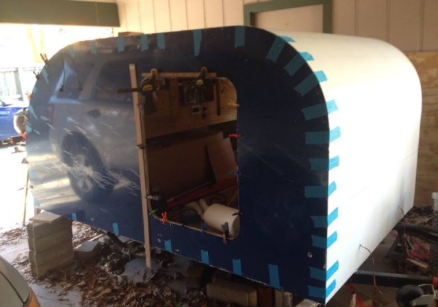

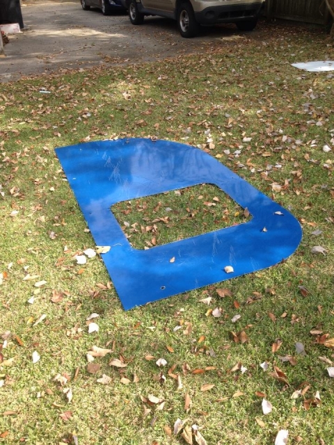

Decided to get the painted aluminum sheets instead of painting the side walls. This will save me a ton of work.
Trimming the edges of the roof flush with the walls
Profile traced onto the back side of the aluminum.
Passenger side wall cut.

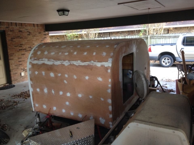

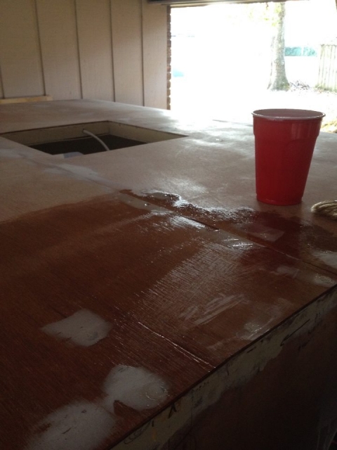

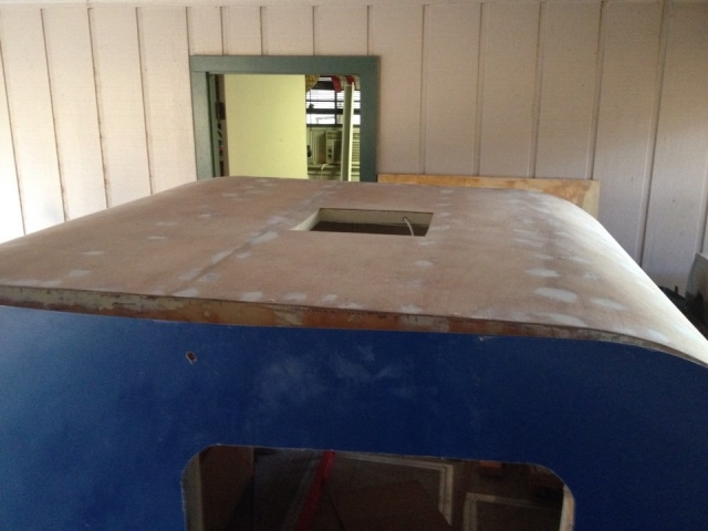

Filler applied to the screw holes
Sanding the filler smooth
Applying a couple coats of CPES to the roof and the wall/roof seams

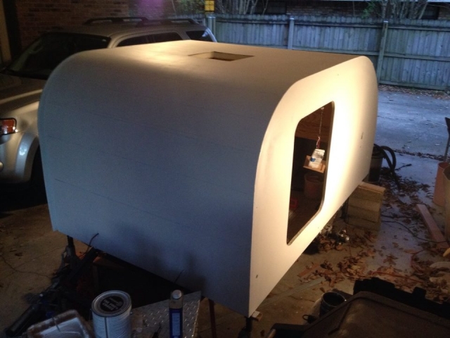

Applied 2 coats of Zinsser Oil-Based Primer to help moisture proof the plywood roof and walls before applying the aluminum to the walls and roof.

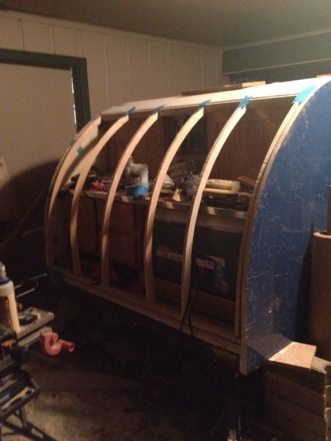

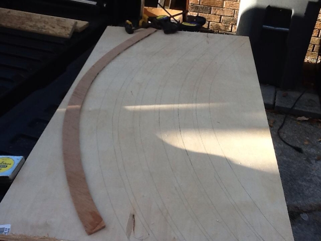

Prepared a template for the ribs of my hatch from a scrap piece of luan. The ribs will be made from 3/4" birch plywood. i will rough cut them with a jigsaw then use the router to match the template and then clamp them together and use a belt sander to even them out.

Galley Hatch ribs cut and taped in place to get an idea of what it will look like.

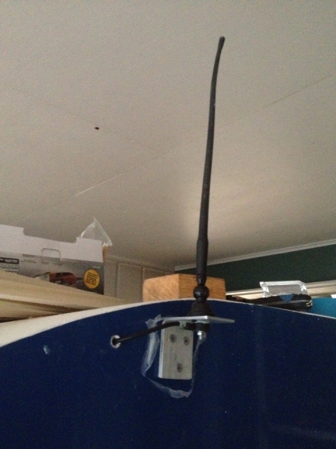

Made a mount for the radio antenna

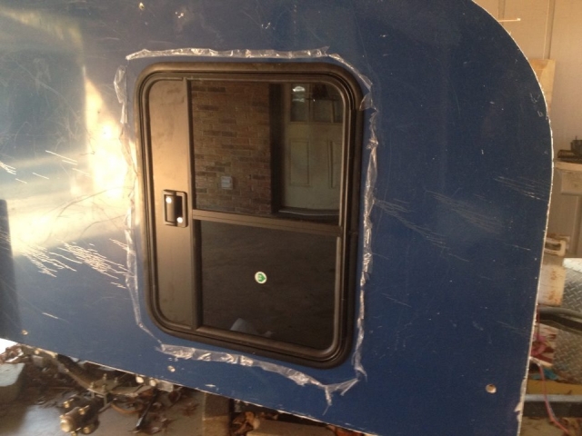

Installed the doors.

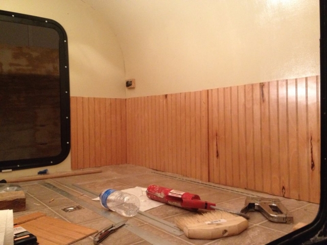

Panelling going in.
