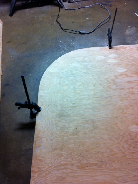

continuing work on the walls. To improve the sidewall curves, and better assure both sidewalls have the same curve, i laid the two walls on top of each other, clamped them and sanded them.
It is still not an exact perfect curve but is much, much better than after my first cut/sand.

KC thanks for advice on both of these things!
