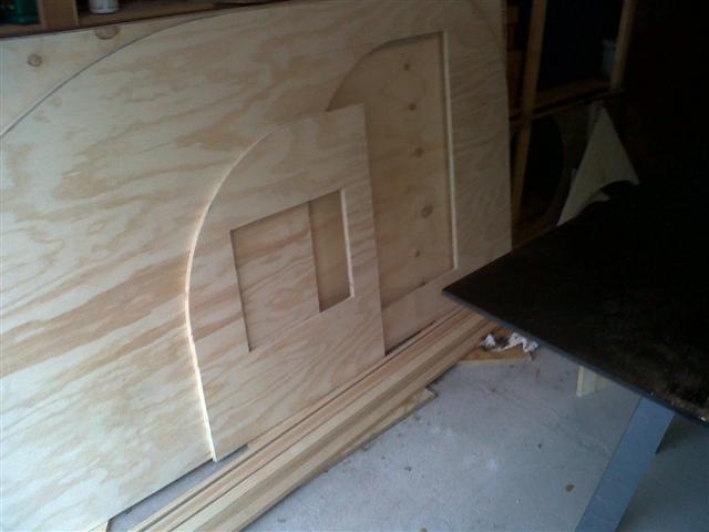

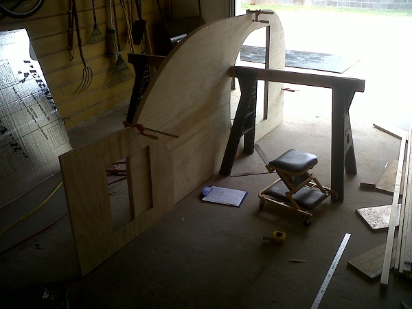

I got about three hours work done today between taking breaks from the extreme heat. I got the second side cut out and sanded the cuts on both sides and doors. I spent $22.50 for 5 2x4x8's and a box if 2 1/2" screws.
I got treated 2x4's for the sub floor and marked it for cutting rabbet joints at another shop in the morning.
While the walls were clamped for sanding I marked the spar locations. I also marked out a simple cabinet design for later.

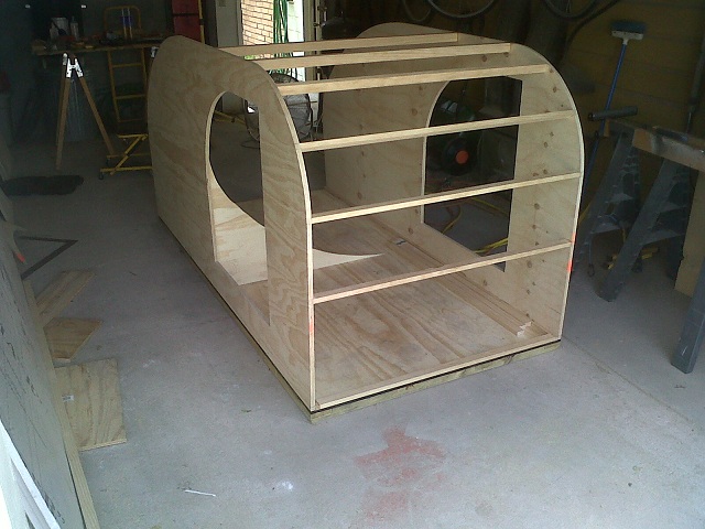

A partly cloudy day and I was off work! I spent about six hours working today. I built the sub floor, and attached the ply floor. I fastened the sides to the floor and installed all the spars ahead of the interior cabinet. It's starting to look like a camper!
An interesting side note; I'm the third or forth generation to use some of the hand tools involved in this project. The large square on the left side of the pic was my grandfather's.

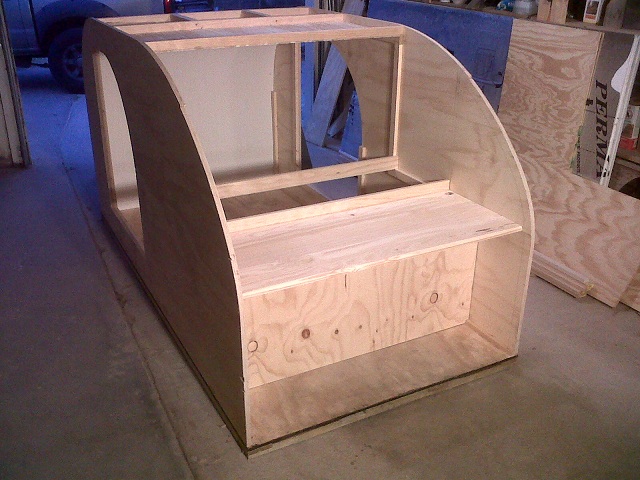

Postby DesertSkies » Sat Jun 19, 2010 10:16 pm
Six more hours down. I've spent a lot of time changing the cabinets around but finally settled on the final design. Part of it is dry fitted in place in the picture. I went with a larger counter top which made the upper cabinet space pretty tight and the lower cabinets were made smaller as well to allow enough rack space for me (6'4").
If I could do anything differently I would have framed, insulated and paneled the walls before standing them. Also, would have made the hatch cutout when I cut the walls. I did it with a router and had several blowouts. No big deal since I'll be painting the exterior.
I framed all of the walls except for the radiused pieces. I'll be doing them tomorrow. I'm hoping to have the walls insulated and paneled tomorrow.

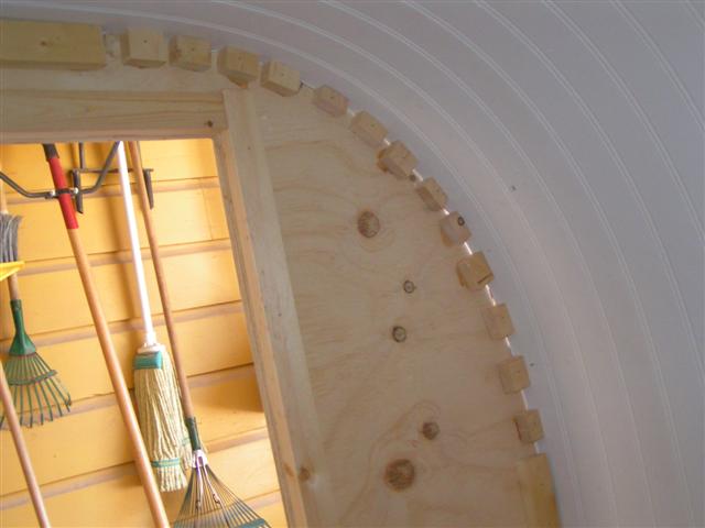

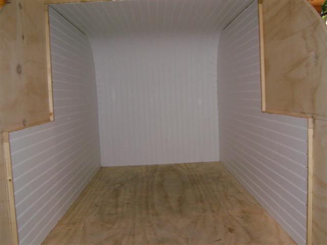

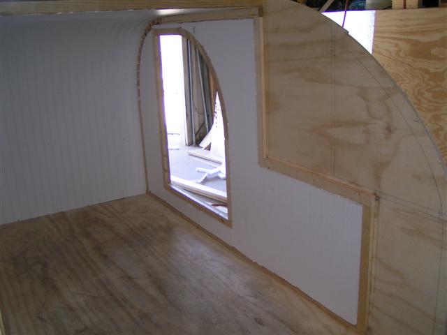

In about four hours work today I managed to finish the wall framing, insulation and paneling.

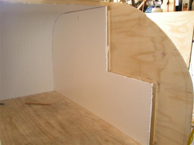

I fitted a sheet of foam and used it as a template to cut the paneling. It worked pretty well. I cheated on the forward radius by using small blocks as nailers to avoid the extra work of fitting another curve that will just be hidden anyway.
The one thing I forgot was to pre-wire the porch lights! I hope to correct that mistake without too much trouble. I'll be able to drill throught he header into the wall and wire the light and switch.
Interior trim, Cabinets, wiring and roof insulation are slated for tomorrow.
Totals to date: 24 hours, $440.47
Here's the nailer cheat!
Foam teplate.
Wall foam in place
Here's the wall paneling. The doors will be cut out with a router tomorrow.
