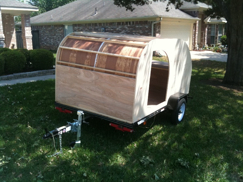

Postby TotalChaos » Sat Sep 17, 2011 2:29 pm

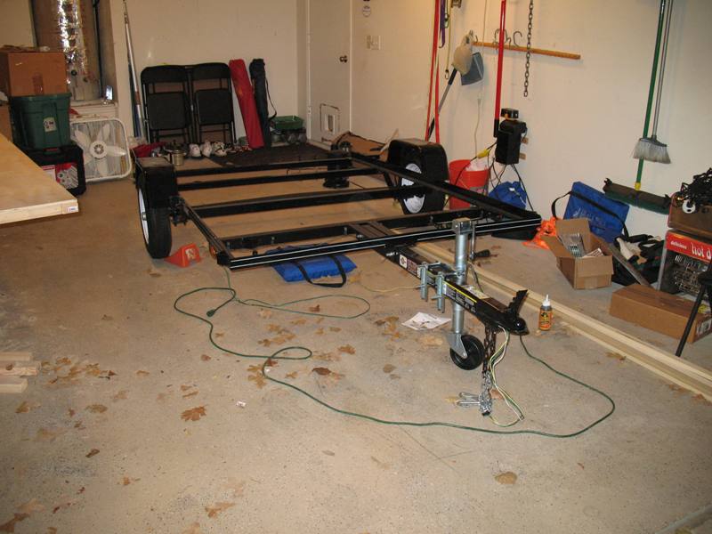

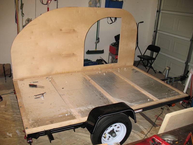

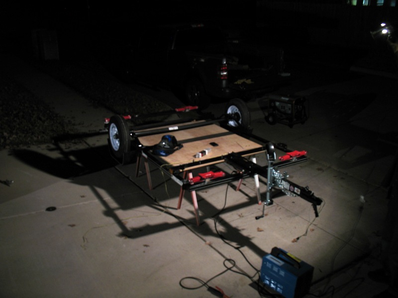

This is the trailer frame I bought from Northern Tool

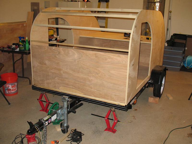

My brother helped me by welding on jacks to stabilize the trailer

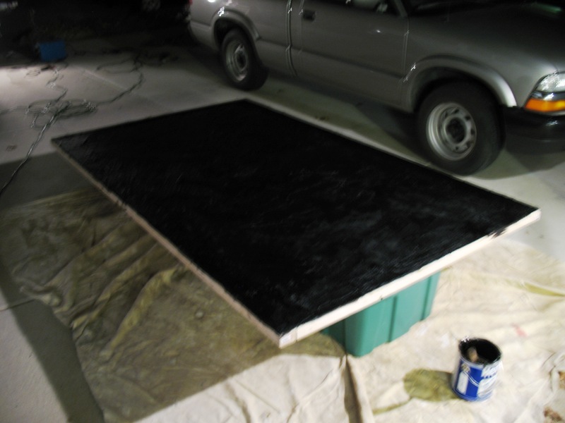

Tar is the worst to work with!

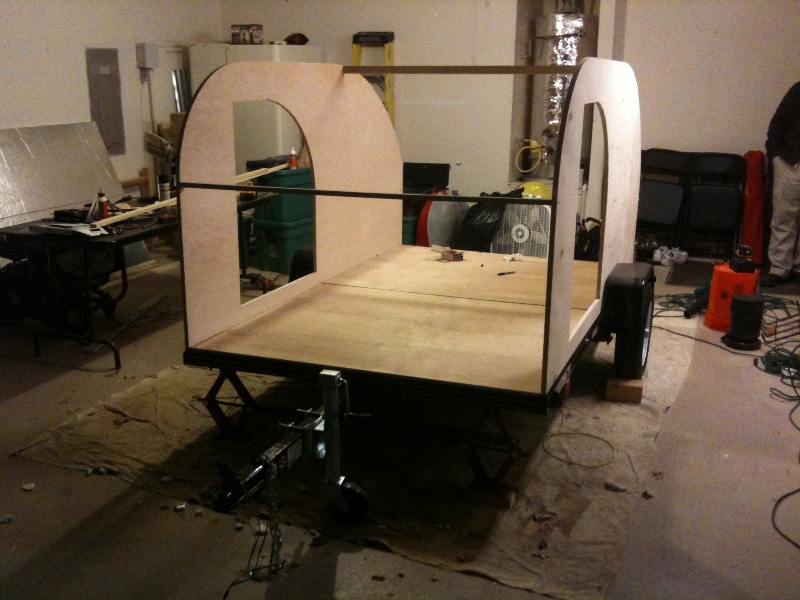

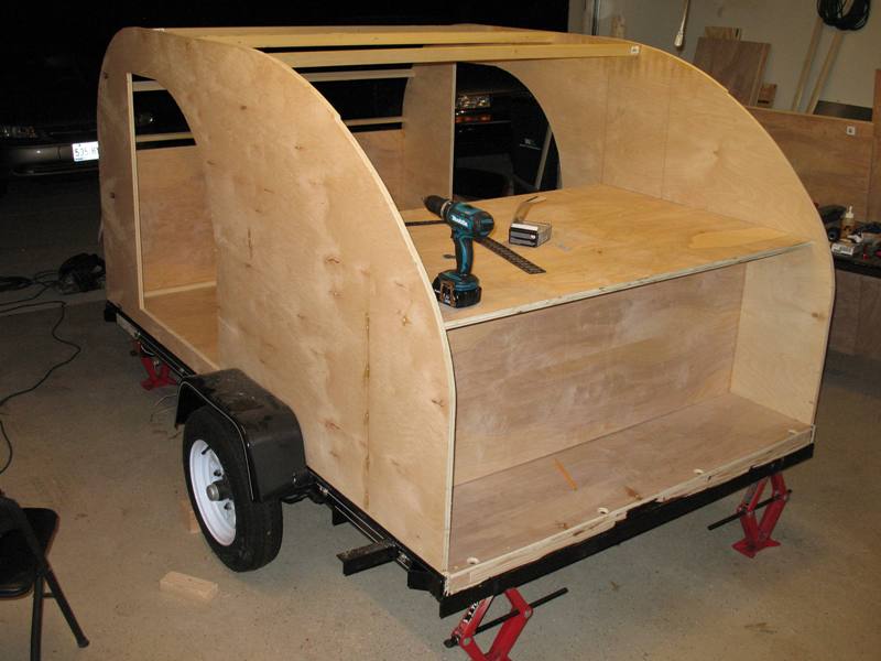

Subfloor and first wall bolted down
Starting to take form refuled my motivation

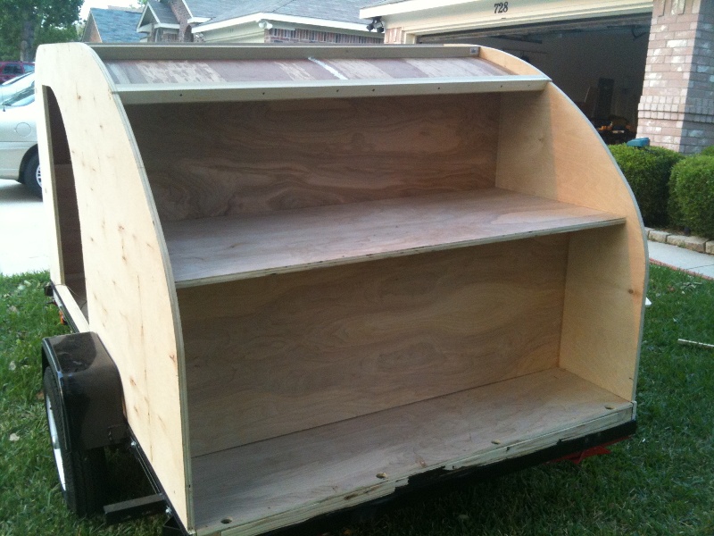

Bottom of galley and counter installed

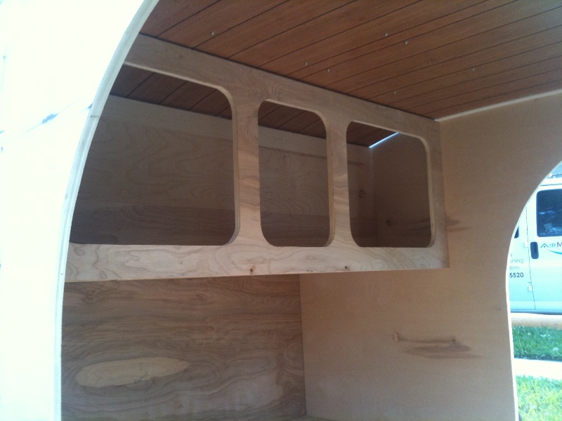

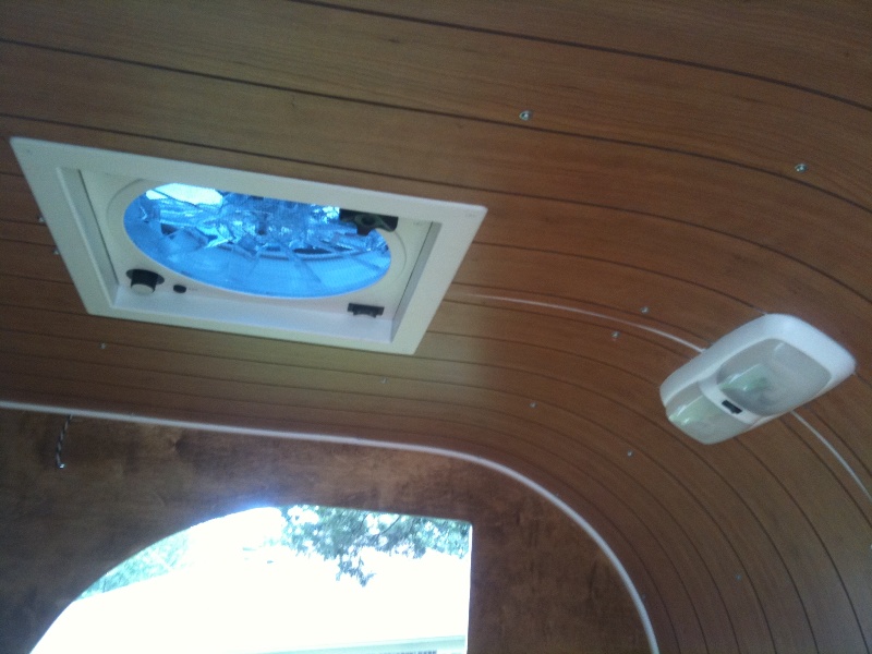

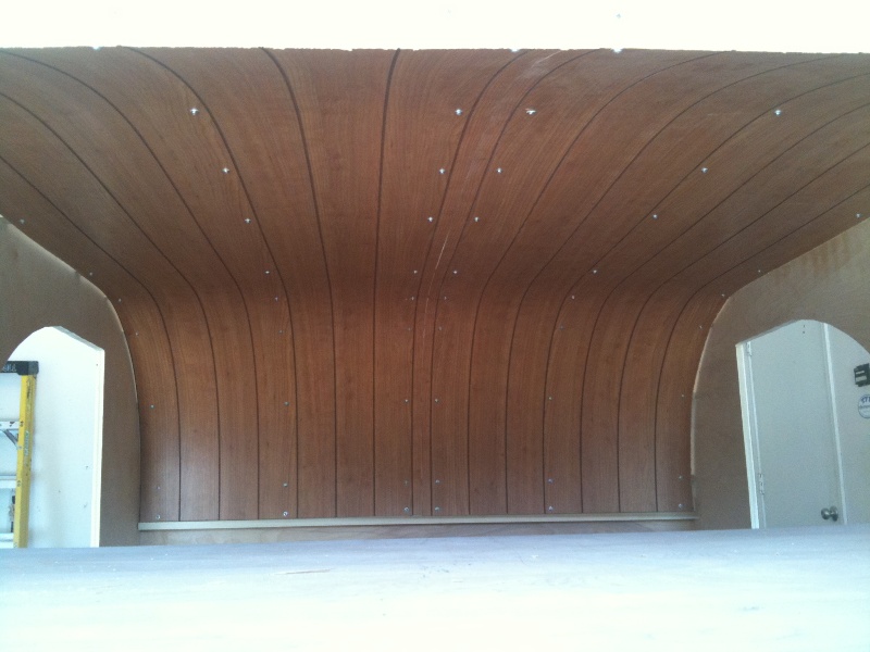

Ceiling liner installed used decorative panneling for ceiling bent easily after making a stop on head board for it to seat into
Interior cabinet face installed

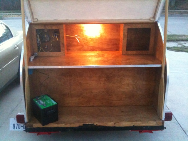

Back view of galley without cabinets

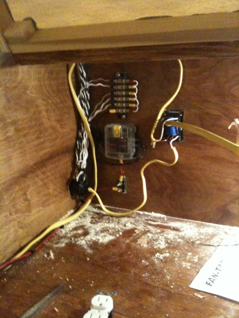

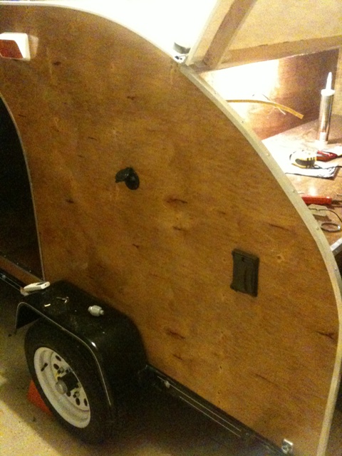

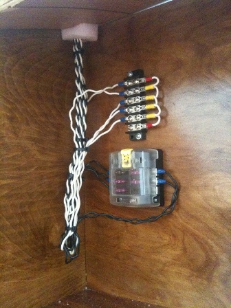

Wired 12 volt and ran back to galley

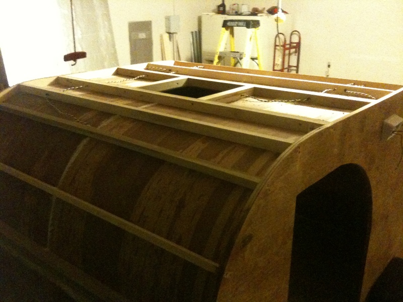

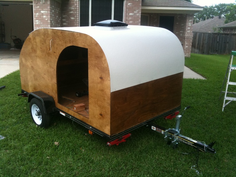

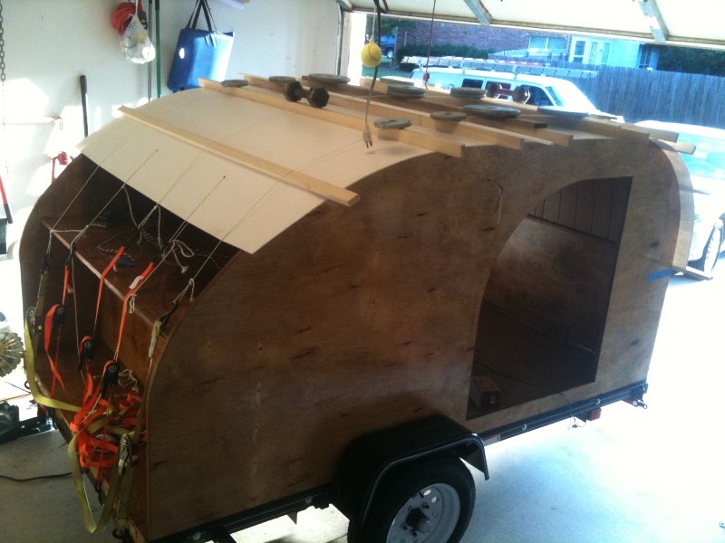

Roof being glued down should be waterproof and duable its refrigerated semi trailer liner! Thanks to my friend Mark for the hook up!
Progress so far gives me a third wind of motivation
All 12 volt lights and fan are installed

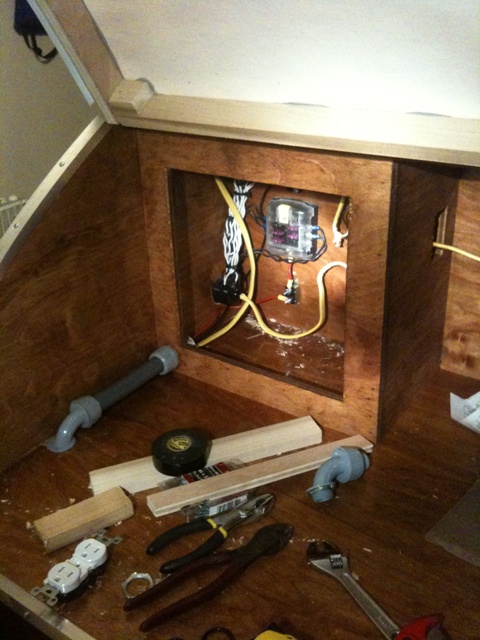

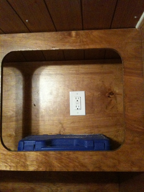

110 volt installed next to 12 volt utilities done
Utility cabinet installed plan to make a bulkhead for cabinet and secure it with brackets and velcro so I can used 5 of the 8 inches for additional storage

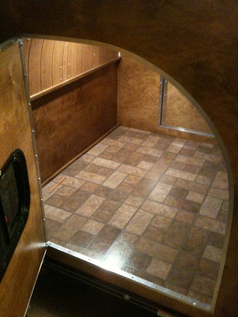

Wife installed floor looks good

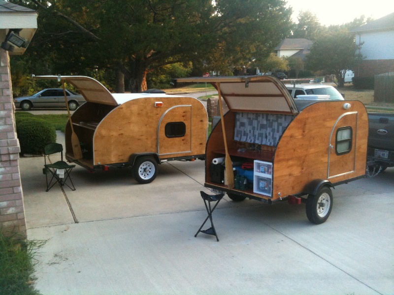

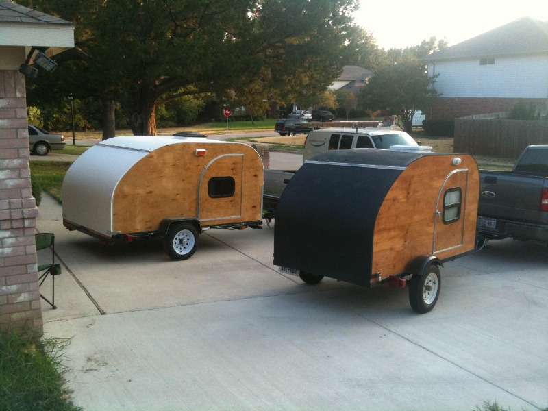

Sister ships Mark's T.E.A.R. (Totally Experimental Adventure Rig) and my yet to be named tear (both first time builds and done concurently)

The both look great! Did either of you install insulation?
I have an experiment for you and your friend to try, which will work great since you have identical tears, with entirely opposite roof colors.
Stick a couple thermometers inside your tears one day when you are camping together. I'm very curious to see how much difference the inside temperature is due to the roof colors. One would think that your white roof teardrop would be slightly cooler, but I'm still curious.

Both trailers are insulated at the roof and floor. The difference is that my trailer has a white roof 3/4" walls and has a galley in the back. Mark's trailer had a black roof 1/2" walls and his galley is accessible from the cabin. Well have to test the temps while camping. I'll post the results also I am working on adding a ducted air conditioner this winter. I originally built this to be able to camp during the hot Texas summers.
