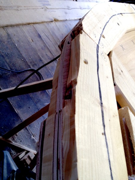

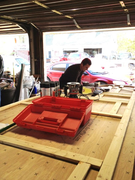

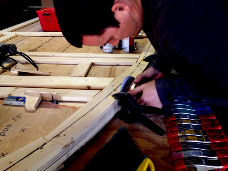

This was my husband's attempt at routing :frightened: ... needless to say I'm in charge of all the routing from here-on-out!

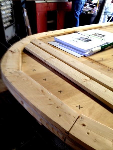

Here we're matching the boards up so I can cut out the spars from the profile.

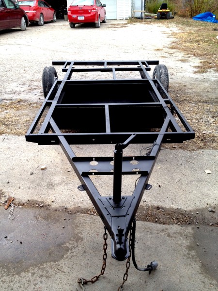

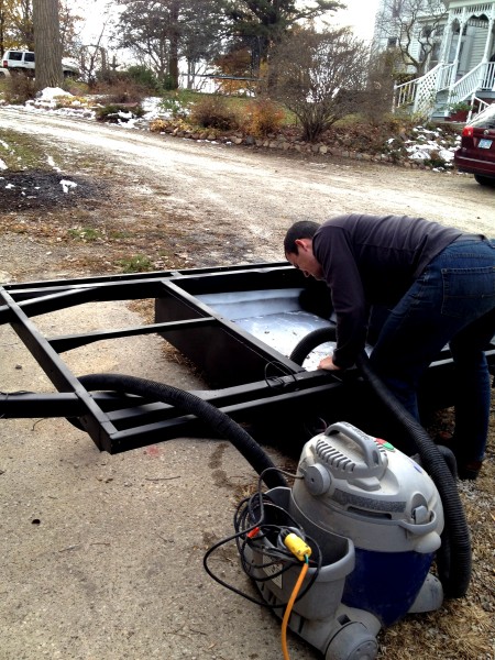

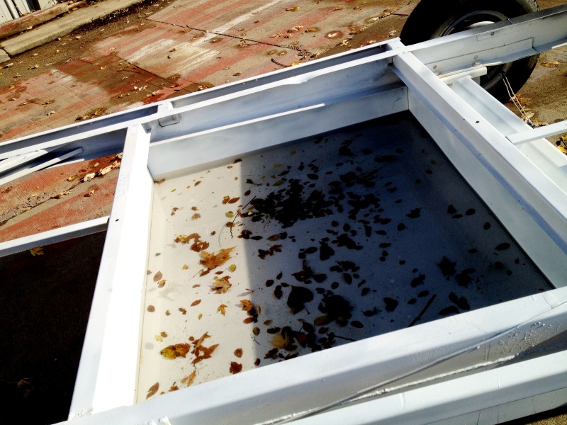

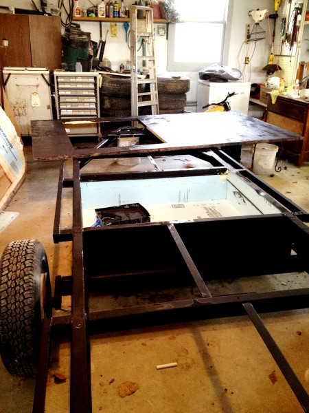

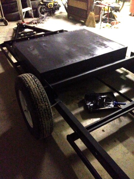

Our foot-well! :FNP Filled with water :o It took us FO-R-E-VER to get to this point in our build. Finding a welder that wouldn't charge us an arm and a leg and that didn't flake-out on us was so difficult! That frame was previously a pop-up camper frame that a friend donated to our build. I had to tear a bunch of it apart, then cut some of the side pieces off with a steel blade in the circular saw. (It left me thankful that no one was watching me...I think I could have easily sliced several appendages off!! :shock: ) We then had a welder move the bumper and add the foot box. Then the whole thing was sandblasted, primed and...
Enter: Rustoleum. Lots of rustoleum. And lots of other weather-preventative compounds!
Here it is partially painted, and getting cleaned up.
Ta-Daa! The finished frame. We were so excited to get to this point... but so much left to do!

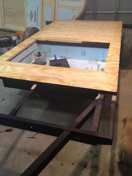

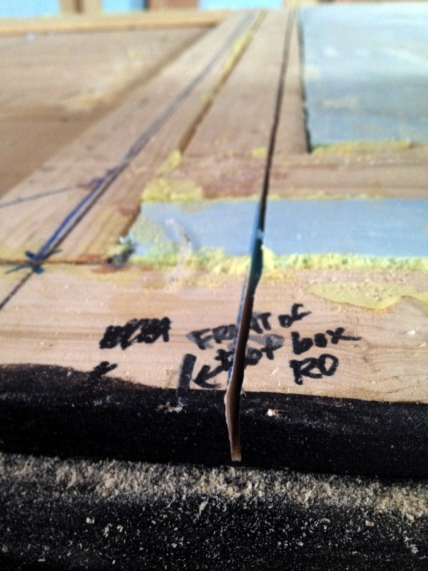

Here's the beginning of the floor- we decided to go with 1x4 pine framing and rigid insulation with 1/4" ply on both sides. We decided to go with the framed floor for the bonus of adding the insulation as we plan to use our TD year-round.

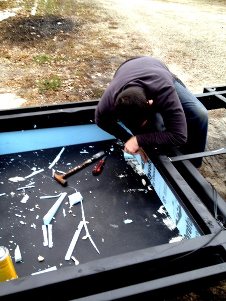

We also decided to insulate the foot-well. We kind of had to, as there was a bunch of space to fill since we had the welder tack the foot-box on to the existing cross-beams which weren't exactly where we needed them. It was only off by an inch or so to the front and back, so we decided to just beef up the insulation there.

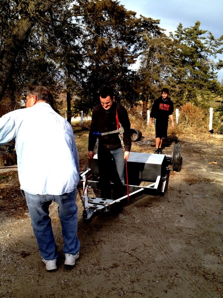

This is my dad, husband, and brother moving the trailer after they had flipped it. Before we got too carried away we wanted to make sure that we coated the underside of the trailer. We ended up spraying it down with the rustoleum, then in addition we coated it with a roof-tar-like substance. It was a rubberized and not-so-sticky substance... the name eludes me at the moment, but it went on quite nicely. All five coats of it...
Here it is coated with the rubberized roof coat.
Flipped back over, here you can see the interior of the foot-well is all insulated, and we have the underside of the floor panel being coated in the rubberized stuff too.
Here you can see the weather-stripping that separates the floor from the frame.

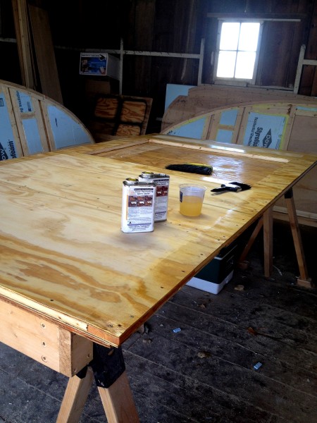

And back to the floor- we used CPES around all the edges and in about 5" around all the openings. I think I ended up putting about 6 coats of the stuff on until it didn't soak in anymore.
It was a match made in heaven! The floor fit perfectly! (The overall frame that we were given was a lot longer (around 14'), and we are only using about 11' which is why there is some hanging out in front. We plan on using this space to put a tongue box and storage- probably with a steel grate on the decking.)

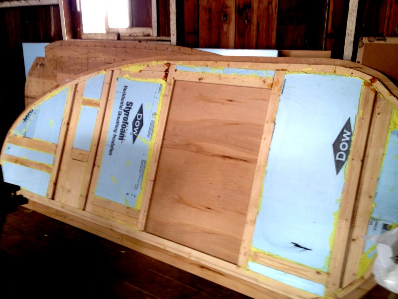

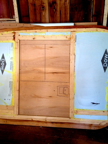

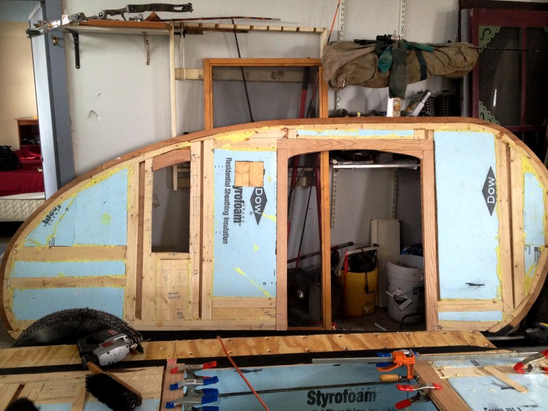

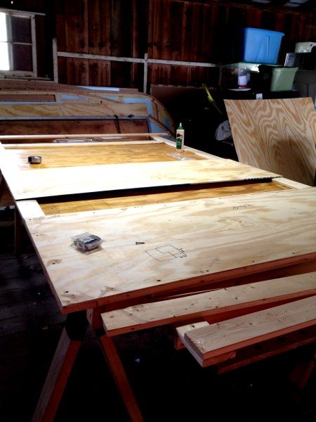

On to the walls:

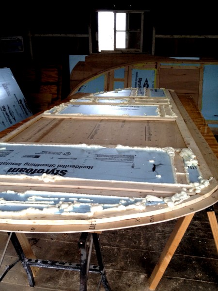

We insulated with blue foam and filled in gaps with Great Stuff.
A rough, but useable, wall panel! Yay! :D
Here was the original door layout- we've reversed them, so they're hinge-forward per the recommendations on the boards, and I also changed my mind and decided that I wanted an arched door...

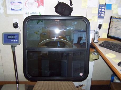

Here are the original windows (can you see a theme developing here? :oops: ) They are 28x28 and split across the middle, so they'll slide up and down, with a screen on the bottom half. I bought these on Ebay not thinking about the space I would need around the door... and they were too big for what we originally wanted to do. Sooo... I bought more windows. (Yes the original pair is for sale!!) The second pair weren't much narrower, but they also have a nifty function that they are emergency windows, so in addition to being sliders, the whole window can hinge out from the top!! Yay!! The best of both worlds!!!

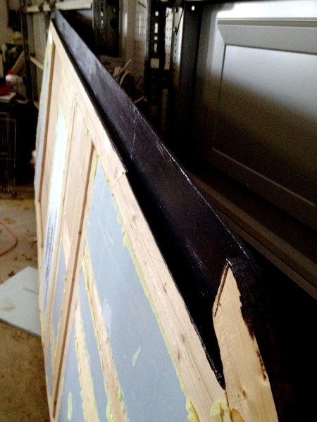

Here you can see where we coated the bottom lip of the wall with the same rubberized coating as the floor and frame.
The rounded-off top as mentioned earlier.

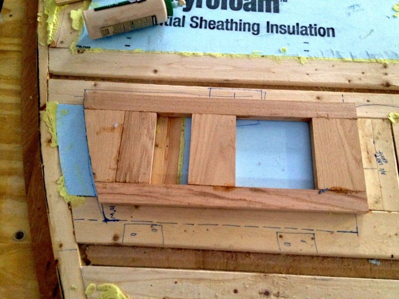

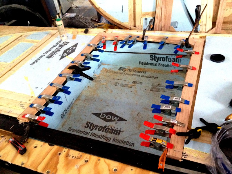

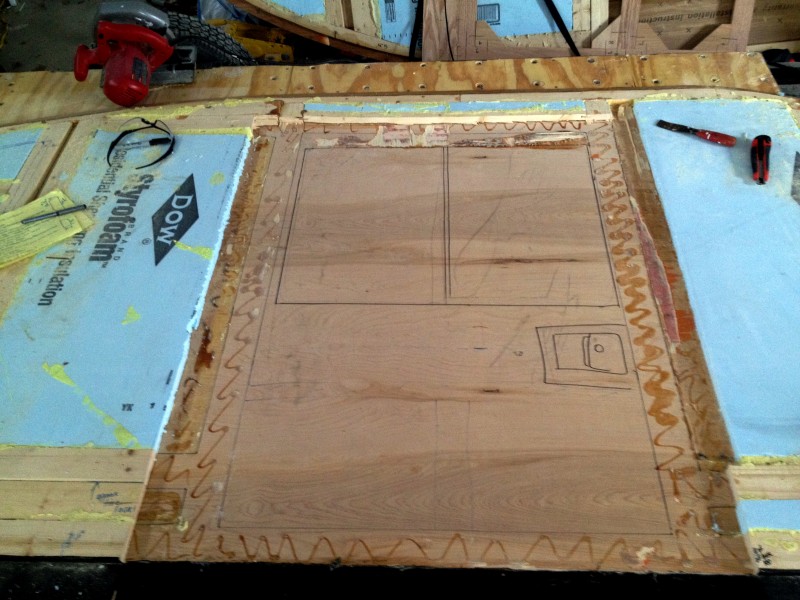

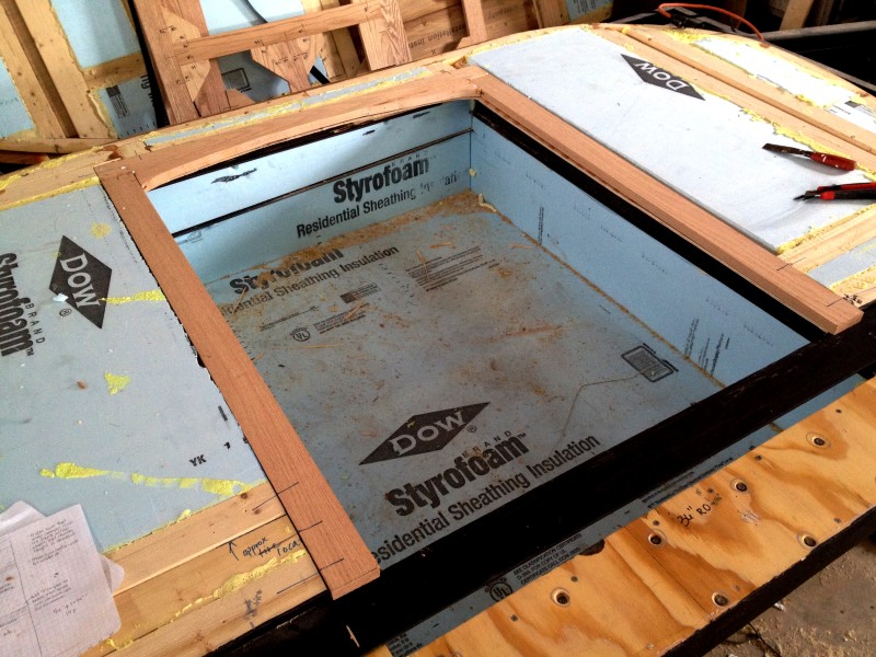

Here are the doors all framed-up with blocking for the window and door handle. You can also see that I decided to build a door frame out of red oak... meaning...
:duh: That I had to cut into my existing framing!! :frightened:
Here you can see where all my beautiful , ahem.. framing had to be hacked out. It took forever. Titebond III works really well.
Here's the new red-oak, arched framing in place with the hole for the door cut. :phew:
I put a TON of glue on under this frame since it wasn't tied in as well as the last one was...I wanted to be sure this one couldn't be removed! :)

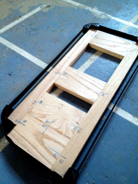

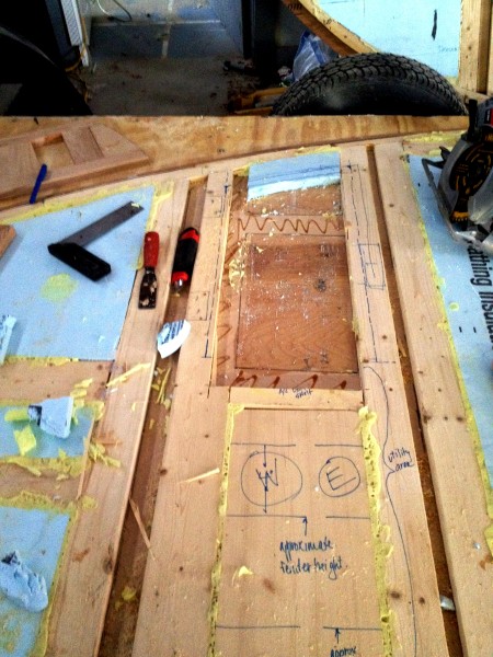

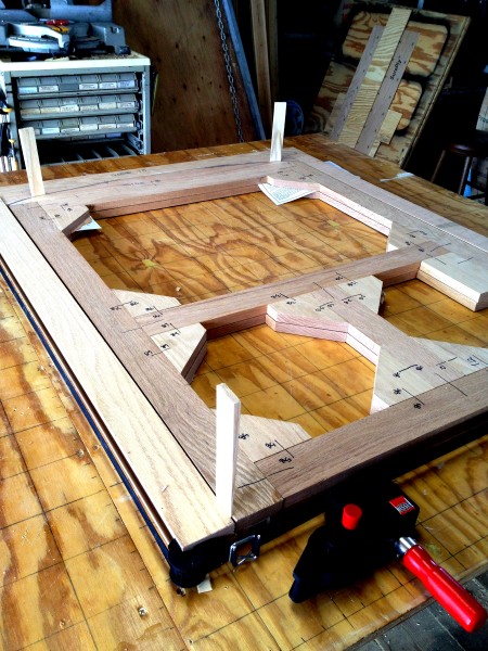

I also made the cargo door frames.
Here's the general layout of the small doors for the utility channel (between the galley and cabin).
Of course I had to rip out framing to put that door in... :oops: We'd like to think that we're on top of things, but somehow we just forget!!!
And here's an almost completed wall panel. :yay: You can see that I also added some blocking for the light that will be placed outside.

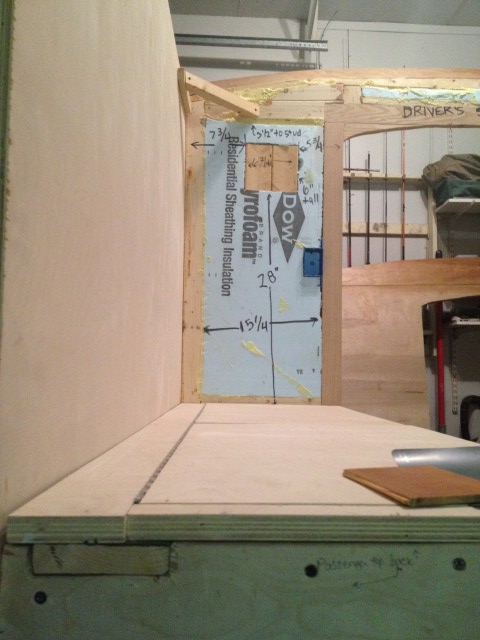

So I've made some progress since the weekend, which is pretty exciting! My goals for this weekend are to have the forward bulkhead in place, the passenger side wall, skin and insulate the doors, and get the other bench seat in. (YAY!) Makin' sawdust! :dancing:

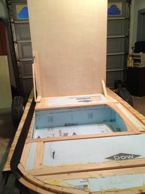

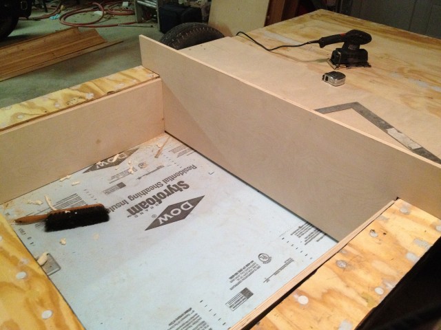

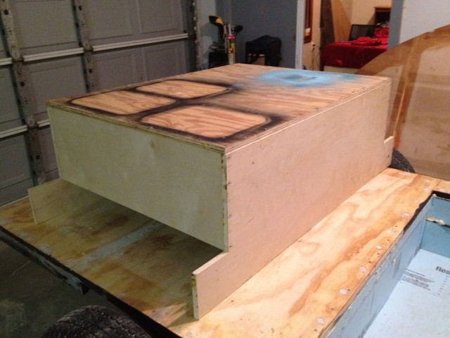

First things first- we started work on the foot-well/box lining
We decided to build the skin for the footwell as a stand-alone piece and then fit it into the camper after we knew it was all squared-up.
After a little bit of sanding and coaxing it fits! We back-filled any spaces with expanding foam- although there aren't too many, it's a pretty tight fit.

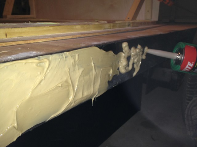

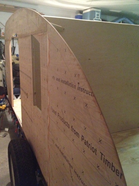

My husband helped me a bit this past weekend and decided he wanted to attach the bulkhead to the wall before attaching the wall to the side-frame. It ended up working pretty well as we didn't need to fanagle either piece into place or hold the side wall awkwardly while we were trying to glue and screw it in.
We may (or may not) have used copious amounts of Loctite builder's-grade construction adhesive for attaching the wall to the steel frame....
It's vertical!

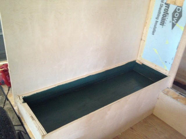

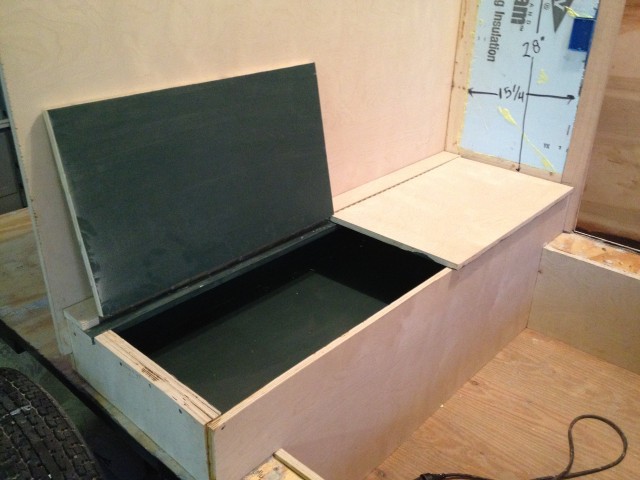

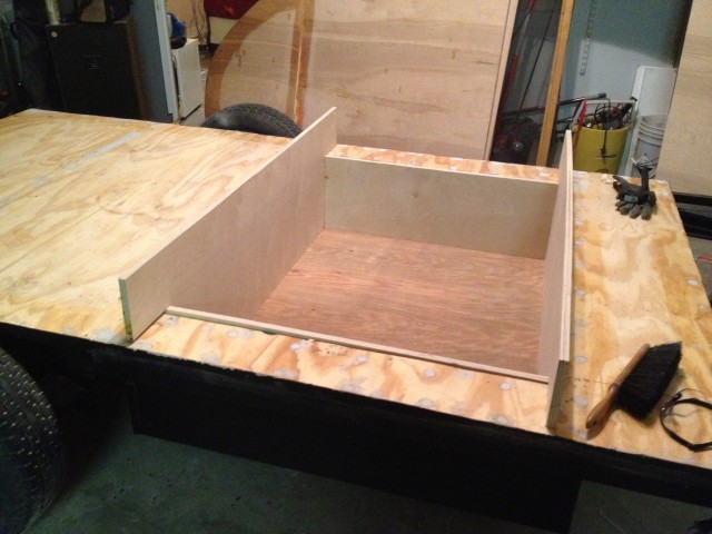

While my husband went back to work, I got started on the storage benches :)
Thanks for looking! In the meantime, I'm working on electrical schematics :? and figuring out the air conditioner. Any advise on the later is greatly appreciated!!
