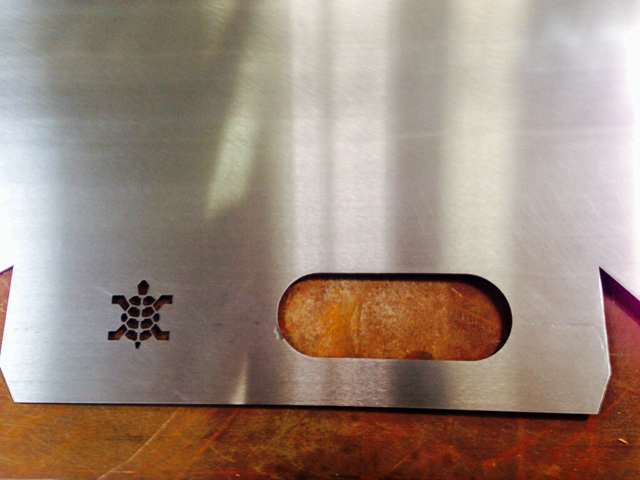

Well I was going to wait and show each part as it went through the process in order but I just got the floor sections cut today and I was so happy with the job the cutter did. So I had to share a picture.

Laser or water jet?
That is some nice detail with the turtle shell. :thumbsup:
Re: Turtleback Trailer Build - From the Manufacturer
Postby DZRTDAVE » Fri Jan 31, 2014 6:05 pm
Thanks. It's a Laser. I'm thinking about getting a water jet though. More versatile

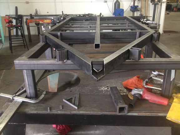

So let's start at the base, the frame. We use all US sourced steel with thickness ranging from 16ga to .188". I built a jig or fixture to fab the chassis up on. Doing this we created a flat and square platform to work from. Just like building a house, if you're not square from the start you're in trouble later when the doors won't close.
Here's a picture of our frame fixture.
Frame Jig.jpg (213.69 KiB) Viewed 1025 times

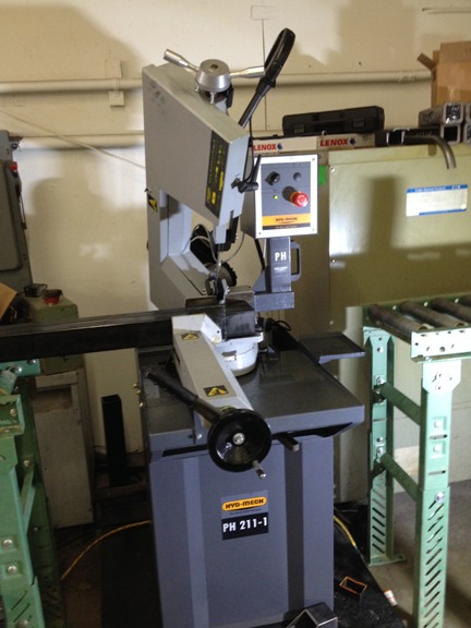

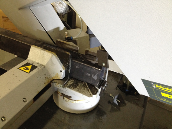

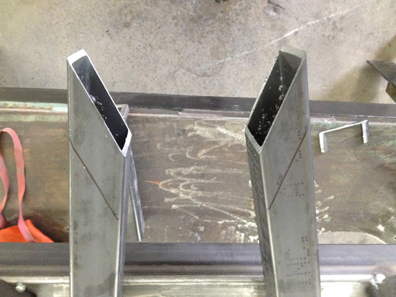

We cut out steel on a Hyd-Mech manual band saw. This is so much cleaner and quieter than an abrasive saw but most importantly is a true cut every time. We can swivel the head 60 degrees to cut the front of the trailer rather than guessing how long the stick needs to be and cutting it with a skinny wheel.
Hyd-Mech Bandsaw
Hyd-Mech Bandsaw.jpg (201.16 KiB) Viewed 1025 times
60 Degree Cut
60 degree cut.jpg (191.68 KiB) Viewed 1025 times

I've got a free day today so I'm going to post some more pictures. I'm continuing where I left off. Here's a pic of the 60 degree cut for the nose of the unit.

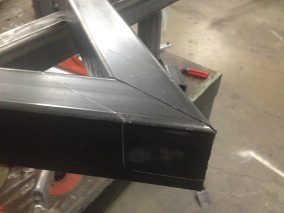

Big Cut for Nose
Big Cut.jpg (199.54 KiB) Viewed 1022 times
Cut Nose Pieces
Frame Front Cut.jpg (212.67 KiB) Viewed 1022 times
In Place on the Jig
After the nose is cut I notch it for the backbone and front receiver hitch. Pics to follow

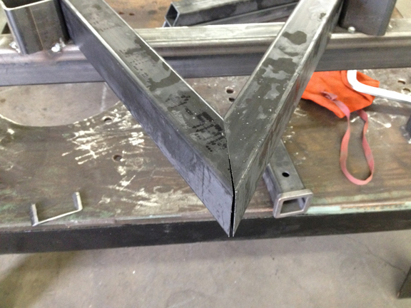

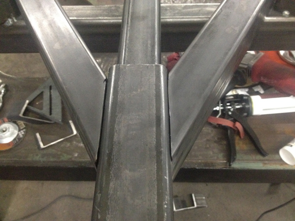

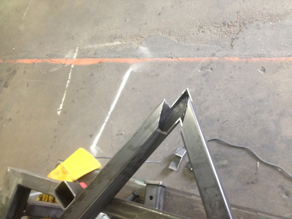

I have a template that we created to cut a crisp notch on the nose. This is a critical point for the unit so a tight fit is a good idea.
Scribed for the notch
Scribed for the Notch.jpg (174.21 KiB) Viewed 1016 times
Here's a pic after the nose is notched and ready. I cut it pretty close so we dress it out for the final fitment.
Notched Nose
Notched Nose .jpg (182.54 KiB) Viewed 1016 times
Front view of the notch
Notched front.jpg (209.94 KiB) Viewed 1016 times
I like this method of trailer design because all of the parts are integrated. The tongue isn't welded on the bottom like my first unit. This gives better ground clearance and structural integrity.

It takes about a day to cut out and prep 5 trailers. When we started it took a day to do one. By getting a better saw that we could gang cut and cut with a quick swivel of the head for the angle cuts saved a whole bunch of time plus we eliminated the calculation and recalculations.
Here's a ready to weld nose
Backbone and Receiver in place
Backbone and Receiver in Place.jpg (198.54 KiB) Viewed 1014 times
Nose Ready For Welding
Nose ready for welding.jpg (197.88 KiB) Viewed 1014 times
Nice Tight Fit
Nice tight fit on the nose.jpg (198.07 KiB) Viewed 1014 times
This sums up the nose on the frame.
