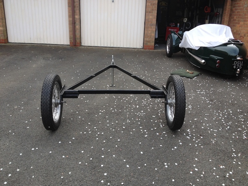

Hi all,
I introduced myself on the Newbie forum (five wheels is the way to go)
I have now almost finished the frame and suspension. The rims are aluminium 18" Weiman BMW, the spokes are s/steel, the hubs are bespoke Triking items. The stub axles are from a Triumph Vitesse mated to 250kg trailer suspension units, the tyres are 400 x 18 Avon SM's.
Now for the body ......

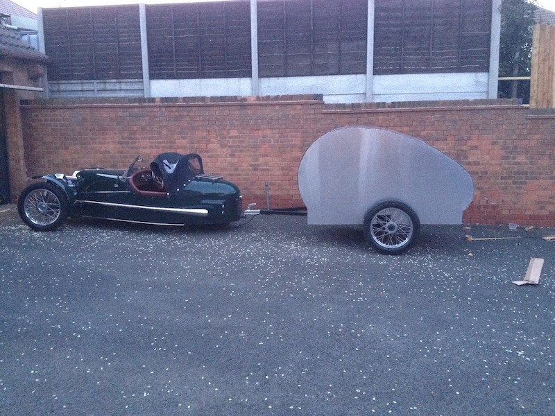

Hi All,
Test fit of body on frame. I have not decided on mudguards yet or the final shape of the bottom curves.

Very cool. I would match the front guards on the Morgan TV.

That set up is going to turn some heads going down the road

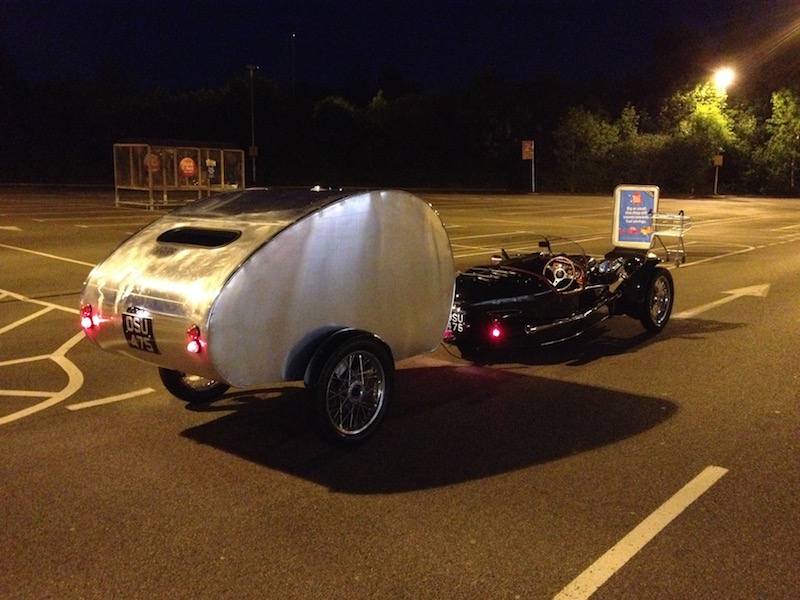

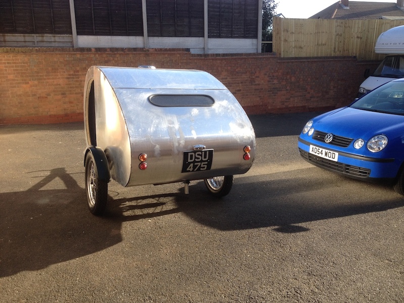

Road test completed, tows really well, just need to polish it now !
It has a hinged 'drop down' floor hatch which allows you to sit on the floor, dangle your feet outside and eat at a hinged shelf / table, whilst looking out of the rear window. To prevent it from tipping back I have fitted a telescopic leg at the rear. It also has a solar powered roof vent.

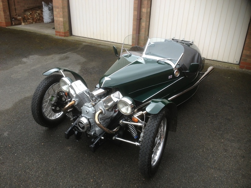

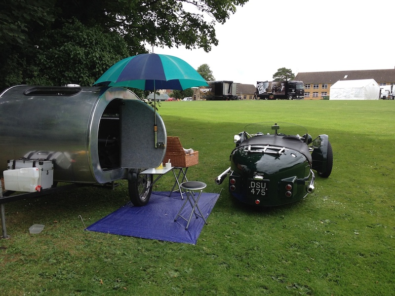

Some time since my last post. Done quite a few miles now with no real drama except with the mudguards. I wanted them to hug the tyres so i mounted them on the suspension trailing arms, unfortunately the vibration and suspension movement causes the support brackets to fail. I have reluctantly decided to mount the guards onto the body.
The attached picture was taken at the Brackley Motorcycle festival in 2015
