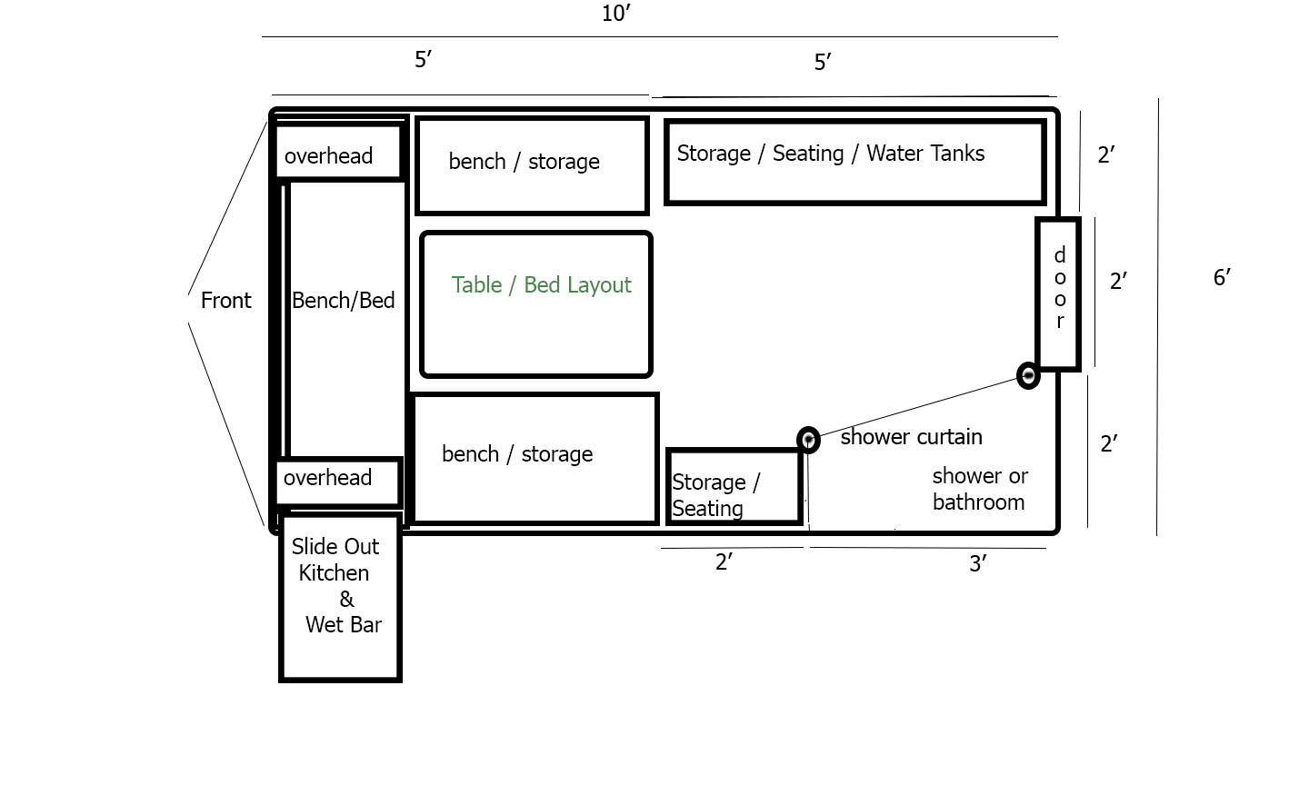

I also intend on having a roof overhang when fully closed, allowing for a very high ceiling when propped, I tried to show in the above image how a little overhang adds a lot of height and front space. Being as the extra side walls will be made of insulated fabric, the weight impact should be minimal.
My personal plan is to have a 1' over hang all around the trailer frame, giving me a 6'x10' teardrop. The width of a Focus is 2" short of 6'.
So far, here is my rough-draft top view:
top view.png (51.45 KiB) Viewed 3909 times
For me a shower of some form is a must, a toilet is a bonus that I could live without... I can effectively shower with 1-2 gallons of hot water. A 20 gallon water tank is a hefty 200 lbs, but if it gets me 10 showers and a few days of water, I could realistically dry camp for 5-7 days between stops at hookup locations. I might settle with an outside shower of some form, but I would much rather shower inside as a MN resident the weather is rarely nice enough for an outside shower...

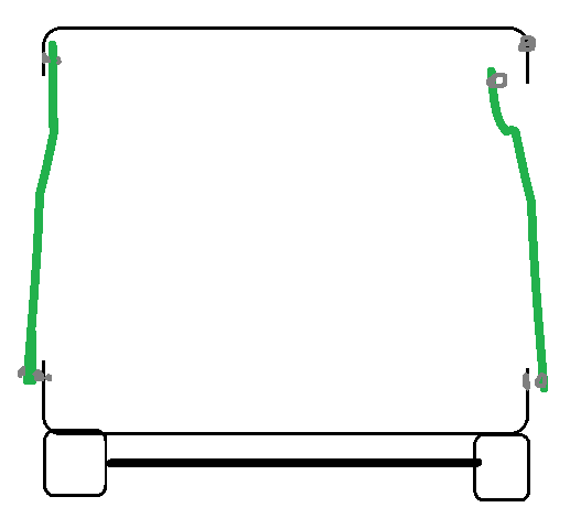

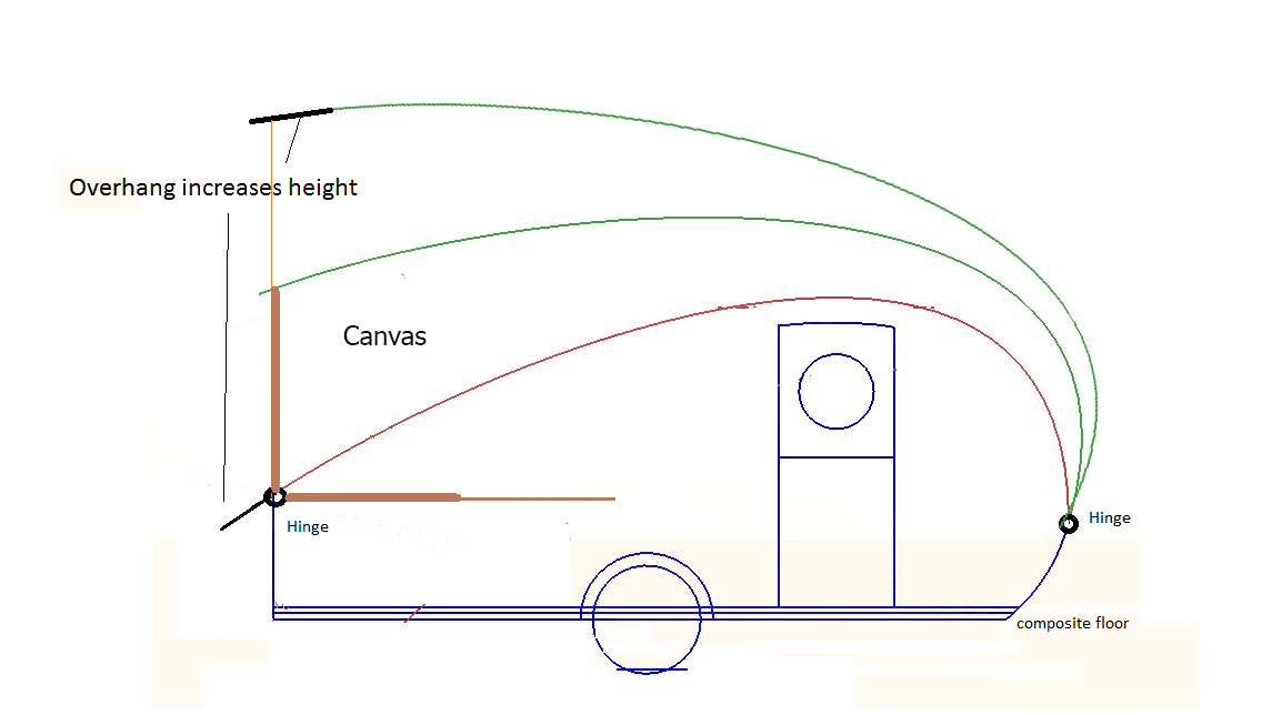

My current and most basic plan for installing the canvas, pretty much involves snap button rivets, like the things found on jeans, with it going inside on the top, and outside on the bottom. This cross-section attempts to show what I mean, I have limited artistic ability...
cross section.png (5.54 KiB) Viewed 3909 times
As such, one would unbutton the canvas from the bottom, tuck it inside, then fold the roof down. It might also be nice to setup a basic bug-screen that can be used in place of the canvas on nice days.

Postby KCStudly » Thu May 07, 2015 6:29 am
Welcome and good luck with your project! :thumbsup:
Staying under 1k lbs is going to be a challenge with a shower, porta-pot, water tank and slide out galley. Don't forget the weight of your 5 day ice chest. 6 x 10 is large and easy to have all of the weight add up.
Also, consider moving your roof hinge further back. You don't need a lot of head room over the seating/sleeping area and the way the hinge is down on the front isn't getting you much extra height there anyway. Cabin will be much stiffer with more fixed roof and the roof itself will be easier to make with less curve to it; same for the canvas.

Postby thelastlokean » Thu May 07, 2015 8:17 am
Thanks for the input, I've seen quite a few builds put the hinge quite a ways back, like the ladybug/army, etc... I haven't seen anyone attempt to move the hinge all the way up... I have a decent amount of experience glassing and molding, even done a few large items.
If you compare the cross section view I posted above with this one, if the hinge is moved back just a little ways the total volume of expansion really is diminished.
You get ~30% total volume increase. Where as with the hinge all the way back, it is pretty easy to achieve 200% volume increase. Most importantly, a short person 5'8" like myself, will be able to stand upright everywhere. Hinging the front enough to change the front angle to curve 'out' instead of 'in' will also make the front space a lot more usable, I only want the sliding kitchen because I would rather cook outside and it frees up some nice inside space. I'd like to have the kitchen usable from the inside by removing the top on the front bench that houses it.
I'm gonna give it a shot, unless someone shows me that it has already been attempted and failed! After doing some more digging on my particular vehicle, a 2005 Ford Focus, it seems the UK and Canada have its tow capacity at 1,000 kg! For some reason, the same car int he US is technically specified at 1,000 lbs, but such information makes me feel much more at ease with possibly towing 1,500 lbs... I imagine however, if you are pulling beyond the rating your SOL when it comes to insurance if any accidents do occur.
The fabric material I intend to use for the expansion, is some type of chemically insulated canvas used to make pop-up ice fishing houses.. In my experience, they are amazingly well insulated for the weight and thickness, completely wind blocking, a single propane heater can keep a very decent shelter above 70 F with being off most of the time, even on a windy -10 F day... I'll probably end up cutting up an old damaged ice house, the exact materials seems hard to find and expensive but damaged pop ups can be had for cheap.
Regarding the large curved 1-piece roof construction, I do have a plan worked out in my mind. After the floor and side walls are good and cured, the top lip of the side walls (where the roof would normally be glued on), will be waxed, possibly just wax paper folded in half and tapped in place with masking tape. The piece(s) of roof foam will have release slices added where needed for curves. Then the roof will be positioned and held in place with tape. Once it is all positioned, I will then carefully seal all the release slices with glue on the inside, and canvas/glue the outside. If all goes well, the wax paper will stop the walls and roof from merging, so I will be using the teardrop itself as the mold to form the roof. After that cures, I plan to remove the roof, flip it over and canvas/glue the inside without being stuck on the inside. I will then attach the roof to the floor with multiple heavy duty hinges. Doing the roof in such a way will also ensure it lines up perfectly with the walls for a good seal while traveling.
I suppose, the worst case is it doesn't work and I waste $50 on foam, but then I'll just shrug it off and rebuild it with the hinge moved further back.
Those are some interesting points with regards to the water supply, I could realistically put some water in my vehicle as well, I could get by with 10 gallons of water on board and put some more in my car if necessary. I'm pretty sure I'm gonna have a corner be a shower, it seems pretty essential in my mind, without it I might as well just sleep in a tent. Also I plan to setup my shower so that the shower curtain can be tucked to one side, and it is just a small tub/drain on the floor.

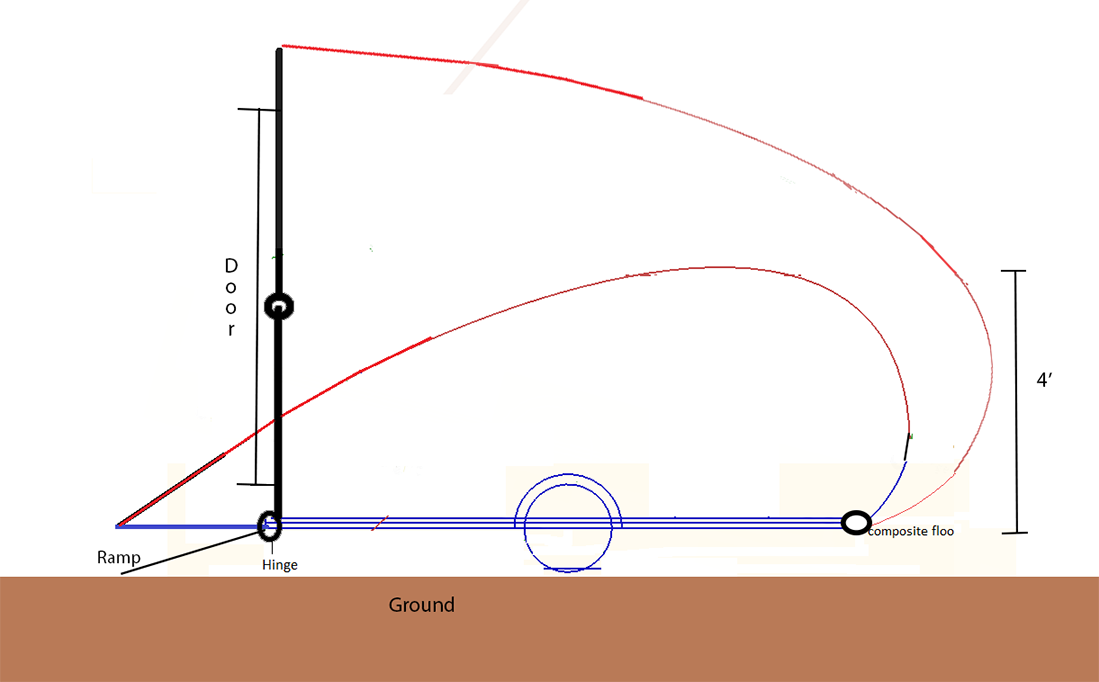

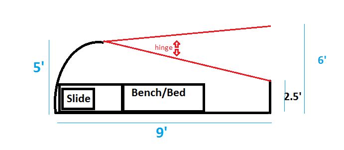

I have made some more design changes, I am going to attempt having the entire roof hinge:
the plan 2.png (78.31 KiB) Viewed 3725 times
As this is being custom built for myself I want the latched height to be 57.5" or smaller from the ground, as that is the height of my vehicle. I want the popped up height to be over 5'10" throughout most of the inside...

Postby daveesl77 » Fri May 08, 2015 5:24 pm
One area you'll need to address is the "racking" forces of moving such a large, essentially unsupported structure. I'm not saying it won't work, as I think with a fair amount of thought, you can pull this off. There are some really smart structural engineers on this site that would probably love to give you some input. This will be an interesting build and I look forward to it. I love new ideas!

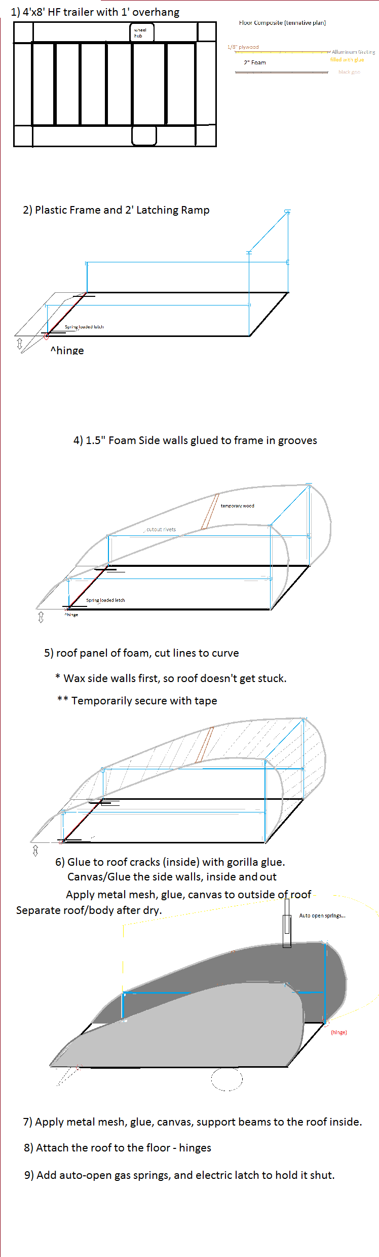

I started planning my build out step-step, and after looking at pop-up ice houses, I think I'm going to make the rear door be heavy duty canvas, with a zipper-open door. Instead of using the door to hold it open, I plan on implementing some gas-springs to hold the lid open. I want it to 'spring' open on its own when the latch holding it shut is released. Should seriously help with my weight limitations...
This is a tall picture, showing my brainstormed step-step process, scale is 1' ~ 40 pixels.
Regarding the roofs strength, and resistance from bending, etc...
I plan on turning the roof into a composite with some framing in order to achieve the desired strength.
My current plan, unless someone has a better suggestion, is to use some decent gauge welded wire mesh that is commonly used for making fences, rabbit cages, etc. between the foam/canvas, so in the 'glue' layer. Combined with a couple of framing support beams on the inside.

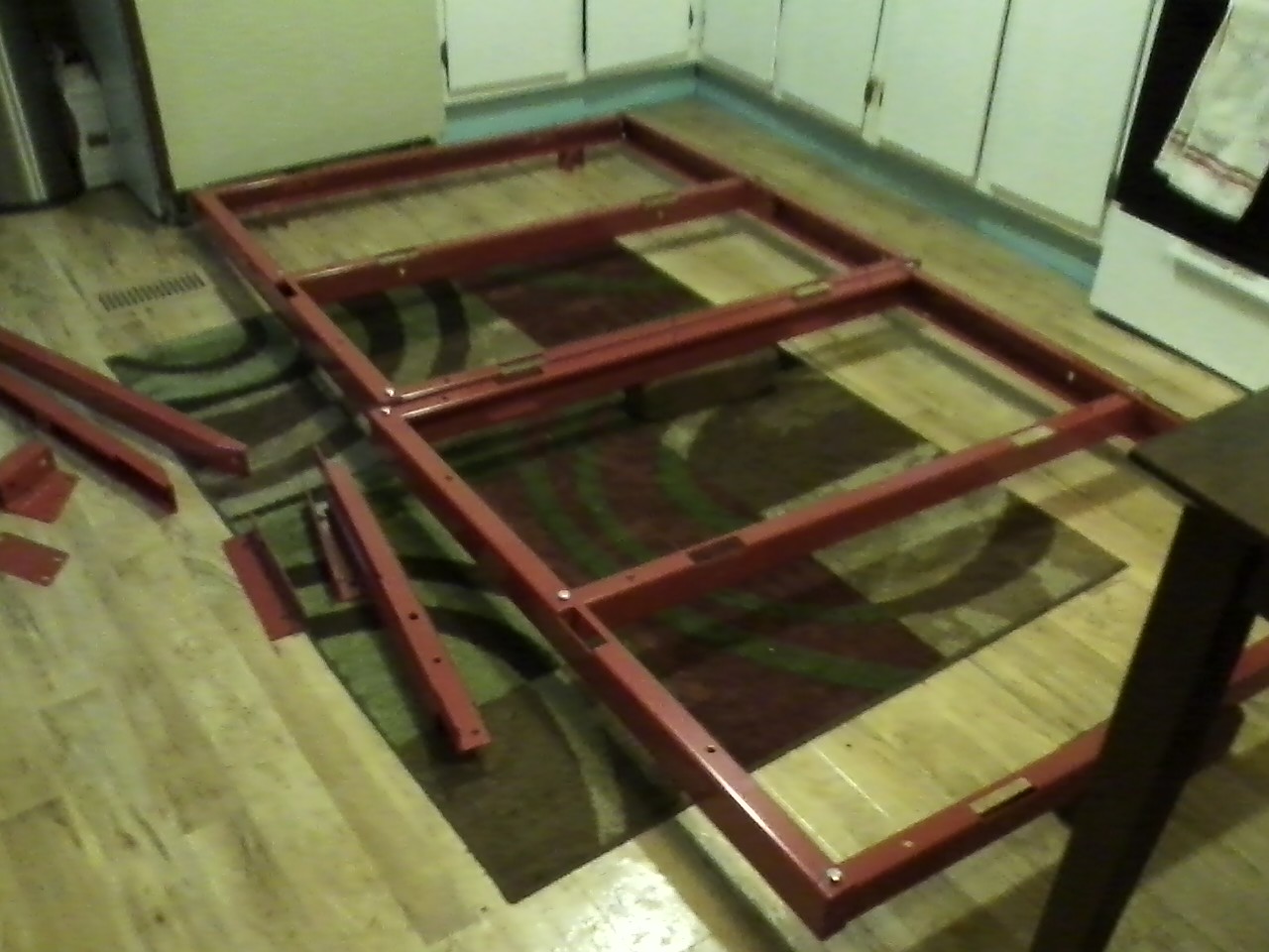

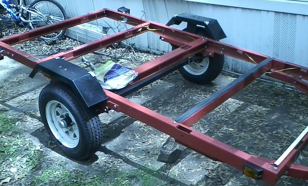

Been busy starting the build... and I snapped a few photos with my terrible phone...
First I put the hitch on my car, and built the harbor freight frame.

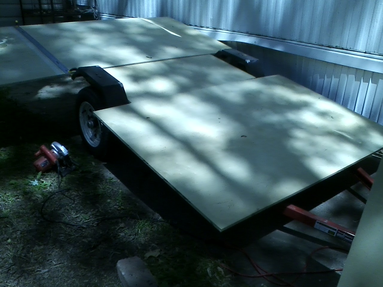

I just recently picked up plywood for my decking. After much debate, I went with 3/4" 11 ply birch veneer core plywood, a little pricey at $40 each but I think it will be well worth it. Each 4x8 weighs ~63 lbs... My 6x10 should weigh ~120 lbs in plywood, not yet counting some epoxy and foam.
Another note/issue, the harbor freight trailer has an 1/8" vertical gap between the side channels and cross beams, I've seen this dealt with in many ways, I'm trying something a little different. I just laid down decent foam weatherstripping about 1/2" thick on every cross beam.
finished the frame weatherstripping the gap
weather stripping the gap.jpg (175.12 KiB) Viewed 3466 times
starting the plywood floor
plywood floor progress.jpg (203 KiB) Viewed 3466 times
Rather than building up a wooden frame, I'm going to lay the plywood directly onto the metal frame, glued down and screwed with self-tapping screws meant to go from wood-metal. I'll insulate inside the frame with foam sheets and good-stuff expanding foam, then seal the bottom with something thin and weatherproofed like 1/8" HDPE plastic sheeting, or maybe something lighter like fiberglass + epoxy...

On the gap issue of the HF frame, I had some 1/8" aluminum bar laying around and made up pieces to fit between the floor and crossmember. You could pretty much put anything there, some even just used washers, which is fine. One thing I made sure of is that every though hole was fully sealed with caulk and then put a thin cushion of silicon on any rub/stress areas. You may or may not wish to do one more add-on, but for me putting a 2" square steel tube from the second crossmember back out through the tongue and then extended 18" gave me peace of mind and made the trailer handle much better. This turns an "A" frame tongue into a composite tongue (at least I think that is what it is called). That extra 30-40 # of steel just makes me feel better.

The foam will crush and deteriorate over time, and might actually hold water. It's probably not a big deal in the grand scheme of things, but if it were me, I'd want something solid in there. Wood, plastic, aluminum, anything that will hold up. $0.02.
Re: Alto(Pop-Up) Inspired Foamie - Build Progress
Postby thelastlokean » Wed Jun 03, 2015 12:18 am
^ Based on your concerns, I've done some weatherproofing of the foam strips, soaked it in gorilla glue before I screwed down the plywood. Then I painted the foam edges with more gorilla glue from the outside. The foam seems to be fully encased in a nice layer of foamed up gorilla glue, I don't see how water will get into it, but I'll still be spray painting a layer of Rustoleum for a final waterproofing layer. The plywood flooring is very sturdy with no detectable bends and completely silent, no creaks or squeaks! A few years time will tell how this holds up.
Also I plan on fitting the frame with foam sheets, and covering the bottom. By the time all of this is done the foam strips will most likely never see a drop of water, or even air.
Also, I got a dowel jigging set so I could merge the pieces of plywood with dowels, used a 5/16" every 4" along the 4' plywood seams... Sure was a pain to drill all those holes, but wow is it stronger than anything else I could have rigged up! I am pretty certain I am going to involve dowels in supporting foam my side walls and inside furniture...
I intend on clear coating the top side with clear epoxy, specifically 'Envirotex Lite Pour-On High Gloss Finish' for counter-tops, it'll take 2 gallons to get a solid 1/8"-1/4" coat, but it should turn out nice and add even more strength.

I really want the inside to be a thing of beauty, I don't want to lay down any other type of flooring (carpeting vinyl or anything else that is garbage after 1-2 years. I'm building 6' wide so that I can sleep horizontally, in the front 4 feet of length. The bed will also be one of those 3-booths with a raise/lower table to make the bed complete. So unlike a classic teardrop most of my floor will be visible when inside, not completely covered by bedding. The first 6'x6' section of flooring will be mostly visible, and the back flooring will still be somewhat visible when the table is raised. Also my teardrop is going to be my only trailer, so I imagine it will be occasionally used to transport stuff around, like firewood/lumber, bricks, etc. So I want a good solid scratch resistant floor.
Also I was starting with raw 11-ply birch, the best peace of mind for myself it to last is to fully encase it in resin.
I spent multiple hours last night sanding and wood-filling all the screw holes and cracks/seams, etc. By the way, a great DIY wood filler - 1 part sawdust, 1 part titebond 2, 3-4 parts light drywall spackle. It turns into a nice clay that picks up stain/sealants, easily sand-able and turns out the perfect color if you use sawdust from the original wood. I only use sawdust from the fine catch on my sander.
Regarding the epoxy weight, around 9 pounds a gallon, full thick covering won't add more than 20 lbs of weight, but certainly increases the plywood strength dramatically. I will also most likely put some fiberglass sheeting over the plywood edging and seems just to really protect it.
