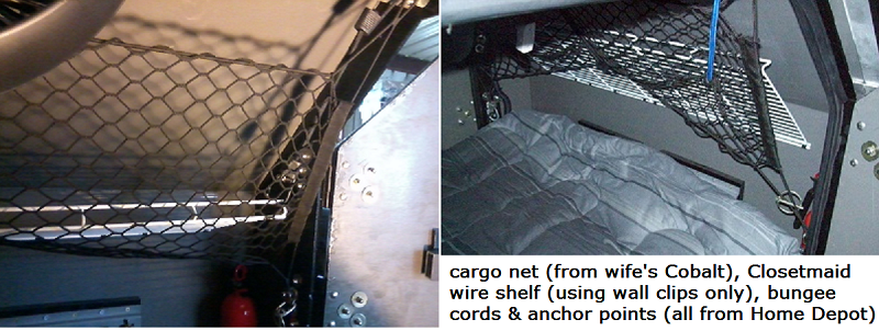

  • I use a combination of a wire shelf for closets, a 3-ft wide cargo net from my wife's Cobalt, bungee cords, and wall-mounted anchor points to store most of my clothes, toiletries, towels, etc. inside my cabin. I made it where it can expand to hold more gear, or fold up out of the way when not needed. It is mounted under my overhead stereo/fan shelf (but still high enough to clear my feet - when sleeping-), attached to the front wall with swivel clips (they come with the shelf kit), and the net and the bungees are attached to anchor points above and to the side walls (for expandable size and flexible retention). Since the front end of my trailer is a 45 degree slope, and the entry doors are tucked in behind the slope (with a stereo on a shelf directly overhead, with a folding 10" fan mounted centrally underneath), I needed to fit storage that was able to move out of the way, when I need to move cargo in/out of the doors (I use a front wall-mounted E-track to secure cargo -Aquatainers, coolers- there when travelling). As you can see, I tried to cram as much as I could into a 4x8 trailer (good thing I camp solo, as well).
    folding shelf expands as needed.png (485.99 KiB) Viewed 3797 times
    swings up out of the way, even if lightly loaded
    folding wire shelf, with cargo net & bungees for retention.png (410.1 KiB) Viewed 3797 times
    easy, cheap to make; a good place to store my gear

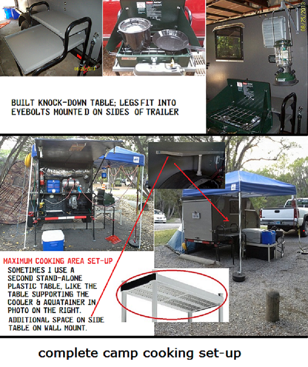

  • I also use removable side tables, plastic tables (components from a storage rack), and/or a knock-down cookstand, to furnish cooking and eating areas at camp. The side tables are wood planks 18"x 24" attached to T-slot tracks on either side of the trailer, but stored in a bag I keep in the cabin for travel. The plastic tables are just a shelf and legs taken from and old Keter storage rack I don;t need anymore, and either travel inside the cabin, or in the truck bed. The cookstand was made from a cheap, broken, computer stand, and leftover plywood. I used hardware from Rockler to make it easily assembled at camp. If I bring it, it rides inside the cabin also (my mattress folds up, and gear is stored between the doors).
  • 107316 carrying cargo to camp (it is registered as a cargo trailer, after all)
    complete camp cooking set-up.png (790.12 KiB) Viewed 3797 times
    everything I need (so far) for cooking
