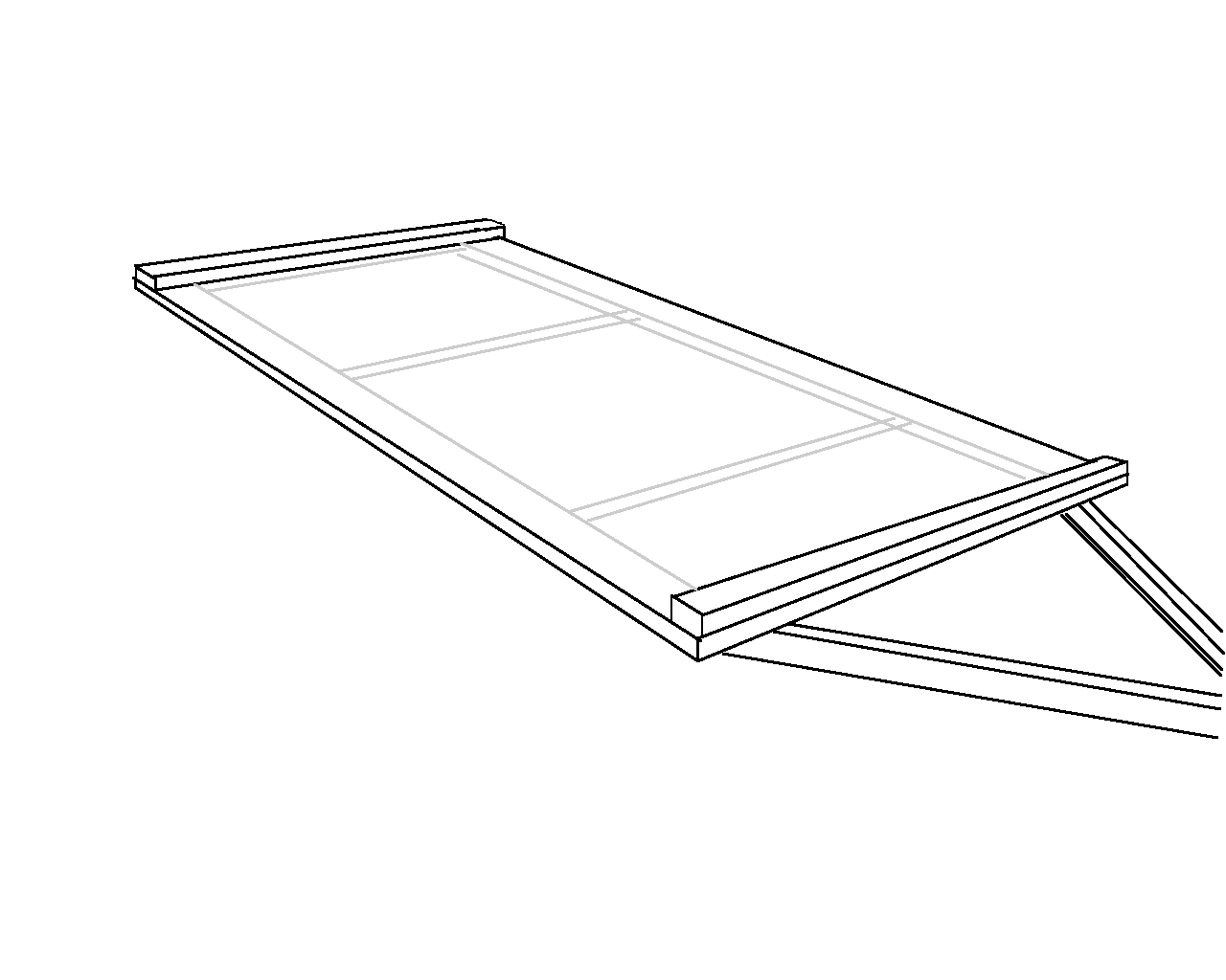

A simple floor could use just two stout cross members Inside the cabin , front and back , to support the floor and moderate overhang (like Row said ^ ) ...especially with a Foamie' which has much lighter cabin weight , so therefore less stress on the floor ... :thinking: No real need for all that frame lumber and clips ...
Re: Newbie Looking Leaning Towards a Foamie
Postby GPW » Wed Feb 12, 2014 6:51 am
...sorta’ like this ...

Postby rowerwet » Wed Feb 12, 2014 12:18 pm
the front wall and foot wall in a normal shaped tear, do all the floor support you need, just like GPW showed, only with the rear floor cross piece located at the foot of the bed.
just make sure all the joints are fully glued, screws and nails are strong, but good construction adhesive can't be beaten.
