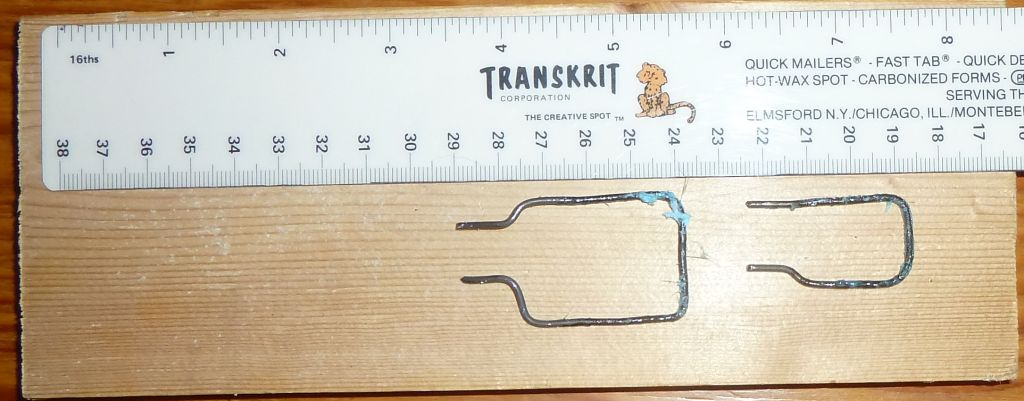

Hotwires used in soldering gun were steel welding wire:
Soldering Gun Hotwires.jpg (71.49 KiB) Viewed 2991 times

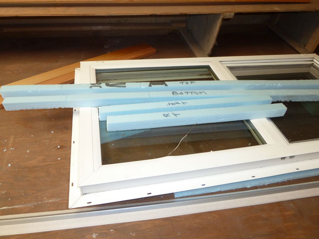

Cut the fill-inserts that go around the window after it is installed - will glue those in with silicone window caulk used around the nailing flange & will fill the edges after the inserts go in; don't want water to get in the most vulnerable wall penetration.

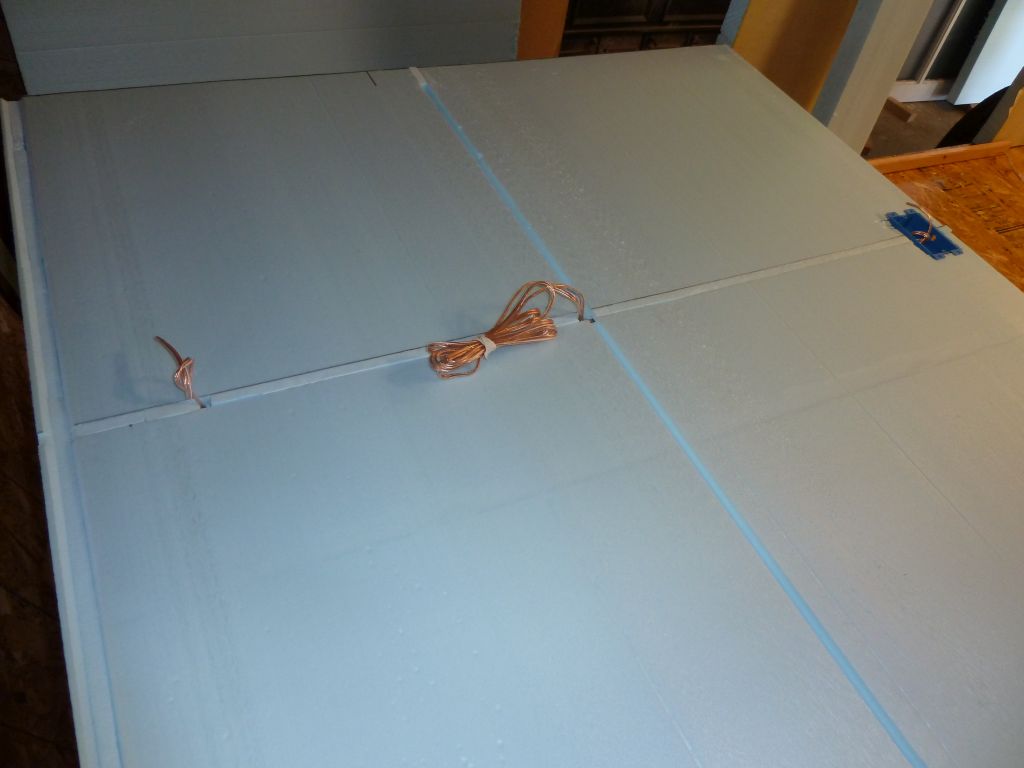

Cut & installed the wiring & the foam inserts that go on top of the wiring; inside back roof is ready for vinyl spackle & sanding. The wiring will run down the galley side of the bulkhead. Wire to left is for Galley LED; right goes to interior overhead LED & Fan. Will be using one of these perforators since I was not satisfied on how well the canvas was sticking to the foam:

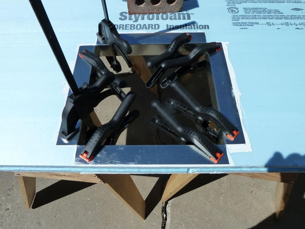

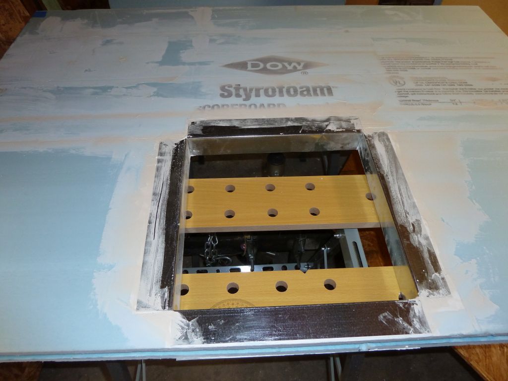

Glued the flashing in the fan cutout with Gripper - may put a couple of rivets in but it appears to be very solid and the canvas over the top of it will hold it completely since I will be overlapping the canvas over the inside edges of the cutout. More practice on cutting canvas to finish is needed and I will get plenty when I put in the roof panels !
Foam inserts so that the canvas will cover the window cutout right to the protruding window edge
Foam filler inserts.jpg (115.93 KiB) Viewed 2932 times
Filled the wiring channels and edges of roof dado with foam insert after running the wires.
Rear roof section inside view.jpg (77.39 KiB) Viewed 2932 times
Flashing may or may not need rivets - will decide when it's dry
Fan cutout flip-side glue-up.jpg (140.16 KiB) Viewed 2932 times

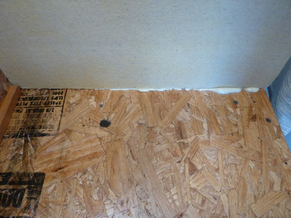

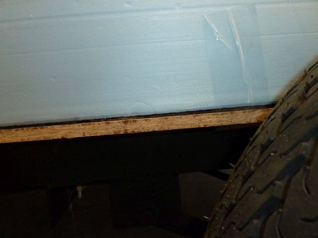

Today's update ! Got the walls Gorilla Glued & screwed in place with normal some good, some bad results. Crooked floor had gaps where the GG struggled to foam up enough to seal - see pix. GG is not very predictable in how well it foams up; moral of story is you must apply too much. Will have to apply 'silicone' to close up gaps on the edges of the walls where they meet the floor on both sides. Plastic drywall screws seemed to work pretty well; walls stayed in their slighted crooked configuration without getting more crooked :R

... but the strength comes from a tightly fit joint. After all, the glue is just foam and the more you let it expand the more it is just air and less structure.
Better clamping, weights, or mechanical fasteners are indicated.
Did you screw up through the floor just into the foam? Not much grab between screws and foam. Are you sure that the foam didn't just push the wall up off of the screws resulting in a gap?

Postby Fred Trout » Sun Jun 14, 2015 6:41 pm
I sprayed water on the non-glue surface & tried to make it even but what can you do when you don't do it right ? :D
It's all done now - I just don't like GG - too spendy, and I put on quite a bit but you see how it came out - erm or didn't come out.
I will just caulk it & canvas it which is really what holds it in place anyway. Some stuff is just too persnickety for me. The walls will only be unsupported by the roof for a day or two and the bulkhead supports them well anyway.

Not worried about it KC. The uneveness was because of the slight warps in the recycled OSB & my crooked cuts & installation. Everything is out of square but it will all go together anyway. I used the dry wall nylon inserts I tested AND a few deck screws just into the foam - everything stayed where is was to begin with - there was no lifting of the sides only bad carpentry to begin with :shock:

The wall is tight on both ends; but when the 2nd OSB floor crosspiece was added it was 1/16 to 1/8" lower for the first foot or two than the 1st OSB crosspiece for whatever reason. My guess is that it or the underlying 2x2 is warped. The other wall doesn't have the gap; go figure :shrug:
