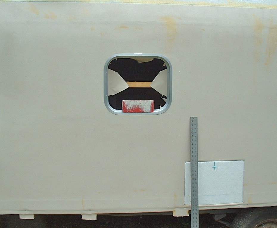

A little measuring (Again!!!) and sanding , got the window opening corrected ... Third time’s the charm eh ??? :lol:

KC , all suggestions , criticisms , and opinions of a constructive nature are always most certainly Welcome .... :D If you see anything wrong , please Stop me ... Heat’s got me addled .. :?

Naa!! just Bad measuring ... :oops: Thought we had it right till I really looked at it ... :o

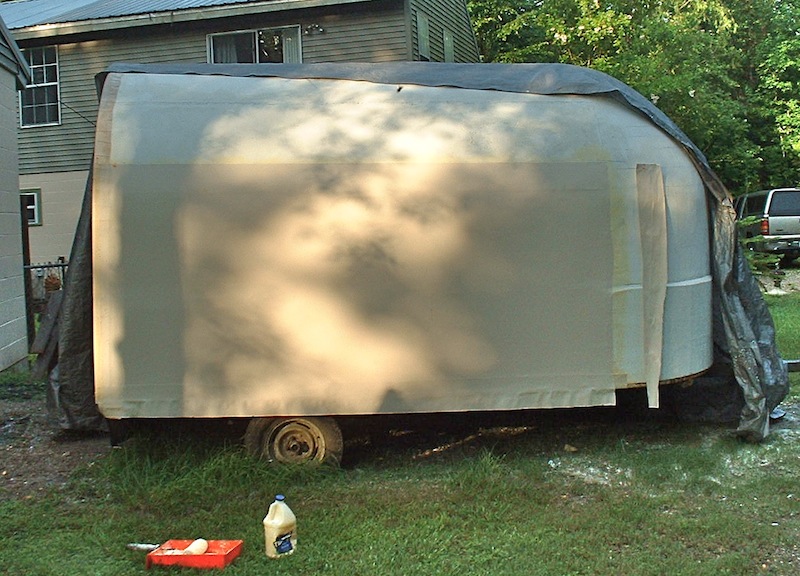

Here’s the panel , bottom side tucked under the floor (over the reinforcing strip) and glued and stapled ... You can see the wrinkled window area , but that will soon become tight due to unexpected (but welcome) shrinkage as it dries ... All the edges solidly glued down ... we find rubbing the glued edges while drying smoothes out the seams , making them dry much flatter ... repeat rubbing as necessary till it all blends together... :thumbsup:
The Sun is still out .... no sight of rain yet ... it may just dry ... :o

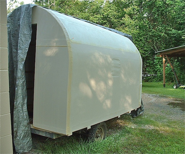

So why is the front of the FS not smooth? The foam has a ridge there/sticking out, not flush. Why is that? I know you must have a reason, and probably said so, but I did not see it.
