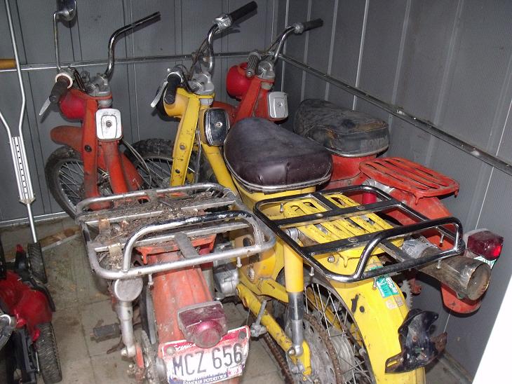

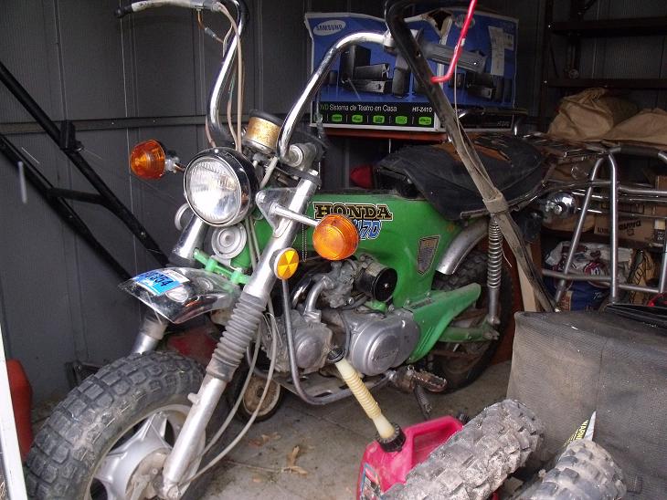

Thanks. Hope to get the other piece on tomorrow.
Lots of stuff piling up in the next few weeks. And I go and buy more stuff to work on..... :frightened:
Honda CT-70
DSCF1825 small.jpg (112.66 KiB) Viewed 2383 times
Honda CT-90
DSCF1829 small.jpg (117.27 KiB) Viewed 2383 times
Should go well for camp trips with the foamie though..... :thumbsup:

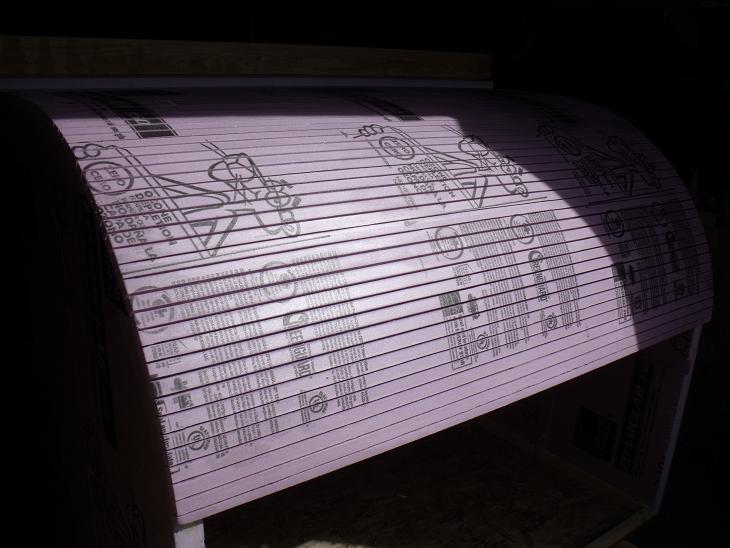

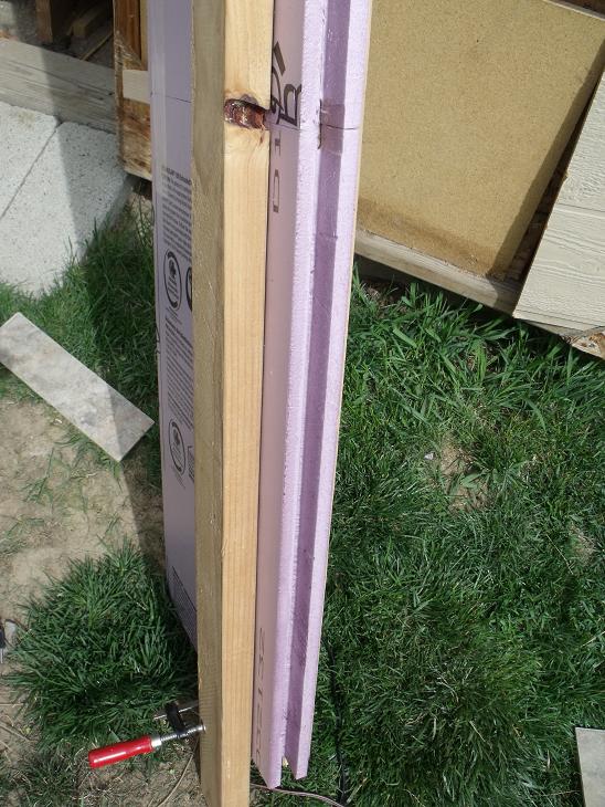

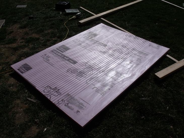

Got the other roof piece kerfed today.
Kerf X 2
DSCF1848 small.jpg (112.55 KiB) Viewed 2373 times
The first piece is glued and dry.
First peice glued
DSCF1850 small.jpg (92.85 KiB) Viewed 2373 times

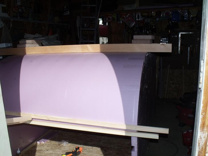

My GS ran out of pressure so I had to switch over to GG to finish gluing the two pieces together. I had just enough pressure to finish the outside perimeter with the GS
Second sheet on
DSCF1852 small.jpg (76.8 KiB) Viewed 2373 times
George.

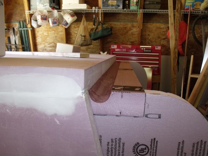

Postby ghcoe » Sun Mar 24, 2013 8:56 pm

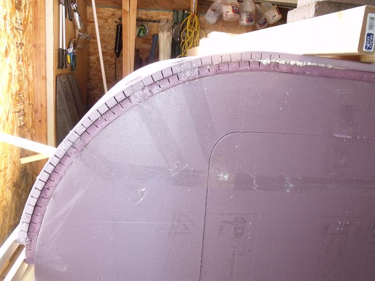

Side view of the kerfs. Everything went pretty well today. I am a little disappointed that the 1" foam did not make the full radius. Not sure if that is going to be a issue or not yet. Have to wait till I put the front piece on and see how it looks. I may still need to kerf a 2" piece, but at least it will only be one or two.
kerfs
DSCF1854 small.jpg (90.1 KiB) Viewed 2371 times
Well hope to get some more done next week. :thumbsup:
George.

Postby GPW » Sun Mar 24, 2013 9:04 pm
George , really liking the way you did that, kerf to kerf , that way outside and inside are perfect ... Super idea !!! :thumbsup: ;)

Postby ghcoe » Sun Mar 24, 2013 9:13 pm
GPW wrote:George , really liking the way you did that, kerf to kerf , that way outside and inside are perfect ... Super idea !!! :thumbsup: ;)
Thanks. Atahoekid has mentioned that is how he did his too. I do like the fact that it makes for a nice clean curve inside and out with just some filling and sanding of the outside edges, which is much easier than a inside curve. :thumbdown:

Postby Papi » Wed Apr 03, 2013 11:19 am
ghcoe wrote:
GPW wrote:Very NICE !!! :thumbsup: 8) :applause:
Wow. I have a CT70 in my shed that looks exactly like that one! It has under 500 original miles. One of those "some day" projects. :roll:

Postby ghcoe » Wed Apr 03, 2013 9:04 pm
Papi wrote:Wow. I have a CT70 in my shed that looks exactly like that one! It has under 500 original miles. One of those "some day" projects. :roll:
Cool. This one only had 1000 miles on it. Motor does not have compression (90psi) so I suspect a sticking valve or rings. Just wanted to get it going so I ordered a 125cc motor. I picked up a bran new bolt in Lifan 125cc motor with carb, intake, coil, cdi and wiring harness for just under $300.00 shipped to my door. :thumbsup: I will try and get the original motor running later and then this motor will go into one of the CT 90's. The parts for the CT70's and 90's are dirt cheap. I got a new seat cover for $13.00 and a throttle cable for $8.00 with free shipping.
George.

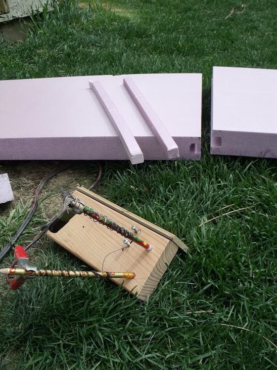

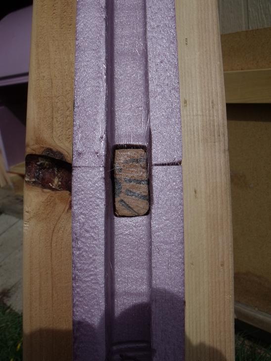

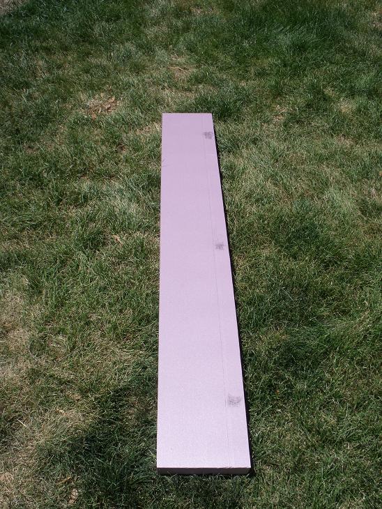

I had a little time this weekend to do a few things. I did some sanding and figured out how I was going to make my shelves for the back. I am trying to use as much foam as possible without making too much scrap. The bulkhead and roof sections have enough scrap to make a shelf if I join them together. I was going to just glue them together, but the more I thought about it the more I did not like that idea. So I made two more jigs today so I can put some 1"x2" reinforcements into the shelf, some info here viewtopic.php?f=55&t=55323. The first jig is to cut half the depth of a 1"x2" and the second jig is to cut the full depth of a 1"x2".
The half depth is so I can cut both sides of the shelf sections and allow the 1"x2" to support both sides of the shelf when glued together.
Shelf cut
DSCF1922 small.jpg (124.87 KiB) Viewed 2204 times
The full depth cut is for the front face of the shelf. This will add support from side to side and also provide a screw in point for the shelf face.
Shelf groove
DSCF1923 small.jpg (126.76 KiB) Viewed 2204 times
This is a shot of the grooves where they all come together in the middle. I have a 1"x2" in the middle.
Groove and pocket
DSCF1924 small.jpg (92.04 KiB) Viewed 2204 times
George.

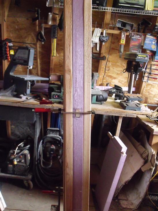

Postby ghcoe » Sun Apr 14, 2013 7:35 pm
Once I got my grooves cut I cut my shelf to the the right depth and then glued the two pieces together. I used the last of my GS which should foam to fill in most of the void areas around the wood. I clamped the shelf with 2"x4"'s on each side.
I am hoping the shelf surface will be nearly flush once the glue dries/cures.
Shelf peices glued together
DSCF1926 small.jpg (105.49 KiB) Viewed 2200 times

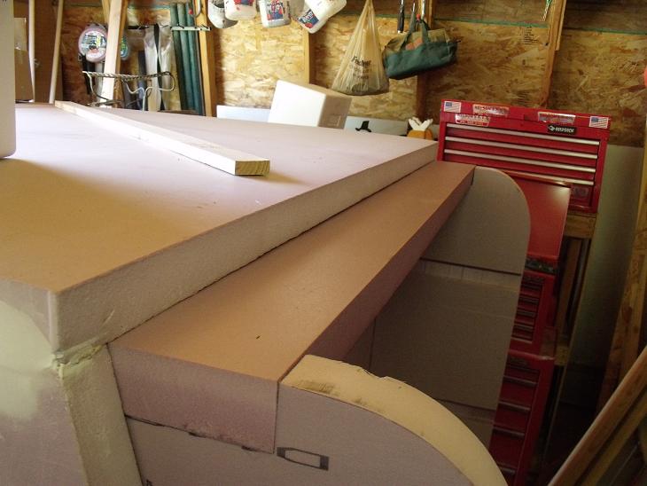

The next section to tackle is the kitchen subroof. As I said before, I will not be using a hurricane hinge on this build to to save money, keep the roof line more aerodynamic, and keep it simple. 8) I will be using a simple foam/rubber seal along the edge of the roof line, but need some insurance in case water gets past this seal. The answer is the subroof.

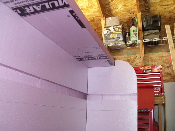

Subroof cut
DSCF1976 small.jpg (162.52 KiB) Viewed 2100 times
This is a test fit of the subroof. All looks good.
Test fit of the subroof
DSCF1977 small.jpg (85.8 KiB) Viewed 2100 times
Subroof test fit
DSCF1978 small.jpg (86.42 KiB) Viewed 2100 times

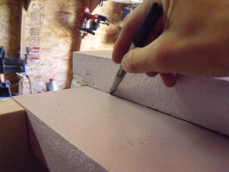

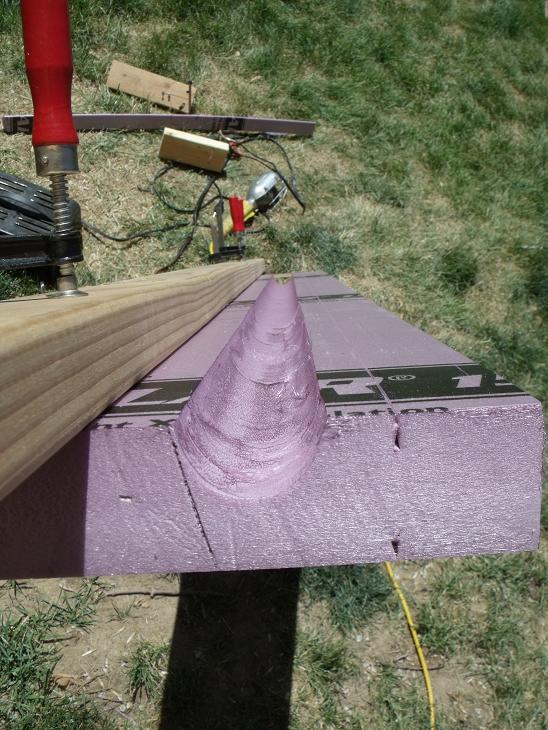

Now I need to make a gutter to direct any water that gets past the roof seal away from the kitchen. I marked where the roof ends on the subroof for a gutter guide.
Marking for the gutter
DSCF1979 small.jpg (75.35 KiB) Viewed 2098 times
I had to make another hot wire jig. This one is a half circle. I went with a circle so it would be easier to clean, no corners to collect dirt. :D I used the mark I made earlier to locate my gutter cut.
Gutter hot wire cut
DSCF1982 small.jpg (123.65 KiB) Viewed 2098 times
The subroof installed showing how the gutter will divert water away from the kitchen. This will also work when the hatch is up. :D
Subroof with gutter
DSCF1983 small.jpg (87.84 KiB) Viewed 2098 times
