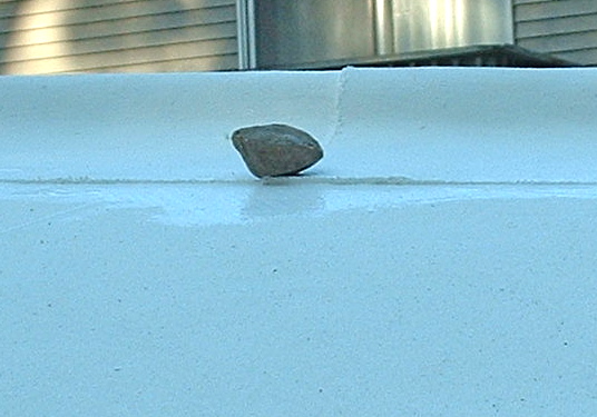

Quick Tip : had a stubborn corner edge on the top just didn’t want to stay down ... so I put a rock on it ... That did it !!! :lol:
Re: FoamStream...
Postby Wolffarmer » Sat Jul 20, 2013 7:50 am
GPW wrote:Quick Tip : had a stubborn corner edge on the top just didn’t want to stay down ... so I put a rock on it ... That did it !!! :lol:
Good ole Newton clamp. Old tech but still very viable.

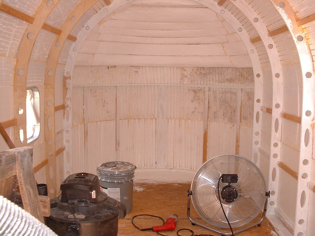

Started priming the ribs inside ... tricky painting those holes ... :o
