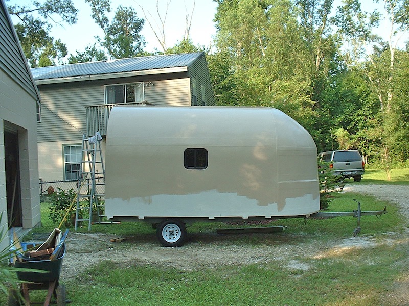

Postby GPW » Fri Jul 26, 2013 8:17 am
Well, here’s the Official 50 foot Photo of the FS , and it’s 2nd coat of paint ... :lol:
Went around picking little nits out of the paint to achieve a better finish ... mostly foam beads ... :roll:
