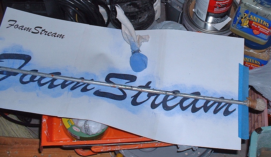

W, take an old scrap of cloth about 8”X8” put the chalk in the center , gather the ends ,making a little bag , and put a rubber band around the top ... I used a scrap of the old canvas from Foamie #1 ... This method allows Anybody to get good results ... old as the hills , it’s the same way Michelangelo did the Sistine Chapel .. True !!! And here’s the secret ... no matter what you have painted on your trailer , the eye (viewer) will Always look at the graphic elements (like words, letters, numbers ) First ... The “distraction" .. Look how adding a simple name to the trailer immediately gave it a more “finished” appearance... :thumbsup:
Here’s a pic of the bag and my mahl stick , used for steading the painting hand ...

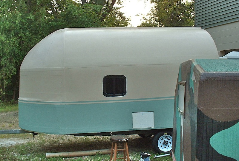

The Power of Paint ...to straighten a crooked window :o ... This is just the first coat , we’ll fine tune the edges as it dries ... Looks good from 50’ eh ??? :thumbsup: :lol:
