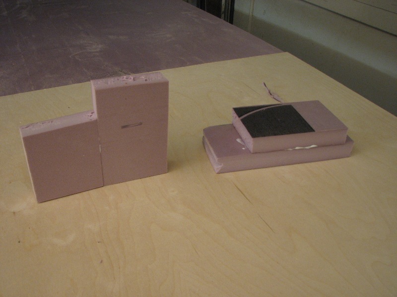

As I stated earlier, I bought the Hotwire Foam Factory starter kit. The first thing I did was glue up some pieces.
Here's photos:
I faced glue and edge glued some trial pieces. I did not clamp either piece.
I didn't use a lot of glue to edge glue it. You might notice in the first photo that I got just a bit of squeeze out. I only glued one side.
Here's what the face glued sample looks like. A bit more liberal and applied to both sides.
After letting the samples dry for 24 hours, I tried to pull them both apart. There was some give at both joints so I didn't pull real hard and left the joints to cure longer.
This evening after getting home from a 5 day road trip, I again tried pulling them apart. No give in the joints and I could not pull apart either joint. I was able to "snap" the edge glued pieces apart. It was the glue that failed. :thinking: :thinking: :thinking:
So, is it poor gluing technique? Not enough glue? One side only? Or is it inferior product? I realize there is also the question of glueable surface area.

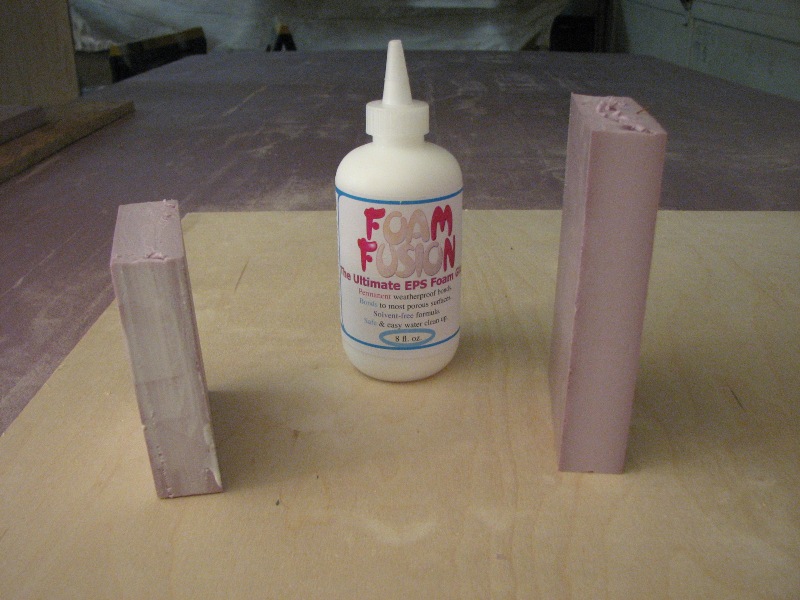

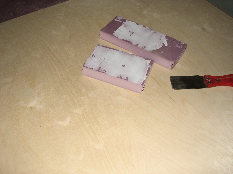

Postby atahoekid » Mon Jul 18, 2011 1:11 am
GG sample is drying, as is another "Foam Fusion" sample. This time the sample is clamped and I used a lot of it. I will get a tube of the loctite 5570 adhesive tomorrow when I head into town and give that a try too. I went to the local hardware store and they wanted way too much for a tube so I'll stop into the big box store when I'm in the city tomorrow.
I also played with the Foam Coat, boost and mesh from Hotwire Factory. It seemed a lot like a newer version of glue and canvas. It's drying now, but seems to be pretty heavy. I put an 1/8" coat of this stuff on to hide the weave of the mesh and was planning on 1 more coat but I don't know.... We'll see if it gets lighter after drying. :thinking: :thinking: :thinking:

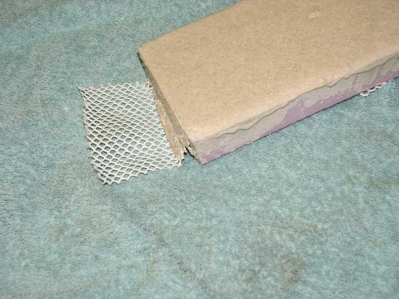

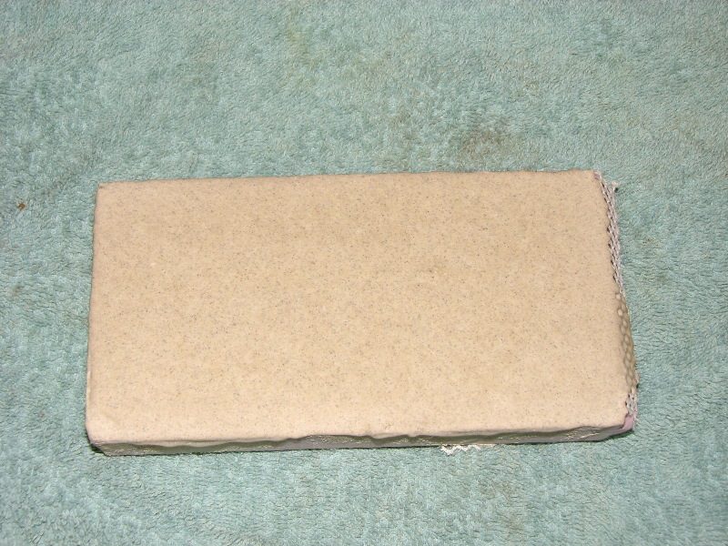

Well I'm pretty impressed with this foam coat stuff. I looked at it after I got home from work tonight and am pretty happy with how the sample turned out. Just as a recap, I took a piece of 1" pink foam board, put on the mesh that they (Hot Wire Foam Factory) sell and covered it with their Foam Coat with the Boost additive. I'm hoping for this coating to make the foam structurally stronger.
My concern last night was that it was going to be heavy. After letting it dry overnight, I discovered that it didn't add too much weight. IMO
Here's a couple pics
This is how it looked after it dried. With the exception of the spot I stuck my finger in while it was drying and some pin holes, it dried pretty smooth and very hard. I tried denting it with my knuckle and just ended up hurting my knuckle. My son thought I put tile on the foam. Can't put a finger nail mark in it. I may try to stick a nail in it after another coat or two. I put on about a 1/4" layer of the stuff. I'll need to figure out how to keep it from running down the sides. Maybe some painters tape? The company says it's almost bullet proof... maybe with enough layers it'll be bear resistant? LOL!
I also tried pulling the mesh off and after pulling REALLY hard, I did manage to pull it off one edge. I used the spare mesh to pull on it. Can't get underneath the coating to pull at the mesh otherwise. I barely covered the mesh along the side (it was more like stuff that spilled over that I spread out) and still had to give it a real good pull. I'm sure now that I got it off, it would be easier to pull it all the way off, but I don't see that as a real world test. Nobody is going to be pulling on any loose mesh (there won't be any) Here's the pic:
