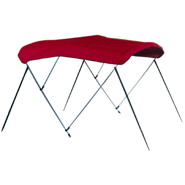

so, noodling around the net; I found a possible solution to both the pop top liner and the pop top lift mechanism. Here's my ideas:
1. Pop Top Mechanism --- a modified bimini set-up. The bimini slides and hardware less the poles can be had for less than $50. The hardware will work with 3/4 pvc or electrical conduit. Two clips on the top should hold it in place. Slides down to shut.
I would mount it inside the canvas/nylon screening for easy set-up.
2. The canvas/nylon part would be sewn as a continuous piece. It would fit inside the pop top, but to the outside edge. To hold it to the top and trailer roof I think I've hit on a perfect solution:
http://www.screentight.com/prod-minitrack.shtml
The screen spline would capture the fabric and the mount would make it easy to install. Not as cheap as the plastic type, but not horrible either.
Other suggestions that might work better? Weight is an issue, so keep that in mind, too.. :)

Postby mezmo » Mon Dec 19, 2011 12:18 am
Hi Bonnie,
That screen mount system seems a good possibility, just remember
to caulk the perimeter where the track will meet the roof, and where
the top track will meet the poptop underside.
And what's a bimini set-up? - for those of us who don't know.

Norm, that airlifter system sure is tempting. But out of my price range. :(
I updated the lift idea with a picture. And I've decided the galley will be built from the Blue Sky Kitchen plans, which I purchased last night. Since I plan on doing most cooking outside, I think a chuckbox type system will meet my needs fabulously. They are light weight, too. Well, until I fill them up with stuff. ;)
