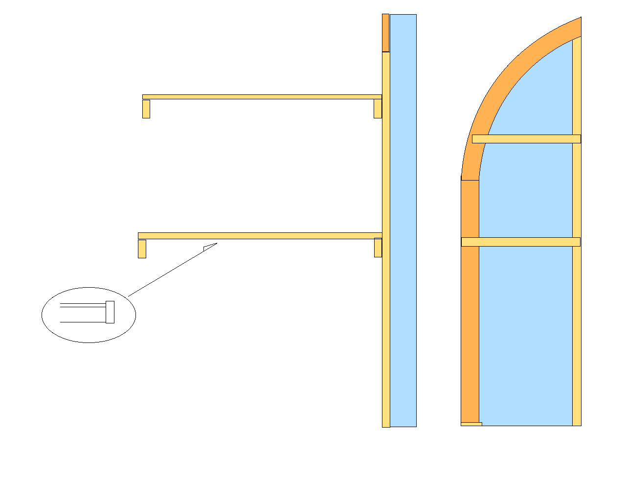

Just for my own reference i made another drawing ... Mini-Galley framing ... The outer part of the foam wall will be covered with a thin fabric ... have to do that first ... The rest is all 1X2s ... and a little plywood ... 1/4” with a simple brace ... Still trying to save weight wherever I can ... all these little things add up quickly ... :o ... Also thinking instead of a drawer , we’ll use one of those pull out wire baskets ... Lighter, easier to clean , and won’t fill up full of junk that we never use ... :roll:

GPW wrote:Just for my own reference i made another drawing ... Mini-Galley framing ... The outer part of the foam wall will be covered with a thin fabric ... have to do that first ... The rest is all 1X2s ... and a little plywood ... 1/4” with a simple brace ... Still trying to save weight wherever I can ... all these little things add up quickly ... :o ... Also thinking instead of a drawer , we’ll use one of those pull out wire baskets ... Lighter, easier to clean , and won’t fill up full of junk that we never use ... :roll:
GPW, I'm with you on using the pull out wire basket. I was actually already planning to use a small wire unit as part of my build. Got the unit waiting upstairs. The unit I have has been around for 15+ years. Originally got it for an apt that looked like it had a big cabinet with lots of storage... until you opened the door to discover there were no shelves & not even a floor. Ack. Have found this unit to be stronger than a wood unit of comparable weight.
However, I also find them harder to keep clean. For me, a solid surface always seems easier to clean than wire units. To get the wire really clean I'd need to dunk the whole basket in water & scrub. And if the need for cleaning is from a spill well... it's wire so that spill just dumped down into a lower drawer & the one below that & on to anything else below. You're talking about just one basket so not such a big deal.
One thing I liked was the ability to put a solid surface on top, like a light, plastic, cutting board. It makes something like a counter extension. Handy when you temporarily need a touch more space.

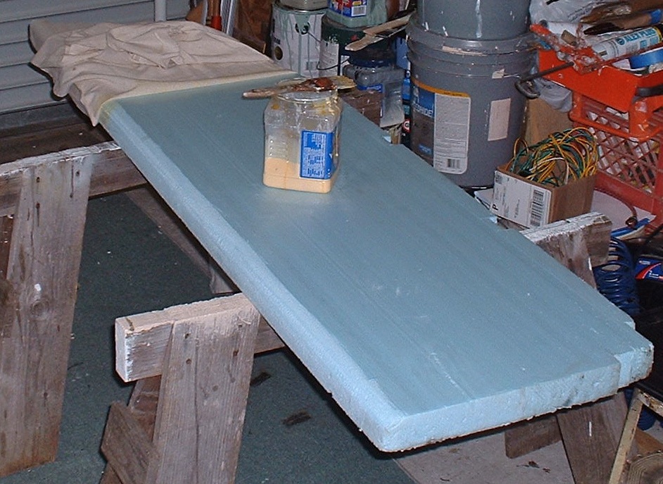

Got the Mini Galley wall covered ... a little sanding/rounding on the edge first for a nicer appearance ... And yes it has a seam .... linen canvas not long enough :oops: But there are seams every where else , so no worries .... While that dries we’ll work on the wiring a bit ... multitasking again ... :roll:

Well, naturally , when we went to to wire up the lights it Poured rain again ... :o So we started working on the MG wall ,canvas dry , so we’re gluing on the main framing strip ... This strip in the front and the rib itself , will serve as an attachment for all the cross braces where the shelves will rest on. (as per drawing ^ ) pretty simple ... utilitarian , nothing fancy at all ... The cross braces on the other side will just attach to the rear wall framing ... again simple ...

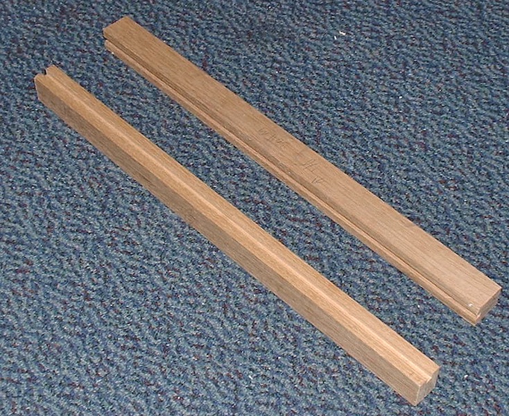

Found the perfect wire basket to fit my 22” X 18” enclosure ... It is a MINI galley ... http://www.homedepot.com/p/ClosetMaid-2 ... gq0dSf8-QK And in the best Salvage tradition, last week we fished two nice slotted pieces of Limba out of the skip at Vinnie’s . A little voice said “ you’re going to need those !” ... :roll: Perfect , with a little trimming, for that wire drawer slides ... :D
