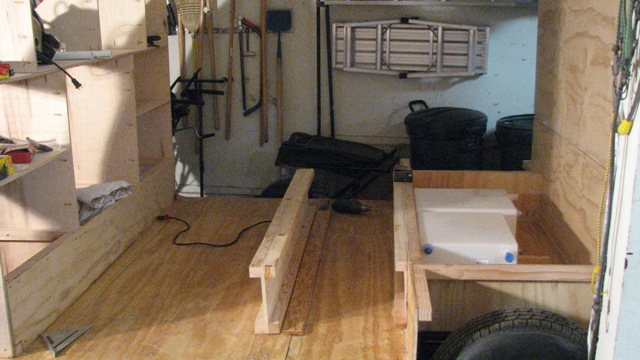

Anyway, here's where I started the week:
I've got all platform supports in and the water tanks are blocked in place. I coated the wood floor with GPW's Magic Mix (4 coats), and mounted the stereo gear in the two upper/outermost compartments of the nose cabinets. It's mounted in but not yet wired in. I'm going to tackle all the electrical at once.

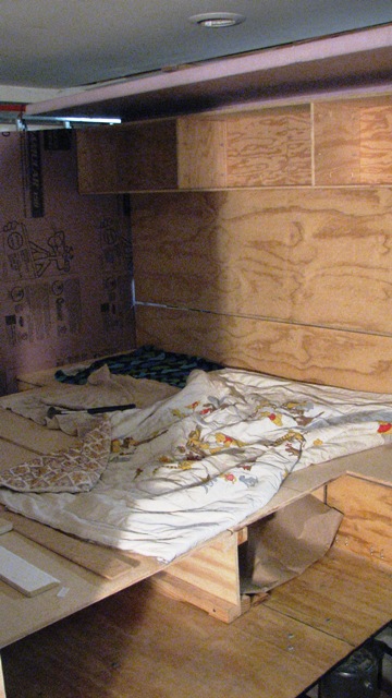

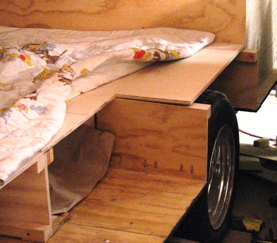

I've now cut the sleep platform out of 1/2" ply and it is now laid on top of the supports. I haven't screwed them down yet, I'm thinking of gluing some 3/4" pink foam to the underside of it for added insulation. The mattress covers virtually the entire platform so adding more foam may be overkill but that's not a new issue for me. I'm also leaving it unfastened so that I can run any wires/hoses/pipes under the platform if I need to. You can also see the under platform storage that will be accessible when the trailer doors are opened. The two storage areas are about 50" x 50". I'm gonna have to work hard to convince my wife that we don't need to stuff it full of stuff. :cry: :worship: :cry: :( :worship:
The brown paper is sitting in one of the two under platform storage compartments and you can now also see the cabinets overhead at the bulkhead. It's just the cabinet box at this point. I won't frame the cabinets or build the doors until the walls are up. I want to make sure the frames are tight against the walls. There will be a headboard right underneath the cabinet against that wall. It will also provide a little added support to that bulkhead wall and it also hides that horizontal seam in the plywood.

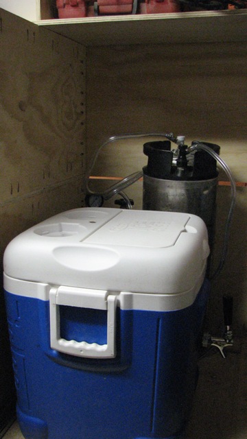

I also put together the most important part of the whole build. I bought and assembled all the components for the jockey box. I am now officially able to carry beer on board (hence the name "Road Foamie"). It may not be 500# of beer, but I really don't need the added weight. It should last me for a week of camping. I'll even share!! I'll carry an additional keg in the bed of the truck if I think I'll be gone longer or I think there will be lots of friends to share with. I still need to build a platform for all of it and an insulated "Ice Box" for the keg but the system works just fine! :beer: :beer: :beer:

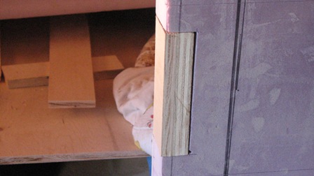

As I said in the previous post, the door cut when fine. But I created a problem later on. I decided that I should trim down the door so it would fit better in the opening. Got carried away and the door is now too small. :x :x :x I was a bit worried about the strength of the door and having enough bite for the door handle and hinges so I decided to build doors from scratch. I may now have gotten carried away.

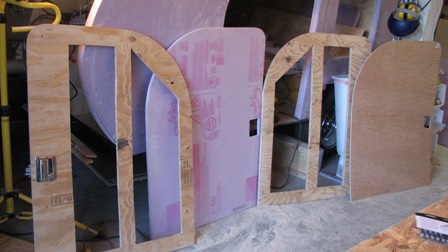

Here are the 4 parts for the doors:
From left to right, 1/2" plywood panel, 3/4" exterior foam skin, 3/4" plywood panel, 5mm luaun interior skin

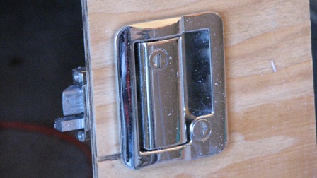

Here's a close up of the door latch
It's a pretty hefty lock. I needed 1 1/4" thickness to set the latch into that's why 2 different thicknesses of ply. D'ya like the little flecks of pink foam?

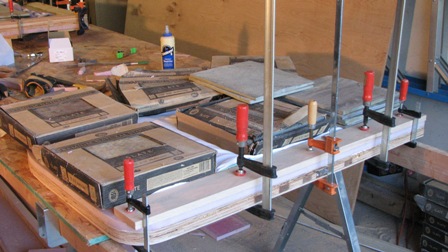

Here's glue up number one:
Here's the glue up. That's almost all of the clamps I own.

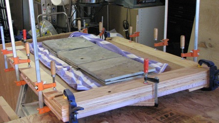

Here's glue up number two:
Here's the rest of the clamps I own. The rest is held down by boxes of slate tile, which is a painful reminder of the next home improvement project on the list. So far this spring, "She who must be obeyed" is tolerant of my work on the Road Foamie. She wants to go camping. She had grand hopes of taking it to Yosemite this spring but I tell her "A one man army can only work so fast" :R :R

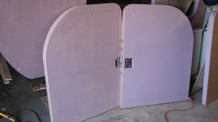

Here are the doors "complete":
The edges of the foam will need to be rounded off and the entire door shaved down to allow for clearance when opening and closing the door but I will work very slowly this time. I do not want to make up another set of doors!! :NC :NC
Here's the hard point for the door hinges:
It's only jammed in place for right now, but I will epoxy it in place shortly and it will receive two layers of fiberglass for reinforcement. That door is pretty heavy and I don't want it to rip the hard points out. The hard points are two pieces of 3/4" ply glued together.

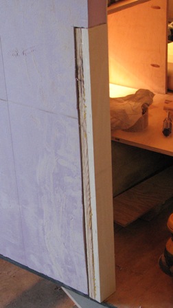

Here's the hard point for the door latch:
This too is just stuck in place for now and will receive the same treatment as the hinge side hard point
