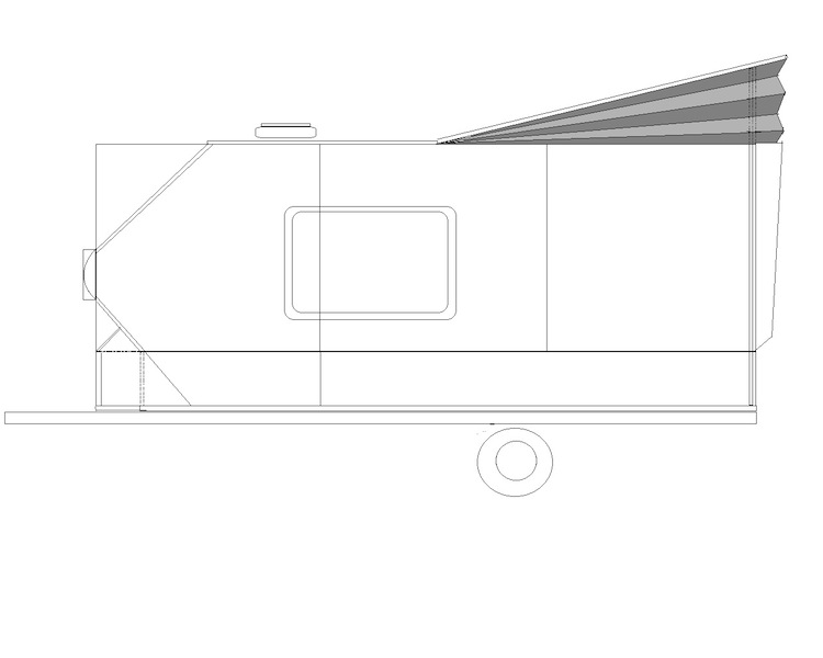

Postby Ned B » Sat Oct 26, 2013 6:12 pm
First sketch... bed up front... space for cabinet in the middle, then 'kitchen' shelving. approximate placement of side door, and lifting roof section.
I'll be refining the outline as we go, this is just the start up.
The nose will be tapered a bit towards the center, from the sides as well as the 'point' you see there. The section just below the nose cone will be for battery/charger storage, OR I might make that where the EZ-Up lives. loads of 'planning time' yet to go.

Postby Ned B » Sat Oct 26, 2013 8:41 pm
Looking 'left'...
and from the tail... folding rear wall

Postby GPW » Sun Oct 27, 2013 6:27 am
Ned, that’s a great start ... :thumbsup: I’d suggest taking actual measurements of everything inside , or even better , lay out the actual inside components on the floor arranged like you want ... Try moving around , doing things in that space ... see how you (and the Mrs. ) like it ...think what you’d do differently . :thinking: Best get all this out of the way before committing to a design ... I didn’t do that on my first Foamie and it ended up being big enough for only me ... :o (too small) :duh:
Re: Hybrid Foamie: Wild Wanderer in Foam- Design coming toge
Postby GPW » Sun Oct 27, 2013 6:54 am
Just a Camera thing .... how about some bellows ? :thinking: Lots easier than moving the walls too ... :roll:
Postby Ned B » Sun Oct 27, 2013 9:01 pm
I do like the simpler lifting roof section in the tail. think I'll stick with simple panels though, vs the bellows. And I'll be working a lot of things out with Lori long before I get around to doing assembly.

Postby GPW » Sun Oct 27, 2013 9:13 pm
Just an idea ... :roll:
Postby Ned B » Sun Oct 27, 2013 9:24 pm
And I appreciate it! I know my limits & that bellows is a bit more than I want to attempt.

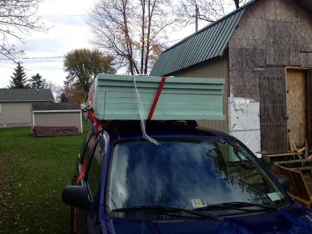

Postby Ned B » Sun Nov 03, 2013 11:01 am
8 sheets @ $32 ea plus tax

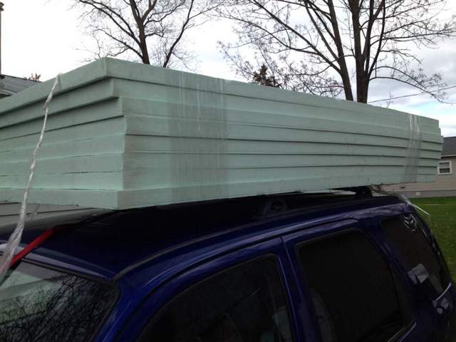

Postby Ned B » Sun Nov 03, 2013 11:36 am

Postby atahoekid » Sun Nov 03, 2013 12:15 pm
isn't it nice to know that the stack of foam on your cartop represents the walls and the weight of a large portion of your shell? compare that to the same number of plywood sheets if you're building conventionally.
