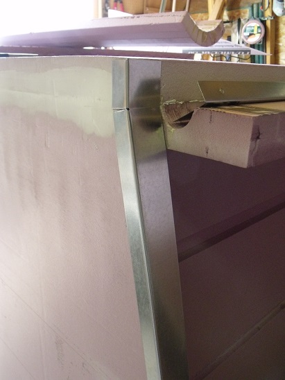

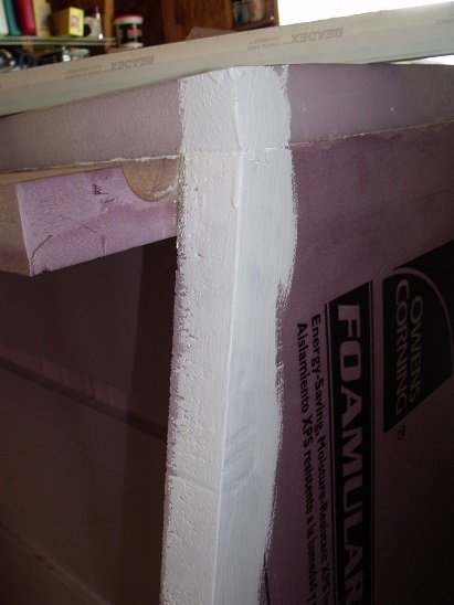

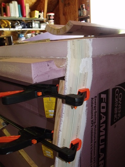

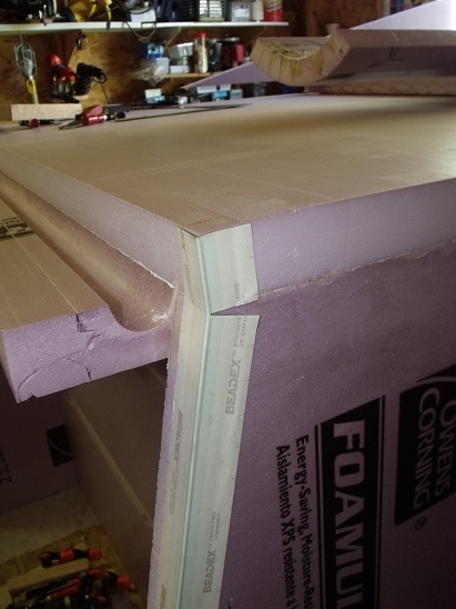

So after removing the flashing I decided that it was maybe a bit of a overkill for that area. I wanted something a little lighter and a bit easier to work with. I found this dry wall edging that has a metal edge, but has paper attached that goes over the metal and extends on each side about a inch.
Edge protector
DSCF2104 small.jpg (112.35 KiB) Viewed 1759 times
The paper gives the Gripper something to attach too and also it is porous so that the Gripper will dry much better.
Ready to glue
DSCF2109 small.jpg (103.62 KiB) Viewed 1759 times
This was more like what I wanted. I painted the area on the foam that It was going to attach to and also the back side of the edging. Went on real nice.
Clamped
DSCF2110 small.jpg (122.77 KiB) Viewed 1759 times
This makes for a nice smooth edge. I will probably use this along the top/front edge/hatch edge so I will not have to spend hours sanding and making sure everything is square. Also, I think it will make a nice crisp line that the canvas will wrap over.

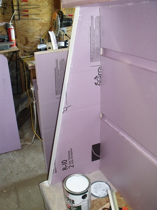

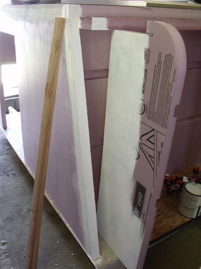

Time to attach a galley inner wall to the outer wall. Got the Gripper out and painted both sides that will come in contact with each other.
Getting ready
DSCF2105 small.jpg (179.21 KiB) Viewed 1757 times
Like discussed a bit earlier it seems the Gripper grips better if it is allowed to set up a bit before attaching the parts together.
Gripper setting up
DSCF2106 small.jpg (114.95 KiB) Viewed 1757 times
Outer and inner galley walls are now one.... :thumbsup:

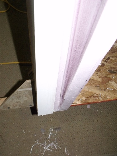

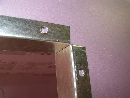

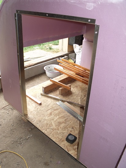

Playing some with the flashing around the door. Here is some shots.
Outside
DSCF2115 small.jpg (128.24 KiB) Viewed 1680 times
I made it all one piece instead of the three separate pieces I had planed. Had to go with square corners instead of the rounded like originally planed.

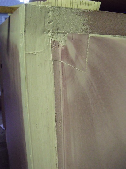

Corner
DSCF2116 small.jpg (103.4 KiB) Viewed 1680 times
Inside
DSCF2117 small.jpg (146 KiB) Viewed 1680 times
George.

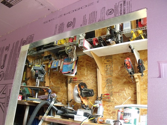

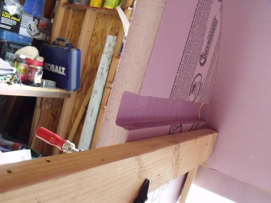

I did few things this long weekend with the foamie.
I had to extend my shelf cuts inside so that I can slide the shelves in from the door side. I was going to install the shelves first and then the roof, but it got mixed up a bit. I was not sure how wide I was going to go with the shelves with the door trim and all that. Being able to install from the door will let me set everything up before the cuts.
Full cut
DSCF2119 small.jpg (104.49 KiB) Viewed 1602 times
The hatch fit pretty tight. I could get it off and on OK, but I did not like the fact that there was zero clearance between the hatch inner wall and the galley outer wall. Since I was planning to canvas this area too I figured I better get some extra clearance there. Also, this will allow the water to have a place to flow through, if any gets in.

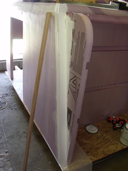

Hatch cut
DSCF2120 small.jpg (106 KiB) Viewed 1602 times
Took me a bit to figure out how I was going to cut that big a piece without making too much of a mess. Yup, came down to another hot wire cut. Came out pretty good.
