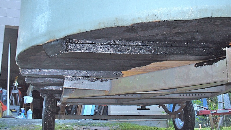

Well, got about 1/3 done on the underside .. took a break and never went back ... didn’t want to “over do it” in the Heat (old people) .. there’s always tomorrow ... Schmaybe’ ??? :roll:
They don’t call it Nasty stuff for nothing ... !!! :R Eccch !!! :frightened:

Back at it again this AM ... working while it’s still fairly cool ... 8)

Got everything done around all the sides and front and back ... just the 3 large center sections to do ... :frightened:
NOTE: Just a lesson from experience... if you’re going to use the Black Nasty Stuff on the bottom of the trailer floor .... It’s BEST to paint all that on BEFORE you bolt it down ...That way you can lay the flooring out on horses flat and just trowel it on ... MUCH Easier than lying on your back under the trailer , painting overhead (ouch!) , crickets and frogs hopping on you , wasps buzzing you while you try to glop this stuff on ... Nasty business!!! :R .... I’m temped to get some spray can undercoating to finish up the rest ... :roll:

Postby Wobbly Wheels » Sun Sep 01, 2013 12:14 pm
Might not be a bad idea anyway if the wood that's against the frame isn't undercoated. At least that way, you can really build it up in the corners where the frame meets the wood.

Postby GPW » Sun Sep 01, 2013 2:07 pm
I think you’re right !!! Even though it is Good PT wood that we selected specially for the X-members (clear, no knots , etc. ) It can’t hurt to spray it all over ... the wife even thinks spraying would be easier ... on me ... :thinking:
I’m thinking about a mini-skirt of sorts , just a trim piece of flashing or something so the water rolls down the body and off ... now it’s rolling under the rounded lip ... :roll:

Maybe some of that drywall corner bead - either the metal or the
plastic or paper combo [however it comes] [like tac422 used in
The Big Pink thread: http://tnttt.com/viewtopic.php?f=55&t=56441
applied at that bottom edge [glue on, then paint over ?] would have
enough of a surface break at its little corner edge round to allow
the water to break the surface tension and drip there ?

mezmo wrote:Maybe some of that drywall corner bead - either the metal or the
plastic or paper combo.
Might take a look at flashing too. I am using 2"x3" flashing along the bottom edge. The pink foam tappers near the long edges some. When the foam is glued to the floor the bulk of the foam is 2" thick, but tapers down as much as 1/4" at the edges. Took me a bit to figure out what was going on with other measurements as well. This can be worked around because the tapper is only on one side, probably the side that they cut if from. By time I figured out this tapper I had already glued the sides to the bulkhead so I had to work around the tapper since one side faced outward and the other inward. This made the tapper inside on one side and outside on the other. :roll: I was going to use the paper covered beading along the bottom edge, but it did not come up high enough to cover the tapered part of the foam, which is about 1 1/2" up the side. I was already going to use the 2"x3" flashing along the front to help support/hold the foam overhang so I figured I would just continue along the sides. I am drilling holes into the flashing along the bottom and then using Great Stuff on the L part that comes in contact with the bottom of the trailer. Then I am painting the side of the trailer up as high as the flashing will go with Gripper. Then I paint the L part that comes in contact with sides with Gripper. Place the Flashing where I want it and screw it into place. Seems to be working great. The GS foam fills in the void and the Gripper glues the edge nicely. I do not use GS on the wall sides because I am afraid that the foam will push it away form the wall.

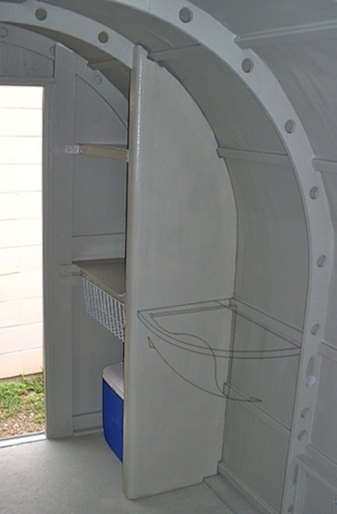

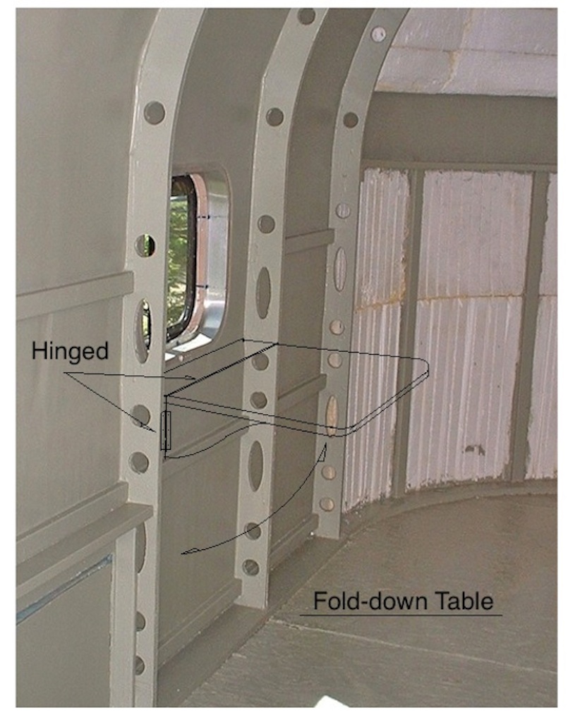

The wife mentioned buying a folding table :o ... we had originally thought of a fold up table , but the way things laid out that would now be “impractical” due to the window placement ... but a fold -Down table works ... Kinda’ makes more sense anyway huh ? ... :thinking:
So we made another drawing , just to visualize things out ... :hammerhead:
Ps. since the hinge line is boxed in between the two ribs , the table could be a lot wider , extending beyond the ribs on each end ...within reason of course ... Or, it could even span Two ribs for a Long table ... ~ 24” X 48” ... :thinking:

Postby GPW » Tue Sep 03, 2013 10:20 am
Which will probably work for the fold-down desk/utility table too .. :thinking: ... still room for the clock on the wall ... :D

Postby Wolffarmer » Tue Sep 03, 2013 4:20 pm
That is how I made my tables on the back doors of my teardrop. You could build a table to span one set of ribs. A table that spans two sets of ribs. Or two side by side tables and use one or both as the urge hits you.
Would be a bit more building doing two. But what else you have to do as you watch the weather reports? :lol:
