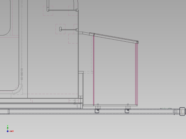

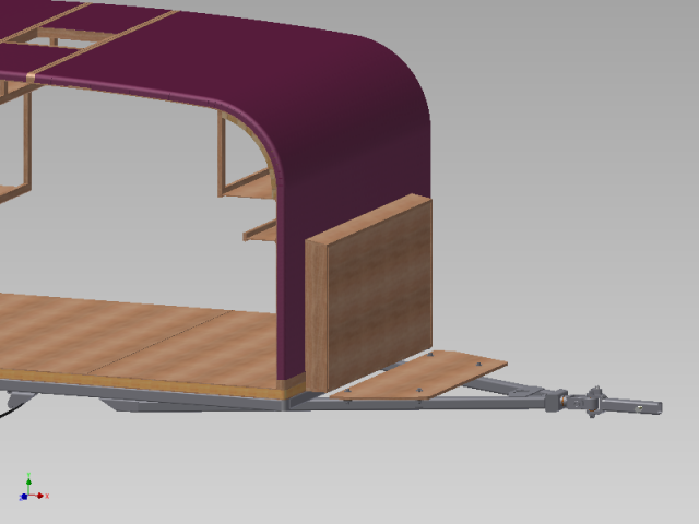

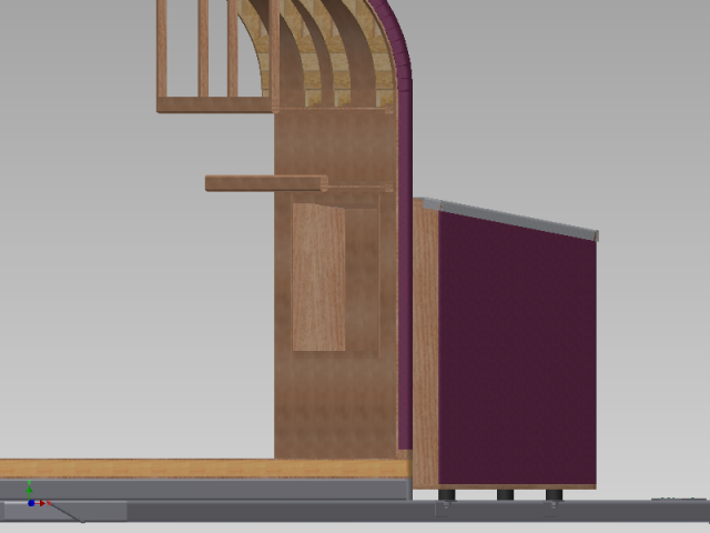

Here are some images of the original front locker and TB design to show what I was trying to describe. Actually, this is the second design iteration where I had raised the floor of the box by an inch to allow for the rubber isolation mounts.
This is looking up at the curb side bottom of the box.
And this shows the interior of the front wall (side wall visibility turned off) showing the locker space under the key catcher shelf. It will get a door eventually.
This is a wire frame view looking thru from the curb side.
The original plan was to have the side vertical planks of the locker (the backwards ‘F’ shape with the water shedding angle on top and the opening of the ‘F’ representing the locker section) extend down to form the lower rear part of the TB.
Now I think I will make the lower part of the ‘F’ be part of the locker down inside the wall “behind” our pillows and just shorten the rear portion of the TB to a straight vertical panel. It looks like the truncated TB will still land on the rear mounting tabs so I think I can make it work.
