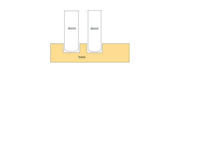

i want to put in sliding doors in my, so how should i go about that? before you ask, yes please, pics would be nice. i would like to figure something out that i can rig up, instead of buying.

Sliding doors ??? on what ??? Making them slide is easy ... cutting the slots is tough (not really ) Hubby have a table saw with a Dado blade... ? Could use Aluminum channels , but you'd have to buy those ... :roll:

on the "bunk bed" top i want to put sliding doors to the front inside the tear. that bunk bed area is going to be inside storage. clothes, towels, that sort of thing.
i want to build a wall to close off the back when the hatch is open. i might not use the whole flat top space, might keep some of it for the galley stuff.
maybe the easiest thing to do would be just buy a hinge.

Postby GPW » Thu Jun 16, 2011 7:45 am
Does this help ? Image
Postby eaglesdare » Thu Jun 16, 2011 7:49 am
actually it does help! very much so. i could just route out the tracks in a foam piece. then just use the foam panels as the doors. i told you i am a visual ole gal. that would work!
now if only i could find a bit. i have found the routers, but not any bits.

Postby GPW » Thu Jun 16, 2011 8:03 am
It may be better to use wood for the bases... You'll need one for the top and the bottom... Beeswax (or a crayon ) in the grooves helps with the sliding ...
Routers are pretty useless without a bit ... :roll: :lol: they are expensive too ... :o And then you need to make/use some type of guide to ensure straight cuts ... You could make the bases by gluing up strips , but you'd still need to cut them accurately ... Tool Time !!! ;)
Postby Wolffarmer » Thu Jun 16, 2011 8:18 am
Make the groves in the top twice as deep as the bottom. and the panel the size of the opening + the depth of the bottom groves. Well maybe a tiny bit less just to be sure they work. But I bet you already figured this out.
I have some 1/2 inch foam that would make nice doors.
