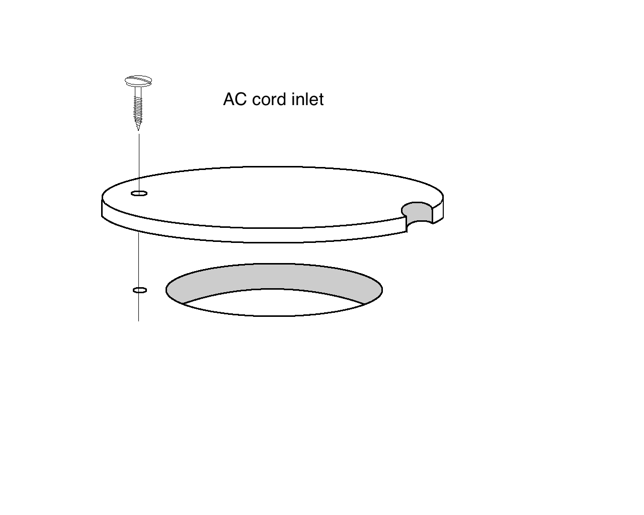

Thinking practically , I have to have a way for the AC power to get into the trailer ... thinking of a small hole in the floor and a flap hatch ... the hole big enough to allow the connector through , and the flap with a hole in it just big enough for the wire, keeping the bugs out ... The flap part , bigger than the hole in the floor, so it could be moved sideways to completely cover the hole when not in use . Just trying to keep it simple and thrifty ... :thinking: (see drawing)
My “electrical system" , so far, is a 50’ outdoor extension cord , a GFI box (yet to be acquired /made ) , and a "6-way” outlet ... Pretty Simple eh ! If I need power up in the front , we can run the extension cords through the holes in the ribs .. along with the rope lights (Thanks Ned! ) 8)

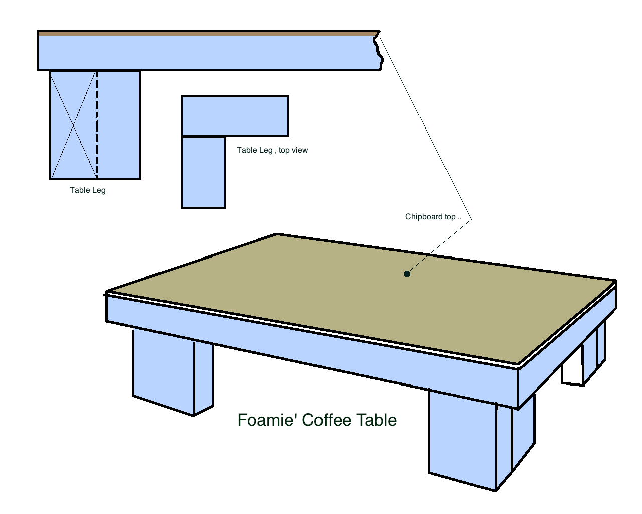

And naturally a Foamie’ trailer deserves a Foamie’ Coffee table ... :thinking: Easy to decorate (torn paper finish ? ) , LIGHT, strong enough for the above ^ items , but Not strong enough for Flamenco dancing on it .. :dancing ( No Jose’ Greco imitations) O’le!! :lol: :lol: :lol: http://www.youtube.com/watch?v=wL2fRBv4GxY

Electrical in - Get one of those metal or hard plastic outdoor outlet boxes with weatherproof the flaps on the outside. Mount it under the corner of choice of the floor with just a caulked hole drilled in the floor for an AC cable to come in through. Run that cable to a standard outlet box on one of the ribs and VOILA! You have shake proof, loss proof and water proof electrical connections for plug in to somebody's wall socket. You can either spend the extra money for a male socket for the under floor box or just make your own short extension cord with two male ends. Just make sure to always plug the trailer end in first as those pins will be live when the shore side power is plugged in. Not up to code, but it works. I've found that RV places will rape you for the male wall sockets but the big box stores can order one for you if they don't have them on the shelves.
And while you're at it why not just run a length of conduit along under the floor and do the hole in the floor thang up front so you have a prettified indoor outlet up there too. You've got a better than factory look going now. Why spoil it with extension cords running along the wall? Although I do remember that in my youth in the south we did have a freezer on the back porch.

Jack B. wrote: You can either spend the extra money for a male socket for the under floor box or just make your own short extension cord with two male ends. Just make sure to always plug the trailer end in first as those pins will be live when the shore side power is plugged in. Not up to code, but it works.
[b][i]Peace, love, dove.
Jack
That is called a "Dead Mans Cord" for a reason. You can become dead real quick. I believe these cords are illegal in some areas because they are so dangerous not only to you, but others who could be working on the lines somewhere else.
