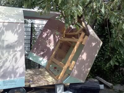

First, a "D'Oh!" story I have to share...

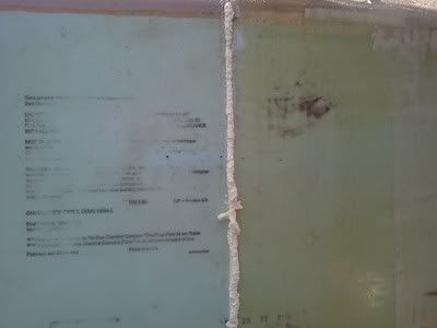

When I put the forms in, I screwed them to the floor. I didn't tie them together and, once the three back panels were glassed, all the weight cantilevered out behind the form caused this:
All fixed now, but it's one of those things that seems obvious...after it happens.
So now that the back panel and the two rear corners are glassed, it's time to glass them together into a single solid cap. If I had more space to work, I would probably lay out all three on the ground and glass them as a unit like that, but the only space I can use that's big enough has a trailer sitting on it...

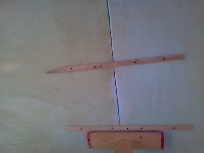

So with the panels screwed back onto the newly-adjusted forms, I screwed on some strips of 1/4" ply to hold the edges together while I shape and glue them.
Then I used a thin bladed pull saw to open up the gap a little bit to allow the foam to expand, added the foam and let it do its thing. It's been sanded smooth (no pic, but it still happened :) and the outside will get taped this afternoon.
While that was setting up, I glassed the next side panel in the sequence. There are only two side panels left to glass, plus the roof. Then the rest of the glassing gets done on the trailer rather than on the table.

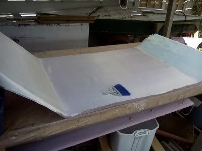

Here's a pic that shows the effect of UV on epoxy.
The panel on the right has been sitting in the sun all summer without a tarp over it. The one on the left is a fresh layup. All the materials used are the same for both. The layup is still sound, but I will keep it covered from now on so it doesn't get any worse and start to deteriorate. From here it will begin to get brittle and delaminate, breaking off on little pieces and then turning chalky.
It's not there yet, so I'm going to soldier on rather than replace it - there will be another layer going on over the outside, followed soon after by fairing compound, then primer. In the meantime, I'll keep it tarped so it doesn't get any worse.

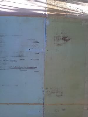

Yup, it's canned foam. Unlike you guys who are wrapping with canvas, most of the strength in my shell will come from the inner and outer layers of glass, so the foam is there mainly to hold the two a fixed distance apart. I don't need that joint to support the shell's weight, so it doesn't make sense for me to spend the extra on GG where it won't be needed.
Using the canned foam just replaces the foam removed by cutting the panels apart, rather than providing strength to the rejoined panels. That said, it is still a pretty good bond based on the panels I tested it on.
This is the same joint with the foam joint sanded:

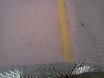

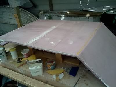

Then I mixed a batch of putty and applied it to seal the pores in the foam and level any remaining imperfections. The mix I'm using is about 10% cabosil (West 403) and the rest in microballoons. I use the same mix for a lightweight adhesive as well, hence the fibers. I'm putting it on and laying up glass over it while it's wet, so the harder-to-sand 403 in the mix isn't an issue because I won't have to sand it. On the plus side, it gives me a bit more bond strength as an adhesive.
Next was a single layer of 2" tape, cut from scrap material, then a layer of 10" tape cut over that. This is how it sits now with the epoxy working its chemical magic:
