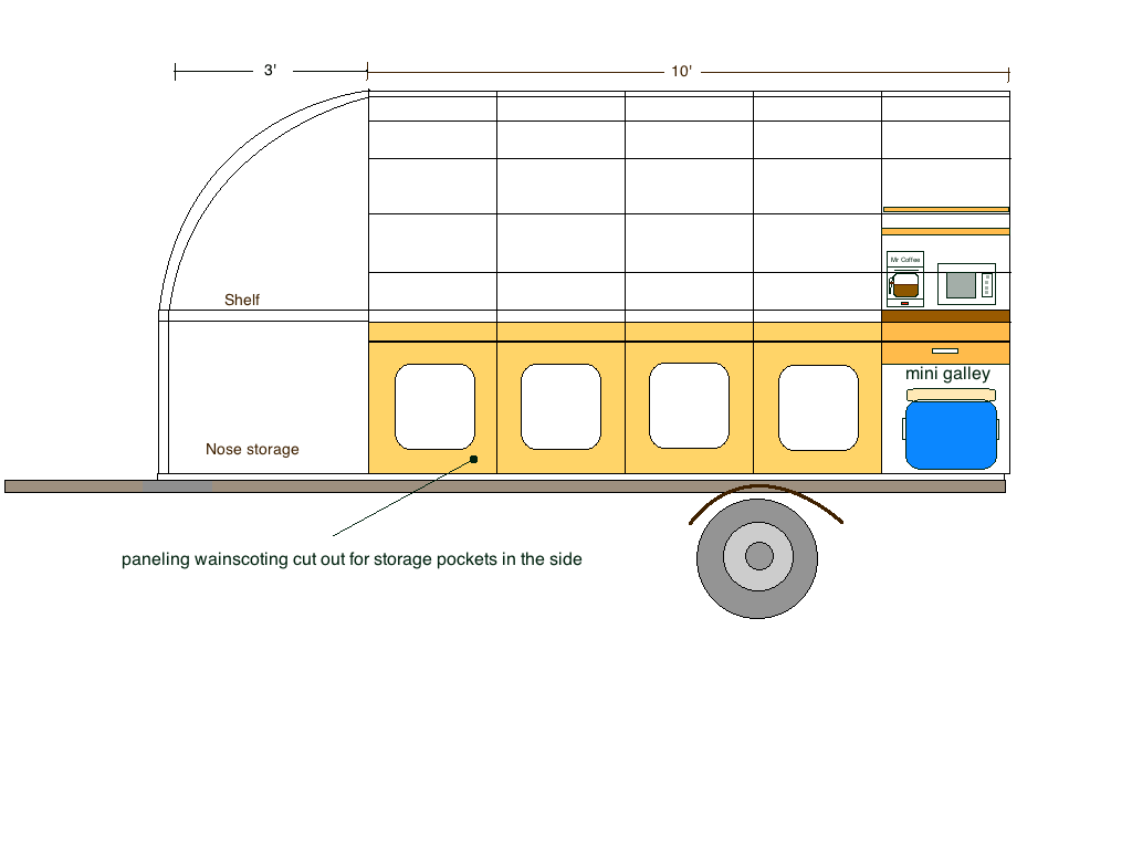

Postby GPW » Fri Sep 21, 2012 4:45 pm
Another drawing , showing the wainscoting inside cut away to form storage pockets in the sides ...
This is the FS scaled to fit my new trailer ... unless I can cheat another foot or two in length ... :thinking:

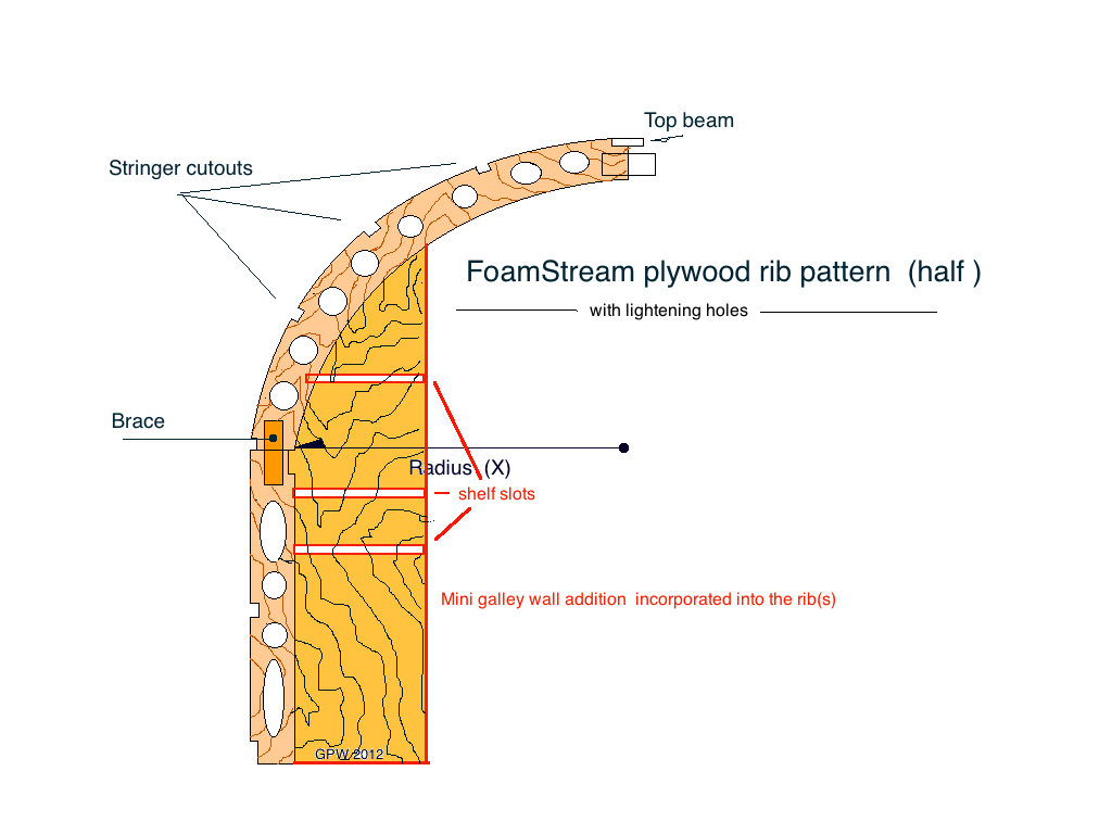

And another thought ... with the CNC doing the cutting it would be easy to make the last two rear ribs with walls in it , and pre slotted for slide in shelves/drawer for the mini galley ... :thinking:

Postby mezmo » Sat Sep 22, 2012 8:42 pm
The wider ribs where needed as combined structure/cabinet sides is a good idea.
Here's an example of someone who did so:
98124
98125
98126
Just be sure to allow the same plywood thickness/length, between the end of the shelf slots and the edge of
the wider plywood rib, that you are using with all the weight-saver cutouts, for structural integrity. [Maybe
as drawn it was just a fast jot down of the idea - not the actual design ?] At least an inch or two. The slots
may not be necessary if you just use 1x strips applied to the ribs as supports for whatever shelving you use.

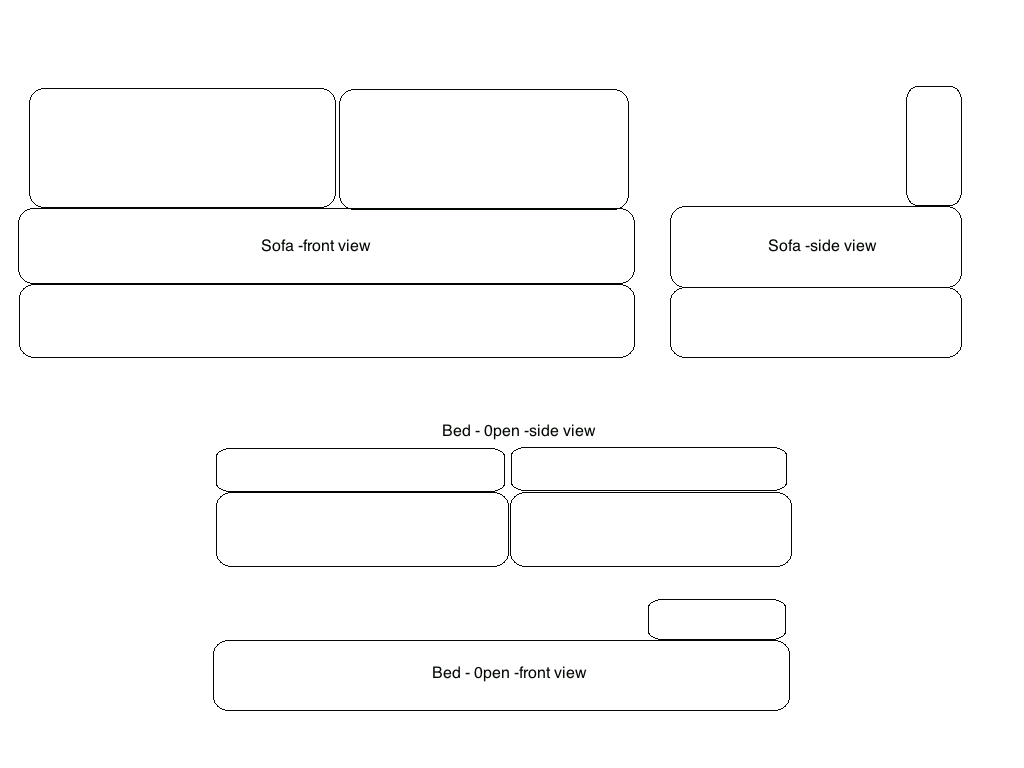

As far as the bed goes, have you considered using the 3ft space of the front shelf
by mounting the bed longitudinally [front to back] and using the bottom end of the bed as
the daytime couch bottom and have a support for couch back cushions for daytime use ?
Drawers under the bed/seat base would be the most useful way to access and use that storage space.
A futon like frame wouldn't allow for any/much storage and in a small area wouldn't be an efficient
use of space.
This drawing shows such a setup. If you look at the side view part there is a faint line
drawing of a back cushion, thus making the 'bottom' half of the bed the couch's 'bottom'.
[Click on pic for larger size, use "Ctl+" to increase that if needed.]
90556
The 3ft space as a 'shelf' is sort of a dead area, if used as part of the bed [at least 2ft
of it] it uses the space/volume a bit better.

Postby GPW » Sun Sep 23, 2012 4:26 am
Norm , my drawings are not mechanical drawings , just an expression of an idea ... I do understand your concerns. Thanks !!!:thumbsup:
The front area , while looking like wasted space has already been planned for .. ;)
The futon bed suits my needs just fine ... Everyone has there own ideas and should apply the information to their particular situation ... My main concern right now is the trailer shell itself ... once we get that done , I’m sure there is enough flexibility in the design to make changes on the interior... all these projects need some decision making/calculations by the owners to better suit their individual preferences , so nothing is really written in stone ...
