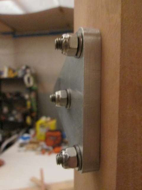

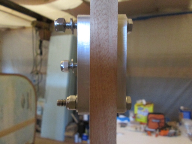

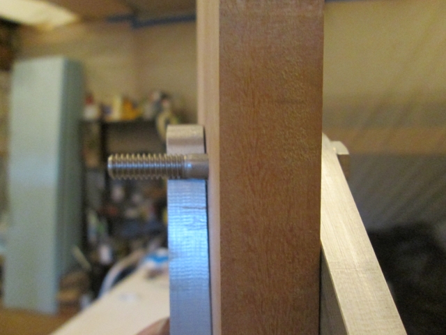

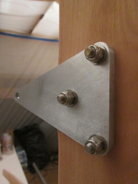

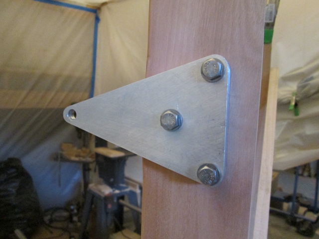

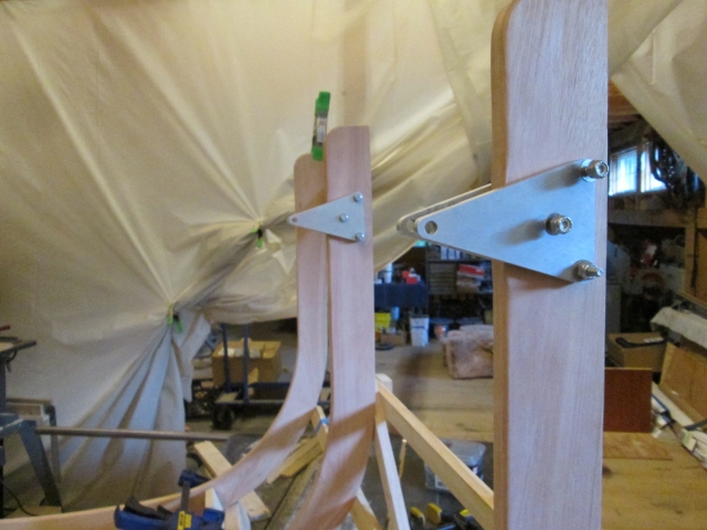

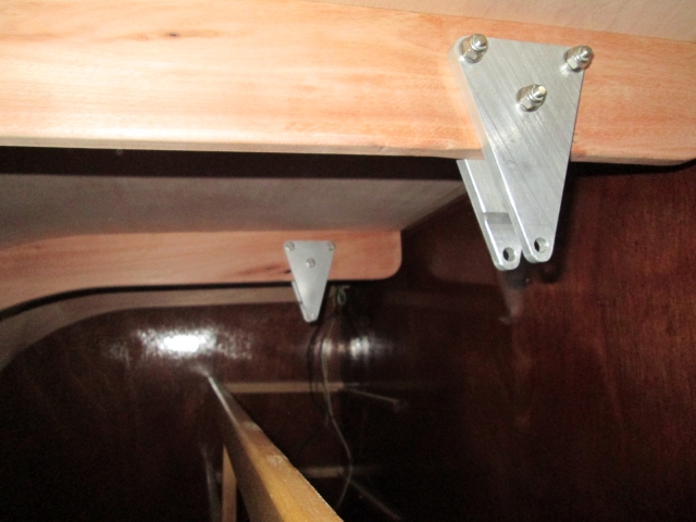

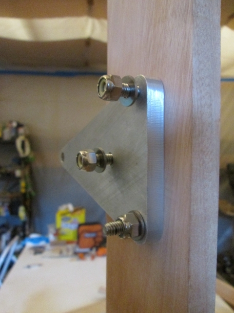

On Monday I fit the upper hatch actuator brackets.
If you look at the threads protruding on the lower bolt (the one where the self-locking nut is drawn up snug) you can see that there are about 5 full threads protruding. Two (2) to five (5) threads protruding is the government spec we used in submarines, but I much prefer being closer to two; less chance of snagging and less gangly looking. Look close and you can see a black Sharpie mark at about the 2nd thread.
I went out of my way to order 2-1/4 inch long bolts (hardware store only had 2 or 2-1/2 long). This way the shanks of the bolts go well into the second bracket. With the holes in the brackets and wood sized one-for-one to the bolt shank, everything is a tight fit.
After sanding the bolt lengths back and re-chamfering them on the Bader, I used a little of the paste wax (bought for the CI table saw top) to lube the bolt threads; dry stainless on stainless is a recipe for new alloys called “seizium” and “gaulium”.
Really sharp eyed followers will also note that the washers are faced wrong for now. Flat washers are die stamped out from sheet and the stamping process coins the washer slightly leaving rounded edges on one side and sharper edges on the other. I always make a habit of facing my flat washers coined side out. My theory is that this adds a tad bit of spring in the joint, kind of like a split lock washer, and presents a smoother finished surface to the outside. However, until I decide on the final finish for the brackets, I didn’t want the washers to dig in, so I turned them out. (Too much detail?)

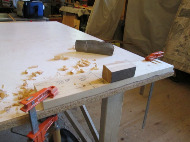

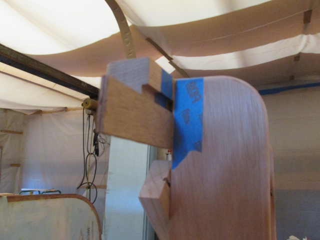

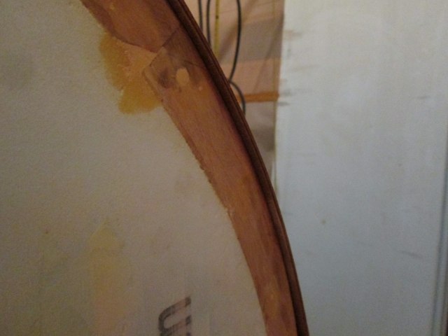

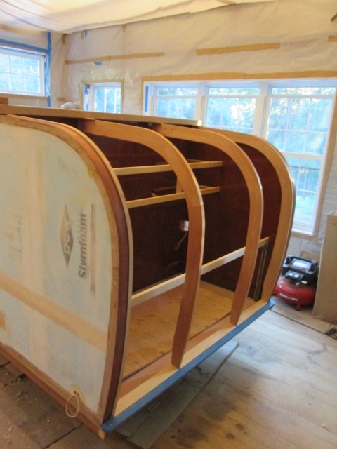

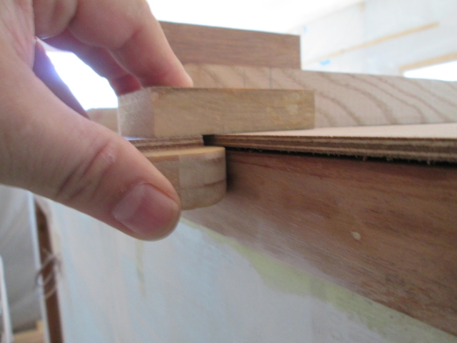

Tonight I worked on the upper hatch spar. The rabbet I had cut for the hatch skin to slip under was a tad on the deep side and I wasn’t sure that it would be snug enough for a good glue bond on both sides (simultaneously between the spar and skin, and the ribs and skin), so I used a scrap of the 5 mm, and planned and sanded until the skin was a nice slip fit; almost flush. This is the before pic.
Here I have masked around the top ends of the ribs and the adjacent areas of the spar, and glued the spar to the rib tips. The little scrap is just barely pinched. I only used the front screws (top) for now so that the other one wouldn’t twist the spar onto the rabbet.
Contemplated a few details on how I am going to skin the hatch. I will need to dry fit the top edge of the ply to the spar rabbet to make sure that it is a nice tight joint while the sides of the panel are even with the sides of the walls. Also, to get a nice tight joint at the lower spar (unless I decide to cut a groove in it) I may have to trim the panels to final length by matching the butt joint at the middle of the panel. Not sure if that is the best method.

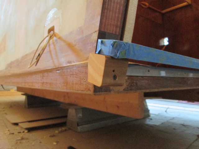

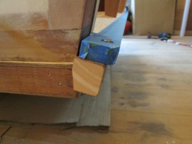

On Friday (9/19) I got the hatch frame screwed onto the back of the cabin, anchored into position for the skinning operation.
In order to be able to screw the frame to the galley and still be able to unscrew it after skinning, I used the extra screw holes down thru the ends of the hinge spar at the top, and made a pair of cleats, simulating the future lower edge of the hatch, at the bottom. This way I could run screws thru the temporary cleats and not the permanent piece.
Here I have screwed up thru a scrap of 1x4 into a small chunk of 2x4. The 1x4 allowed me to clamp this small piece to the bench while leaving room between the clamps for the block plane.
A little trial and error and I had the cleat fitting nicely. Next I cut it into two blocks, one for each side. The holes thru the top of the lower hatch spar (wrapped in blue tape) will be used again when the permanent shaped piece gets attached (later), and will eventually get covered with foam anyway. That just leaves one screw hole on each side into the back of the floor to be filled later.
So that was my short goal for the day before going home to pack for the trip; got the hatch frame secured in the galley.

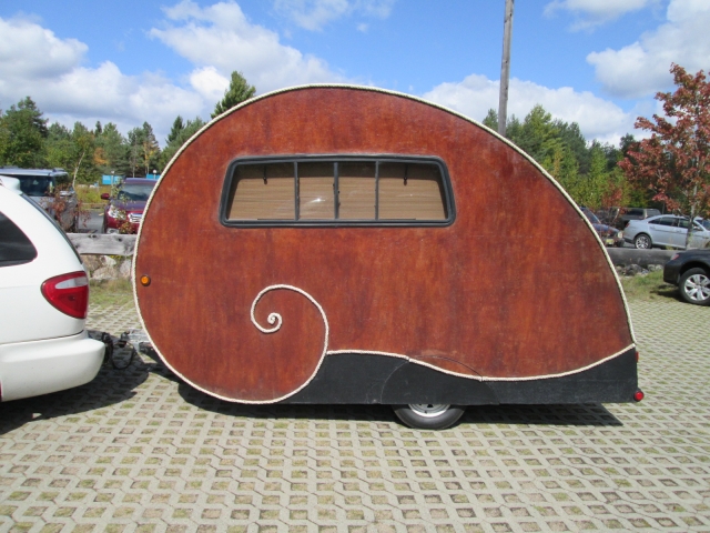

Had a great trip; still too many pics to wade thru, but I like this one of the start of the fall colors while walking thru the woods at Mt Severance, NY.

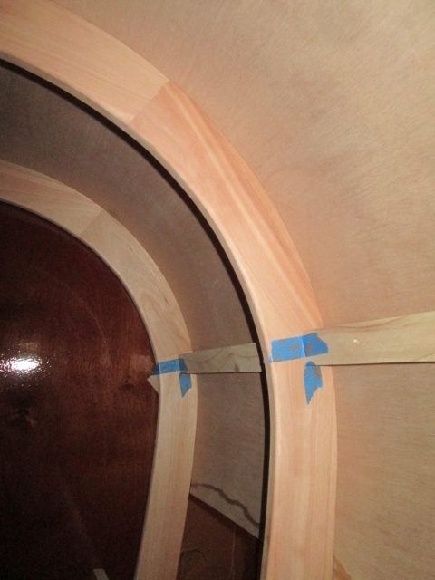

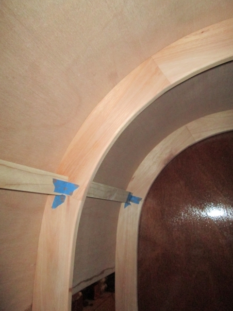

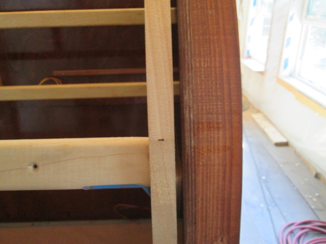

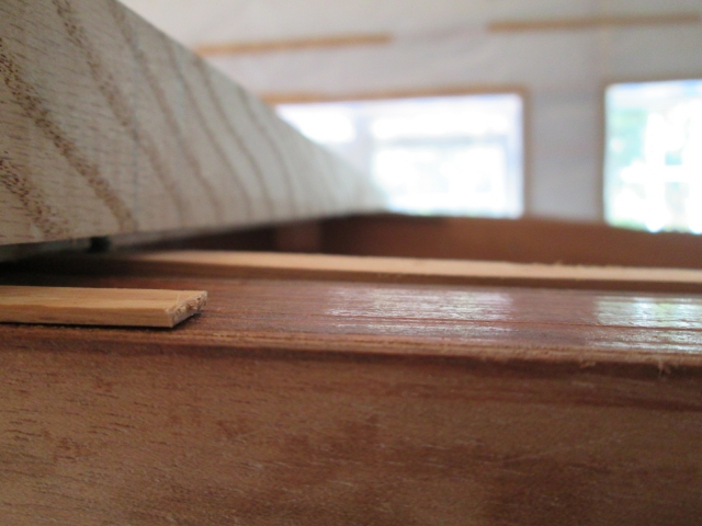

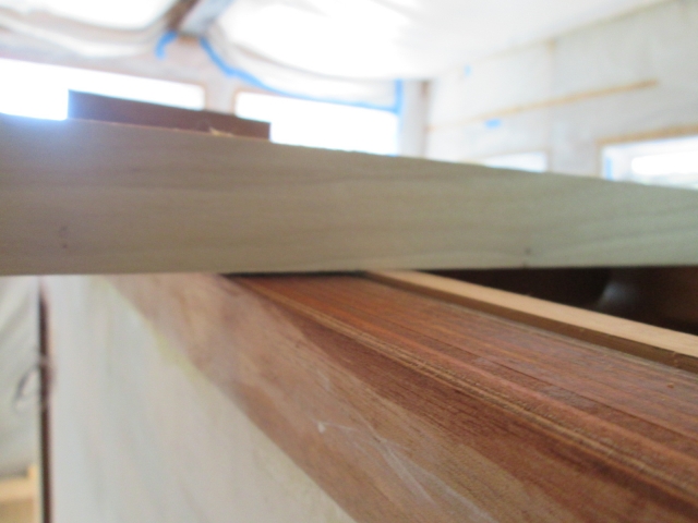

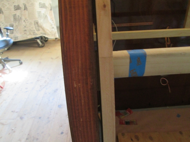

On Sunday (9/29) I picked up work on the hatch again. The curb side rib was somehow twisted in a touch at the hump (top of the bustle) with a much bigger gap to the wall than everywhere else. To correct this without flexing either wall in or out from its free position, I fit temporary spacers starting at the inner face of the street side wall, working across to the curb side wall; held here with blue tape just to be sure that they don’t fall out while fitting the skin.
You might just be able to see the 5mm shims on either side.
Now, you may recall that the template I used to cut the rib profile was made from a full size cutout of the plan, while the rear wall edges where forced into compliance before being cut with the CNC templates. On top of that, at the last minute I decided to shim the hatch frame up and back by 1/16 to allow for the thickness of the canvas to be wrapped around under the skin. So there is starting to be some stack up of tolerances. The street side rib profile was sticking above the wall profile by about an extra 1/16 inch strong.

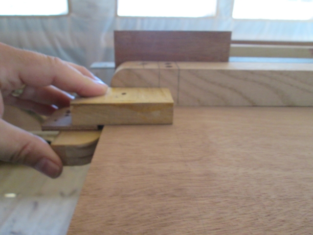

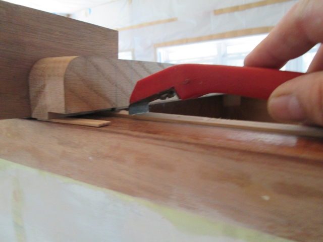

It is not so important to me that it isn’t perfect, but I do want to try and get the gap to at least appear even from top to bottom on each side; can’t hurt the seal to be even, either.

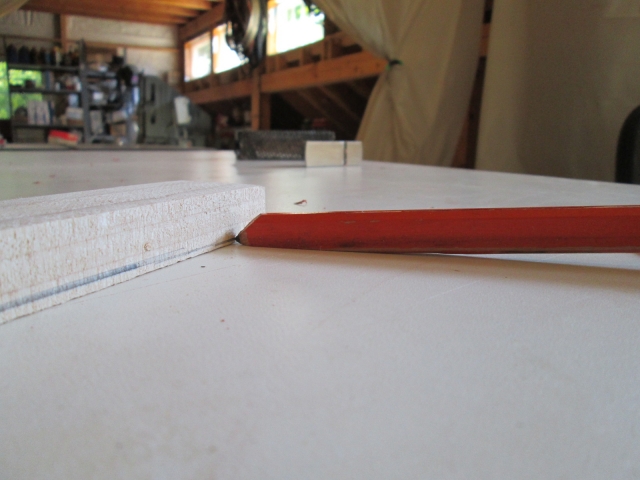

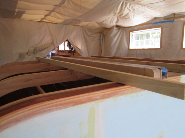

To get a better idea of where I was, I finally got to use one of the carpenter’s pencils salvaged from the Charcoal Briquette resurrection. By shaping the pencil into a wedge with the match box plane I could make it trace a reference line 1/16 inch off the top of the wall edges; demonstrated here on a scrap referencing the top of the bench. (Don’t mind the wandering pencil line in the foreground; I was creeping up on the final shape of the pencil.)
That showed me that I had some areas that were a little tighter (zero), but put a bound on the high area on the top of the street side.
To trim this down I used a 1/2 inch bottom bearing bit and the 5/8 inch roller bearing from my rabbeting bearing set. The smaller 1/2 inch bit worked better in the smaller trim router for this side wall use. I made a first pass referencing the top of the wall, then switched back to the flush bearing to finish the cut referencing the first cut. That brought the top portion of the rib back to 1/16 above the wall.
Up by the hinge spar the router base wouldn’t go all the way to the spar.
So I blended that in using the small scraper and sanding block.
I did some final checks across all four ribs and both walls using a straight piece of 1x2 on edge.

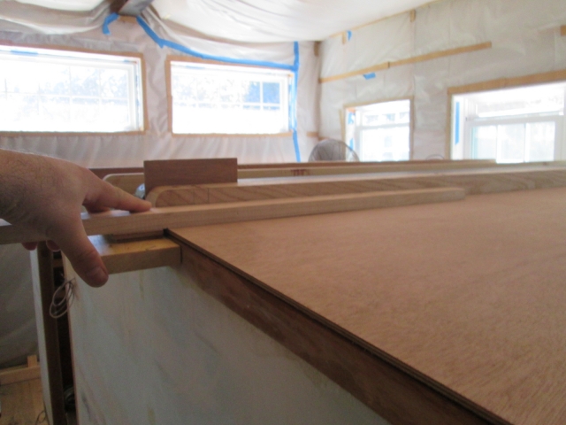

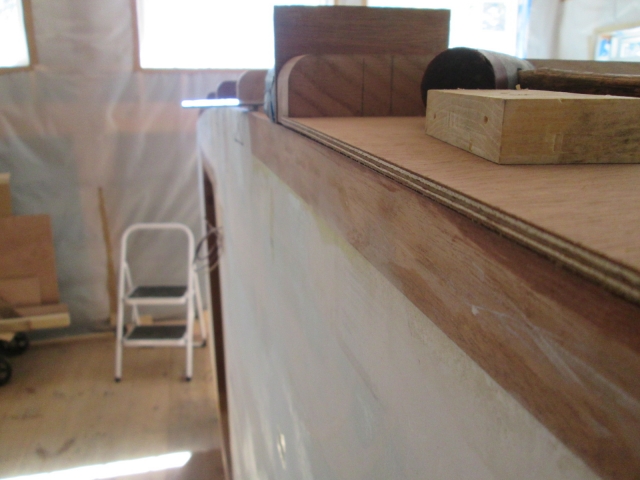

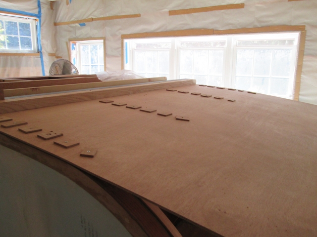

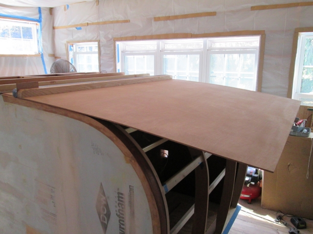

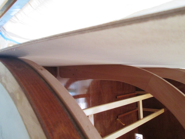

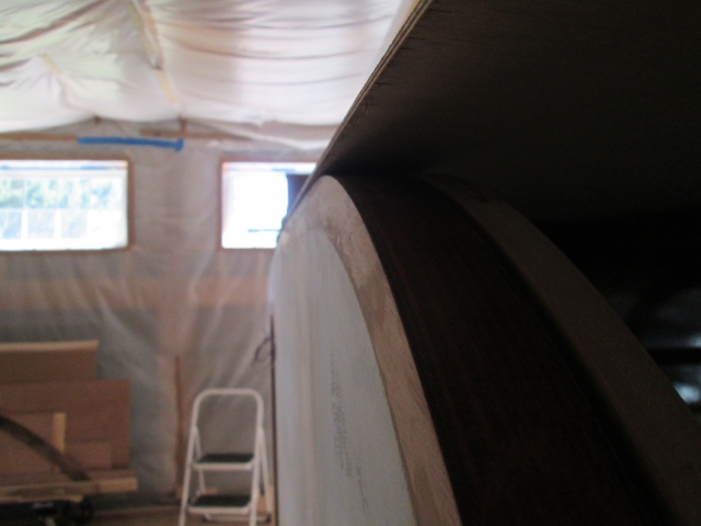

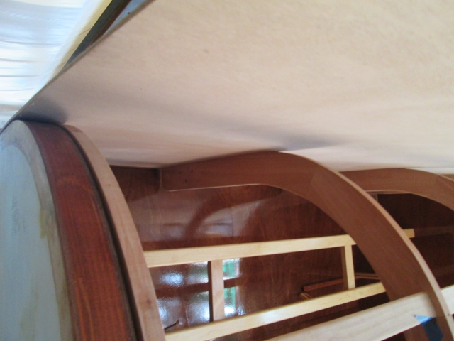

On to the dry fit of the upper hatch skin. Once I removed the temporary spacers and rear screws from the rabbet (of each pair of screws going down thru the hinge spar into each rib) I was able to start the skin into the rabbet. It was nice and snug so I used a small block and mallet on the edges of the skin to knock it into place.
I hadn’t planned for it, but got lucky and found that the skin was a touch long side to side giving me a little wiggle room. Looking up inside at the rabbet joint, it looked about as good as I could expect it to be, and it looked like the extra skin would just be enough to cover the side to side variance in the upper spar alignment; so I decided not to change anything except to shift the skin over so that it was flush to the end of the upper spar on the street side top.
The skin will wander off the street side a pinch.
On the curb side the skin will start a little over the wall and will wander back to it. Without actually bending the skin I couldn’t be sure that it wouldn’t go wrong, but at this point it looked like it would be okay and I was worried that “I could make it worse”.
Here’s a pic of what I saw when I peeked up under from the inside. On the left is the shiny surface of the bulkhead; then the narrow strip of stain on the overhanging section of the cabin side hinge spar (no poly yet); then the raw forward portion of the hatch upper hinge spar, then the skin where it butts into the rabbeted edge of the hatch side hinge spar. There is a little yellowing along the edge of the ply, but the joint (dry at this point) is reasonably tight.
At this point I ran the screws back thru the rear of the upper spar back into the ribs, pinning the top of the skin into position.

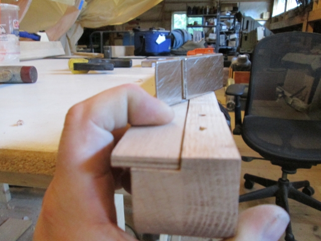

I made a pair of transfer gages to mark a screw line on the outside of the skin at the center of each rib. This is the short gage for the outer pair of ribs. The undercut spacer allows the ‘T’-block to reference the outside surface of the wall without interference from the overhanging skin (later I added a second shim to help deal with the radius edge).
Here’s the longer gage to find the middle pair of ribs, shown first in use.
Then just double checking under the skin to be sure that it is actually finding the middle of the rib.

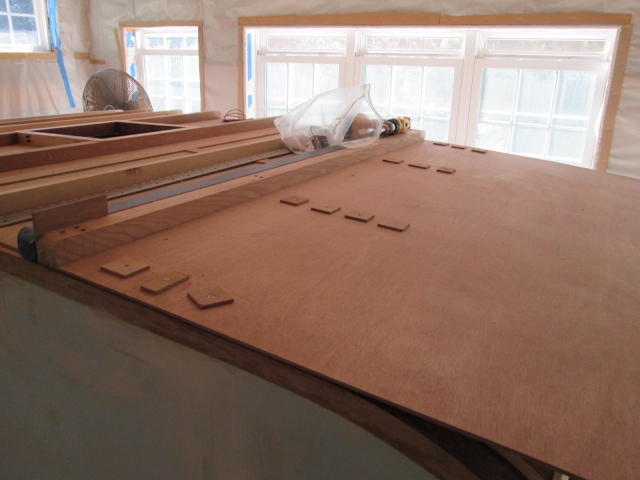

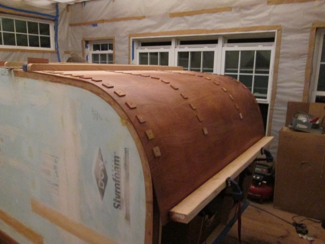

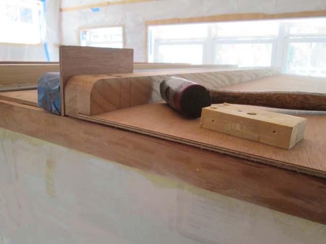

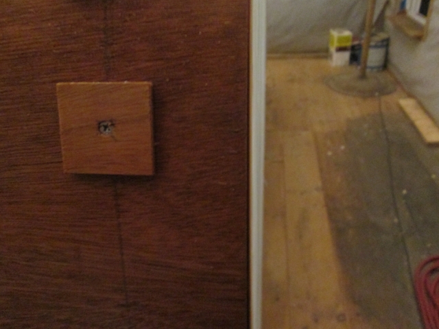

Starting from the top middle working my way out and down, I predrilled each hole using a square cut block as a guide to make sure I was drilling plumb into the ribs. Got a few rows of screws in using temporary wooden washers and checked progress inside.
Did a couple more rows of screws before stopping for the day at the top of the tighter radius section.

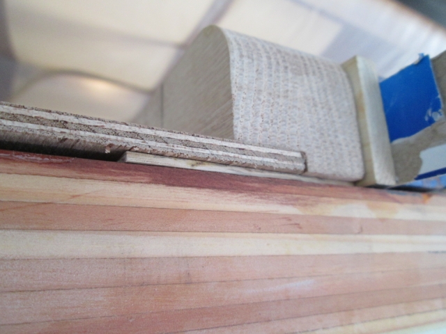

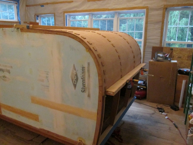

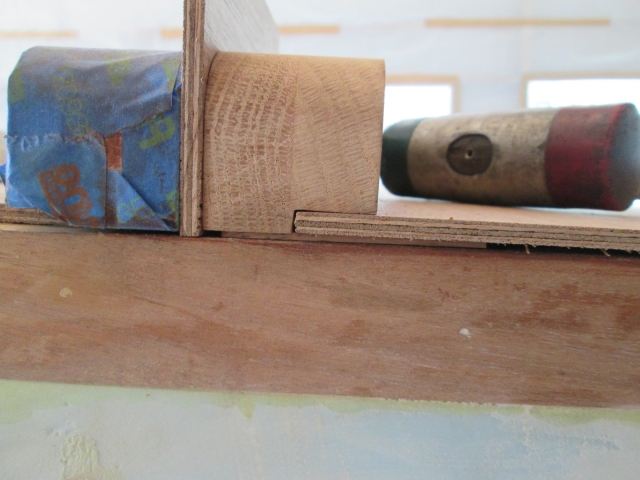

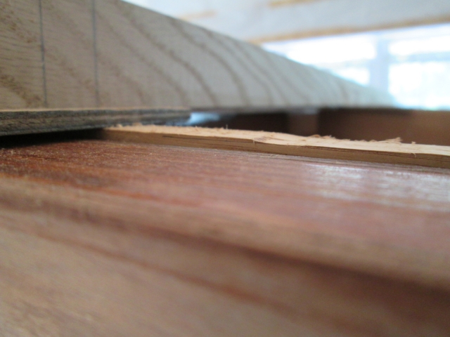

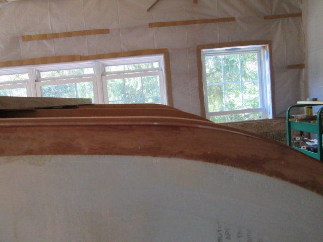

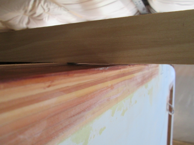

Catching up now, Monday, I soaked the skin down, clamped a board to the tail end, used a couple of ratchet straps (just pulling the straps thru the pawls using friction mostly in the beginning, then using the ratchets a little further on) to get to this point.

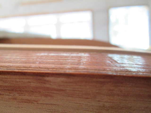

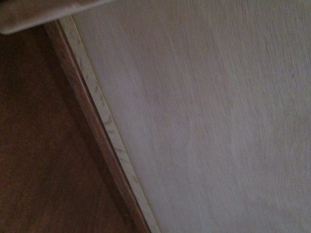

The street side is running out a little further than I had predicted, maybe an 1/8.
While the curb side is just slightly under flush (just a portion of the lighter colored wood seen between the skin and blue foam here).
I could let this go, or I could try to fix it before committing to glue. To fix it I could pull the skin back off, shave a little off the top edge (more on the curb side) to skew it back, then reattach it using a new screw pattern; or I could flip the panel top to bottom, refit it straight and use the same screw holes in the skin (assuming they still line up to the ribs okay), but new pilot holes in the ribs (assuming that the pattern shifts enough to avoid the first set of holes). Mud.
I will wait and decide after I finish screwing it down and see how far off it gets. Remember, this will all get covered with foam and canvas wrapped around the edge, so there is opportunity to fudge it a little or add an edging, plus when I fit the lower skin I can help correct the run out from that point down.
Need to remember to pick up some more 6 x 3/4 FH screws.

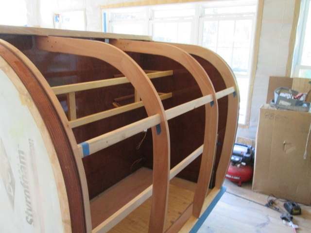

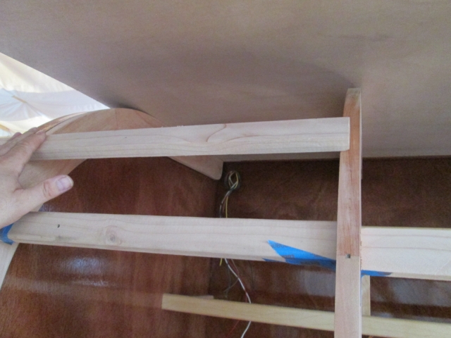

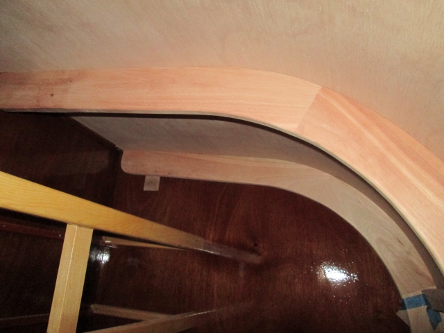

Hatch work continues. Got the upper skin fully screwed to the hatch ribs (still just dry fit). The last few rows were down where the radius opens back up again, so didn’t bother wetting it out again.
I was able to crawl halfway in to the lower center opening, turn and sit on the edge of the galley floor to get these shots showing the nice fit between panel and ribs. First looking up forward at the street side.
Looking up forward at curb side.
In this selfie of “the squirrel in the cage” you can also see the water mark along the lower edge of the panel; a result of the soaking water wicking back up the inside face.
Then looking back at the curb side, followed by the street side.

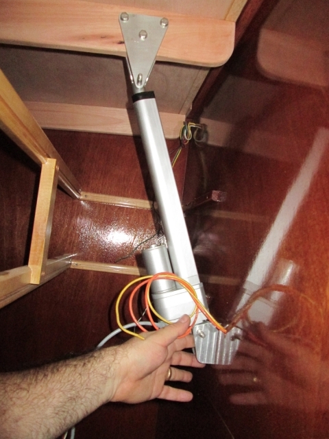

I fiddled around figuring out what else I need for hardware to complete the actuator installation and came up with a plan of attack to drill the required bolt holes for the lower brackets through the bulkhead.
Decided that I should have left the upper actuator brackets attached to the ribs, so I staged everything I needed in the galley and climbed back in. It was not convenient, but I managed to get them fastened into place. I’m not sure I’m saving any steps, but it seemed to make sense to fit the actuators now while I have the hatch all locked down in place and still have access.
Seemed like an opportune time for a mock-up.
Karl found me tucked in.
Squirrel. :D

Postby GPW » Thu Oct 02, 2014 5:40 am
Extremely Big Squirrel .... :lol:
Nice !!! Is that a motorized opener ? Deluxe !!! :thumbsup:
Re: The Poet Creek Express - Foamie Hybrid
Postby KCStudly » Thu Oct 02, 2014 7:08 am
GPW wrote: Is that a motorized opener?
Yes. 12v electric screw jack actuators. I got a deal I couldn't pass up (free). The trade offs are that I have to make provisions to detach them should there ever be an electrical failure while the hatch is closed; so I am making the lower bracket mounting bolts accessible from inside of the cabin. If, when I press the rocker switch, the hatch does not open, I will be able to unbolt the lower actuator brackets from inside of the cabin, so that they fall away from the bulkhead, allowing me to lift the hatch manually. I haven't decided if I will make the electrical connection with a breakaway connector (shave the detention tabs off so they will pull apart... maybe held together with a rubber band), or just coil some excess wire up so that there is plenty of slack in the leads. There is the added complication of mounting the up/down switch were it is convenient to use but protected, the extra wiring hassle, and keeping idiots (myself the first in that line) from activating the switch when the draw latches are engaged (my efforts to develop an electrical interlock triggered by the draw latches have been unsuccessful so far; all of the weather proof micro and/or plunger type switches I have looked at did not want to "package" as well as I would have liked... I will probably just add a toggle switch at the fuse panel in the lockable tongue box so that the main switch can be left exposed, but be defeated against curious tinkerers while the camper is unattended). My biggest concern is throwing the switch with the draw latches engaged and having the hatch self-destruct under the force of the actuators (...or if the hatch is sturdy enough, they might just stall out?). I guess another concern is that someone might unknowingly try to close the hatch manually; the actuators will not "give" like hydraulics and, with enough force, the leverage could damage the hatch or hinge.
It has been a design exercise, and I think that the extra effort will be worth the small novelty that comes with it.
In addition to the actuators I will have a sturdy handle and draw latches on the lower rear of the hatch, as back up, and if the whole thing is an epic fail, I have made provisions in the walls for standard hydraulic struts.
