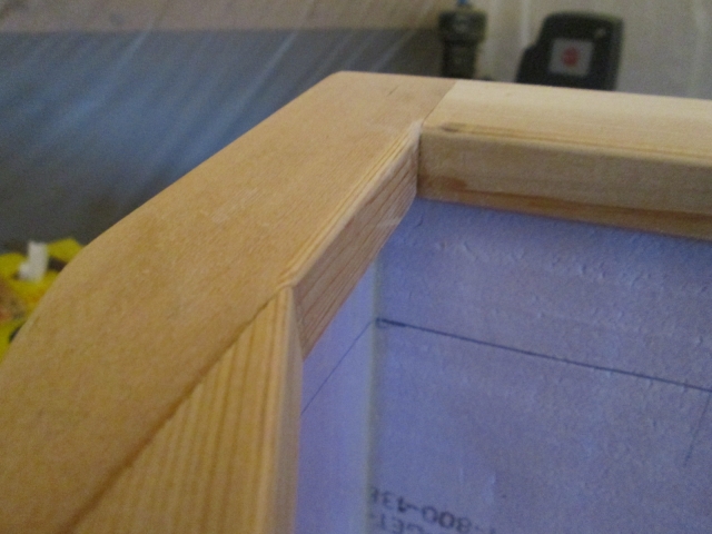

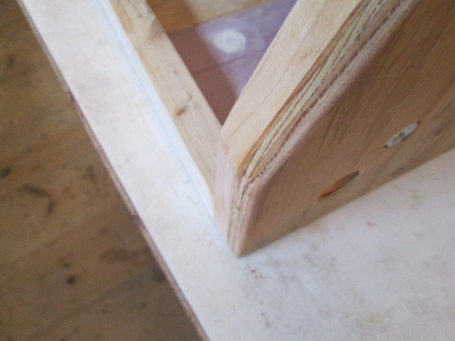

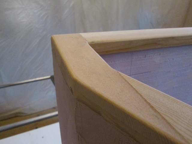

Here you can see the curb side front corner rounded on the outside and the inner and outer edges rolled over with a 1/8 inch radius bit.

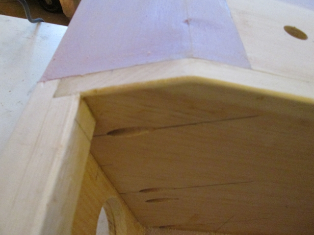

Curb side rear corner; outside then in.

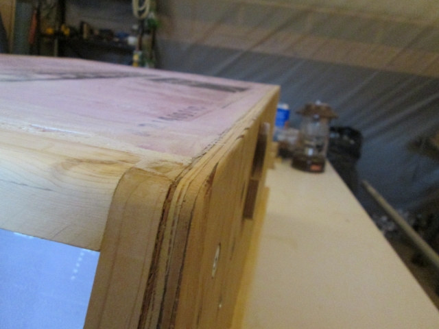

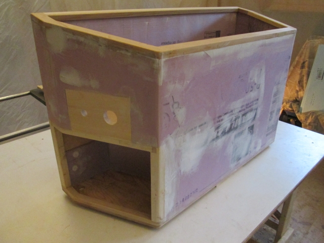

Next I flipped the box over and rounded the bottom edge where the fabric will wrap under. Here it is lying on the back of the box.

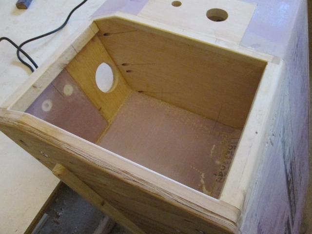

Lastly, I ran the router around the opening of the battery compartment.

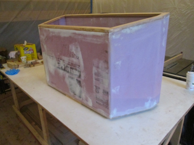

Then I gave the whole thing a once over with the spackle.

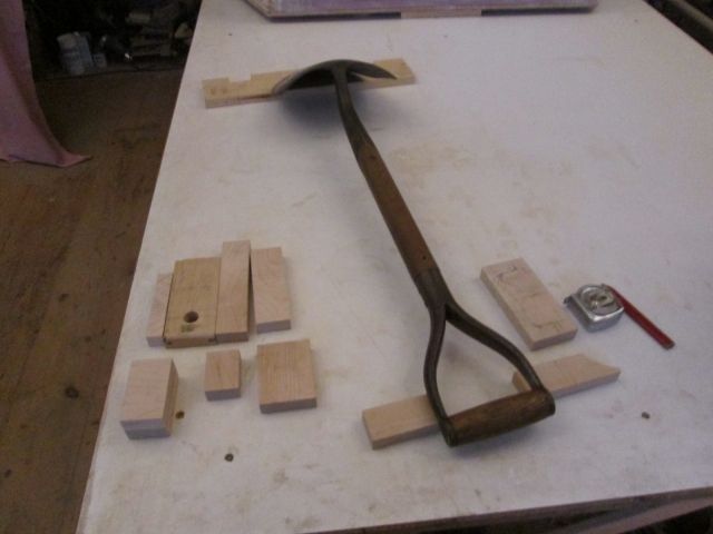

Thinking about getting back to applying the foam to the front of the cabin, I started to sort out the blocking and mounting brackets for my swap meet shovel. Trying to piece something together from the small bits of maple that I have leftover gave me a few ideas… enough to figure out that I don’t have enough of the stock sizes I would prefer for the design I have in mind (similar to the rifle mounts I made previously).
