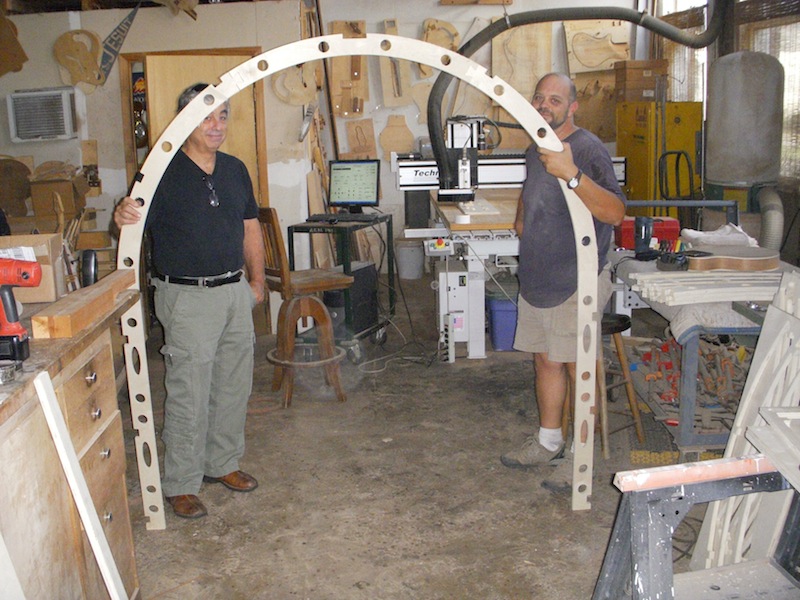

Postby Oldragbaggers » Fri Oct 05, 2012 6:09 am
Now THAT is some fancy cutting. I am really looking forward to following this build. Very interesting. I never cease to be amazed by the ingenuity of the people on this board.

Postby Fishingtomatoseed » Fri Oct 05, 2012 6:25 am
I like the holes in it to reduce weight and the puzzle cut outs. Been think about getting a CNC router for while know. Another reason to get one.

Postby GPW » Fri Oct 05, 2012 6:37 am
Tried to post the video on YT of the machine working ... No Luck ... grrrr!!! , So here’a a pic of Vincent (on right) and Dave holding up a rib ..

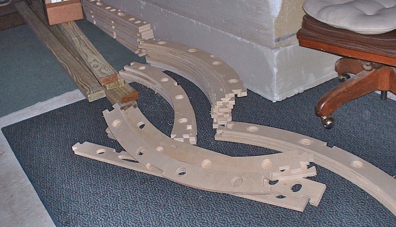

Here’s the parts , all in one place .. Have to prepare the Trailer now ... ;)
Ps. The box has all the “holes” in it ... :lol:

Postby wagondude » Fri Oct 05, 2012 7:27 pm
Dang! That is sweet, G! :thumbsup: :beer: You should have those ribs together in no time.

Postby GPW » Sat Oct 06, 2012 5:42 am
WD, I did lay out the first rib on the concrete floor , got a little brush and filled an old P nut jar with some T2 ... brushed it on each side of the puzzle’ connections , and assembled the whole thing flat on the floor , left it to dry overnight ... checked it this morning and now it feels like one solid piece :thumbsup: ... I’ll just repeat this process till all the ribs are assembled , and in the meantime , start getting ready to slice those foam blocks ...
