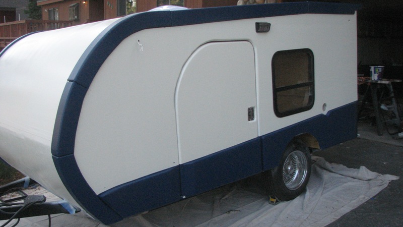

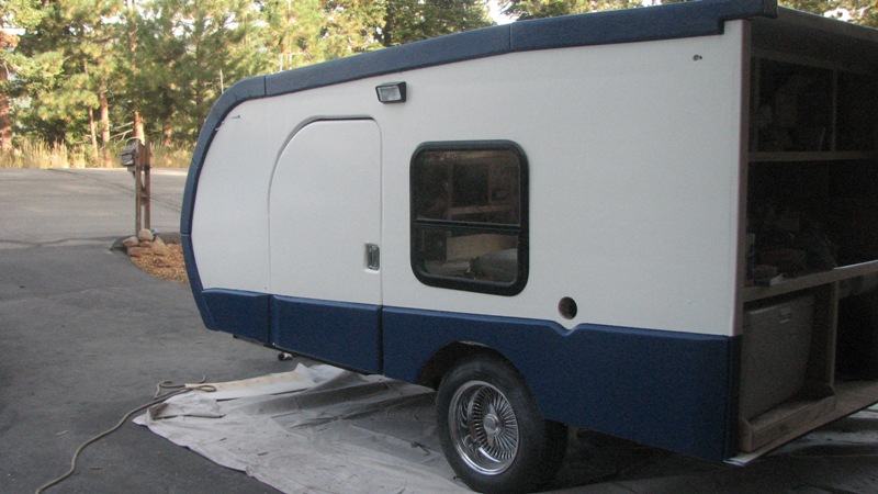

I got the Road Foamie all painted. I've got some touch up to do but essentially the exterior just needs assembly. The door and window in the pics are just set in place for now. Here are the pics....
So now that the shell is "complete", I have two observations... First, I wish I had put a window in that door but I was so fed up with messing with the door at that time that I said "screw it". Second, that is waaaaayyyy too white. :shock: :shock: :shock: I wanted a creme color and the color swatch looked right but in reality it was barely off of white. When I was putting the color on, I could barely tell the difference between primer and paint. I know there's a general rule about swatches and your real final color but I forget what it is. Is the actual color lighter than the swatch or is it darker, or is there really any general rule? I might add an accent stripe between the navy and the white just to soften the transition a bit. The obvious color would be a light blue, but I'm thinking of a "gold" or maybe yellow. That will have to wait until the Road Foamie is road ready, probably until after the mid-October road trip. But at this point, I'm satisfied with how it came out... :) :D :)
Time to mount the doors, windows, lights and reflectors. A word of caution folks. Stay under 80 inches wide or you have a whole new set of lighting regulations you have to meet.

Re: Road Foamie - Paint's done... Getting closer to done
Postby Wobbly Wheels » Sun Sep 16, 2012 10:39 pm
Holy crap Mel, that looks fantastic !
I agree with the accent stripe, but I can't see it in the same light you do either.
Postby GPW » Mon Sep 17, 2012 4:18 am
That’s really EXCELLENT !!! Looks SUPER !!! :applause: :applause: :thumbsup: 8) 8) 8) :beer:

Postby eaglesdare » Mon Sep 17, 2012 5:11 am
fantastic! i think it looks good. :thumbsup: :wine:
Postby bonnie » Mon Sep 17, 2012 5:31 am
Mel, that is absolutely beautiful work. I think the accent strip would be a great idea. The blue trim is a real finishing of the whole look. Well done. :applause: :applause: :applause:
Postby KCStudly » Mon Sep 17, 2012 2:20 pm
Yeah, that does look great! I'm okay with the white. Run it around on a few trips and I bet it will tone down on you once it gets exposed to mother nature a bit.
All that talk about the little dip in the trim line hardly seems to matter now that the high contrasting colors come into play; kind of amazing actually, just sort of disappeared.
Postby S. Heisley » Mon Sep 17, 2012 4:46 pm
Terrific job, Mel! It looks really good. :thumbsup: :thumbsup:
I wouldn't worry a bit about the white being too bright. Once you get on the road and get some road dirt on it, that white will probably dull out some and won't bother you at all
Postby atahoekid » Mon Sep 17, 2012 10:51 pm
Thanks for the compliments folks... I guess I do have to just live with the white and hopefully it will tone down some when mother nature gets working on it. As far as the funny dip at the nose trim, I played a little trick on the eye. I actually painted outside of the trim pieces by a 1/4" or so and more where the piece dipped, so to the eye it looks straighter. I learned that trick painting my house. Who ever did the dry wall made lousy corners and they weren't straight. It wasn't noticeable till my wife wanted a contrasting color on the wall. I painted exactly to the corners and you could really tell so while trying to figure out what to do, I read on the internet somewhere to paint outside of the corner by 1/4" or so. And as if by magic the flaw disappears. I'm so happy I discovered that trick. It doesn't completely take care of the issue , but it's a lot less noticeable. Tomorrow after I take care of a few things for work, I'm going to work on mounting the doors, windows and all the lighting. I was planning to take it for a spin as soon as the doors and windows were on but I just remembered I need to get safety chains. The ones that came with the frame were so pathetic, we just cut them off.
