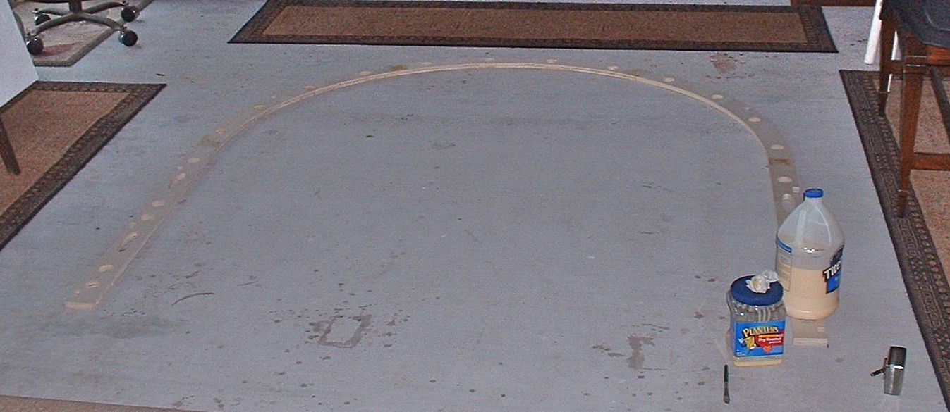

Rib assembly pic ... Little grease pencil marks on the floor @ 72” keep each rib bottom the same width whilst drying , assuring perfect alignment later ... That’s Important ...!!!

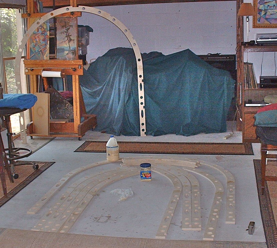

Decided to expedite the rib assembly , gluing the outer assemblies all at once ... :thumbsup:

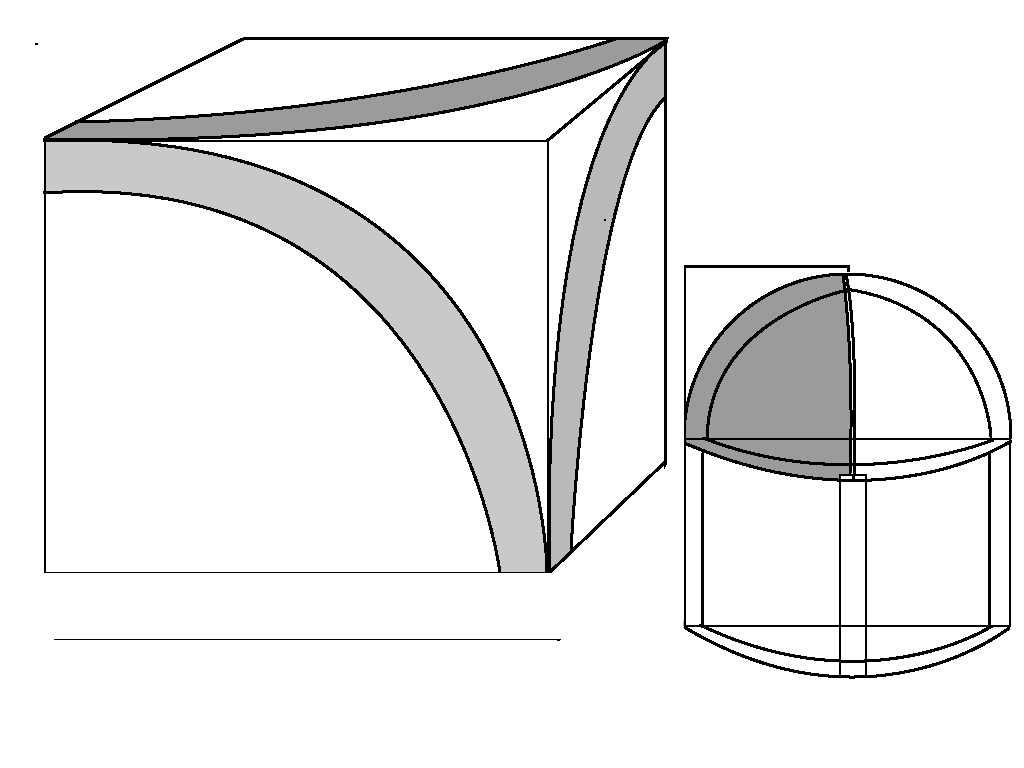

Ruh Roh !!! Things getting interesting now , Vincent sent me this : “ how about a set of ribs to make up a teardrop with galley in the rear, etc...and we can cast some deco looking rocket fenders,..all skinned in sheet metal for a DIY mini airstream? Now that could be fun to do. “
The game is afoot !!! :o :thinking:
Already planning a way to hot wire out a round nose section ... see pic .. Hot wiring on 3 axis ... ;)

Those CNC cut ribs look fantastic ! They make one want to check further into
the CAD programs. The cost to have one's design cut out may be worth it -
even if we aren't as lucky as" some" [Ha !} to have friends who are wiling to do it.

Yes, the ribs were always the snag with this project and I was LUCKY (fortunate) to have my Friend cut them out on the CNC machine .... And as it worked out , we figured the cost of the ply + the machine time was equivalent to buying the Conestoga Ribs from a Wagon supply , and then those were too short and didn’t accommodate the stringers or the “hangers” (the holes to hang things from ) as these ribs do ... so this all worked out Great ... :thumbsup: There was the machine drawing time /effort , but since that’s saved info now , others may benefit from this without that charge ... 8)
