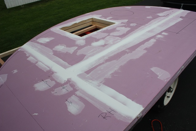

Postby mikeschn » Thu May 19, 2011 5:07 pm
Well, the temps were above freezing today. Actually they were slightly over 70 when I went outside this evening, so I decided to play with the foamie. I recently purchased some vinyl spackling for this purpose.
So I went outside and put some spackling on the first side. While it was drying the rain moved in. So I pushed it back in the garage. I guess I am done for today.
I sure hope we have a decent weekend for building! :?

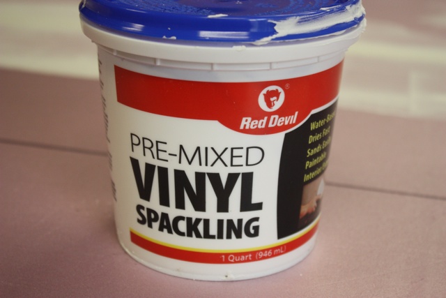

Postby mikeschn » Thu May 19, 2011 6:24 pm
I bought mine at the hardware store. It look like this sitting on the shelf...

Postby eaglesdare » Thu May 19, 2011 7:13 pm
does this stuff dry hard? is it just for the purpose of filling in holes/gaps? it won't hold 2 pieces together correct? is it used pretty much just to make things flat?
do you have to sand it?

Postby GPW » Fri May 20, 2011 6:00 am
Eagle , it's just a "filler" for dents and such .. not a glue ... Say you're hanging a picture on the wall , and the hammer slips and you put a dent in the sheetrock ... spackle fixes that ... :thumbsup:
Yes you trowel it on , let it dry and sand it flush with the surface ... "makes things Flat " ... ;) Great for those little dents and scratches that seem to get into foam sheets ... You just have to let it dry Thoroughly , before you sand it ...
