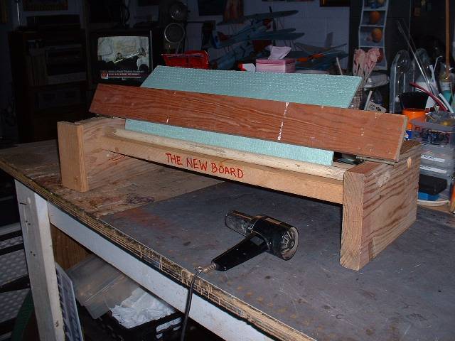

Mel, we’ve bent a Lot of thinner Blu foam in the past ... Generally , we put the foam in tension and heat the outside surface of the bend... (heat gun ) For thicker foam , I’m thinking Two heat guns , one heating the outside , one heating the inside ... The trick is to keep the guns moving , so as Not to burn or distort the foam ... We only have to get it to 190F so it’s possible the hot towel/boiling water idea might work ... We’ll have to experiment with this ...
It sure would be Nice to be able to bend the foam rather than kerf ... once the heated foam is cooled it stays in that shape , so is easy to use and attach ... :thinking:

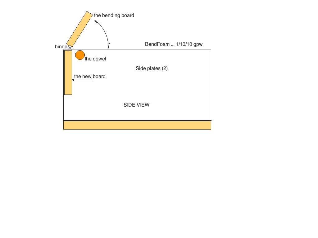

Here’s an article by one of those crazy RC guys ... :roll: http://www.rcgroups.com/forums/showthre ... ndfoam+gpw
...and a picture of the jig ... The advantage being , you only are bending a little at a time , so only have to heat a small area at a time ;) ... a bigger jig similar to this would work ... and you don’t need a big form to bend over ... :thinking:
Bowling water? .. hey , that’s Beer :beer:
BendFoam 110.jpg (41.69 KiB) Viewed 1035 times
