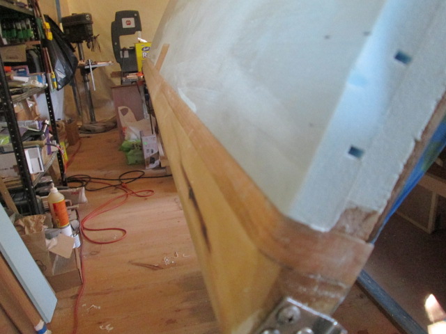

It sounded like the jack incident was much worse than it appears in that pic. Foam sure is forgiving when you need to fix gouges, dents, mis-cuts and poor fit when you have Great Stuff handy ! :FNP

Yeah, it was probably more exciting than damaging, but those torn serrations are like fish scales or shingles. The rips go up inside like layers so I'm not sure if I'm just going to butter it up with some GS and sand it back, or if I'm going to pocket out the damaged area and glue in a foam Dutchman/patch.

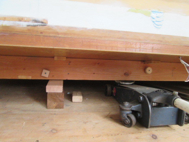

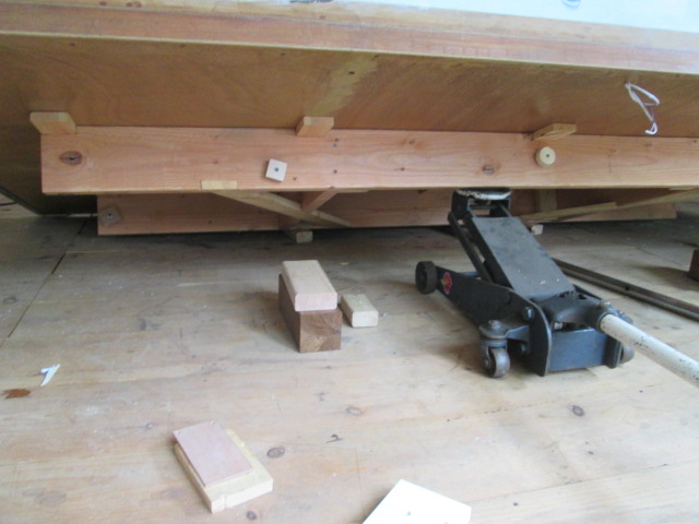

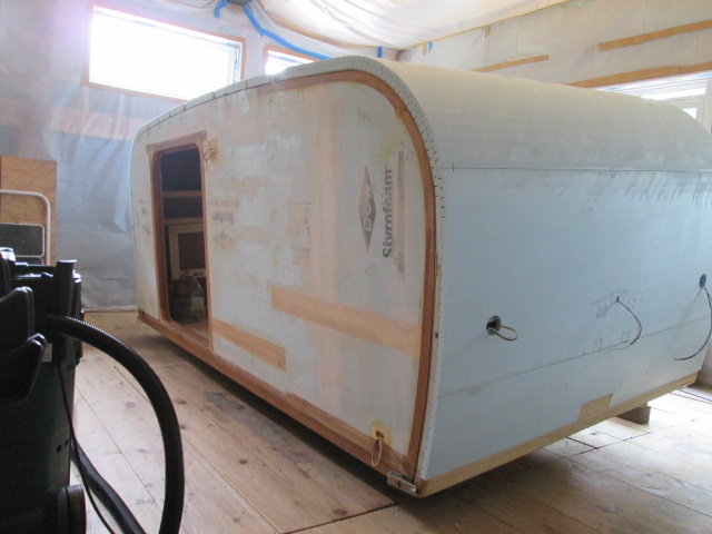

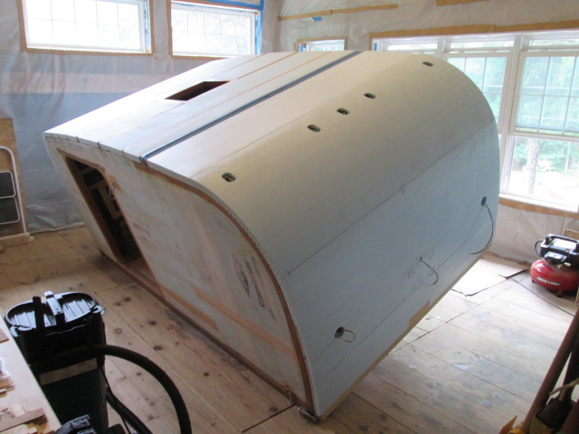

Today was a bit overcast and cool, so a great day to be building, despite the rain that came later in the afternoon.
Started by doing a little touchup 100 grit sanding on the side portions of the roof top, then used an improved technique to keel the cabin back over and get the middle part with the same grit. Rather than trying to lift from the edge of the floor the whole way, and have the angle between the floor and jack pad change, I just lifted enough in the first pick to get enough blocking under the rail of the build cradle to where I could reposition the jack pad under the cradle rail. Here you can see the white vinyl piece between the floor and jack pad lifting on the underside of the floor.

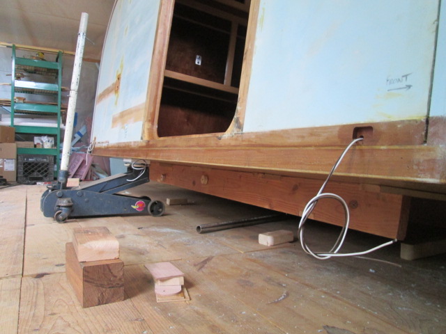

Street side view as she starts to keel.
After stacking the 4x4 Ipe and 2x4 blocks under the rail, lowering, and repositioning the jack pad under the edge of the rail, the vinyl pad was no longer required and the rail nestled down in between the lugs on the jack pad. This made a much better grab for the jack and I could safely lift the rest of the way.
You can just see daylight under the far edge of the floor.
In this position I could just reach what I needed to sand the middle of the roof without totally wrecking my back while standing on the relatively generous top step of my folding step stool.
I could probably figure out the vertical CG of the cabin using this technique and some math. When lowering the jack there was a very distinct point when the weight came back onto the jack and I had to quickly turn the handle back to slow down the rate of drop.

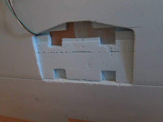

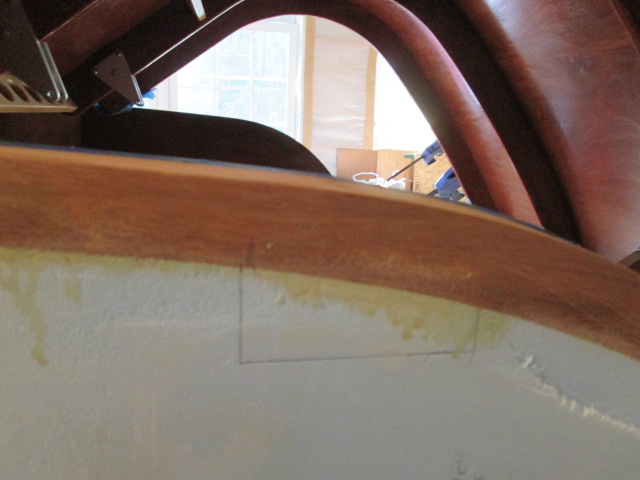

Next I tried to start knocking off other areas of the foam that need to be faired before I start doing some filler work. I faired the foam on the curb side of the front wall flush to the axe mount blocking, rock guard sparette, and front floor edge. Rather than knock the whole panel above the locker down, I just feathered it in above the corner.

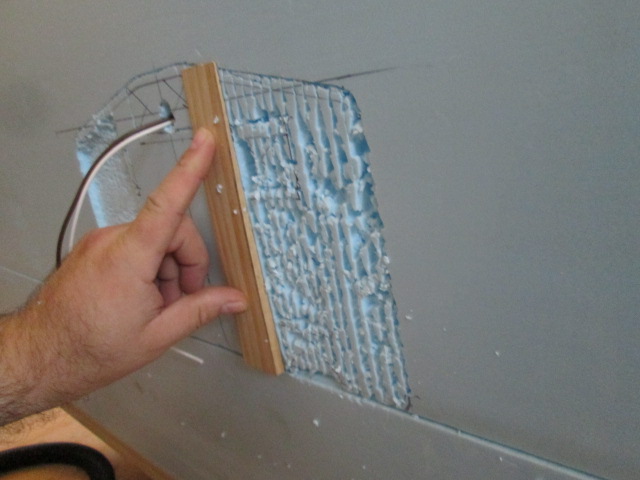

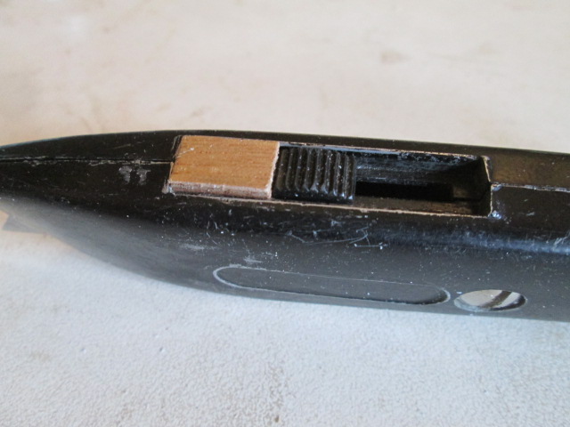

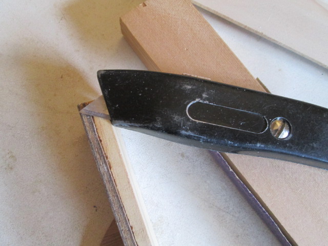

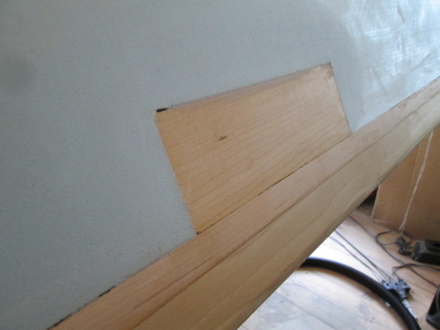

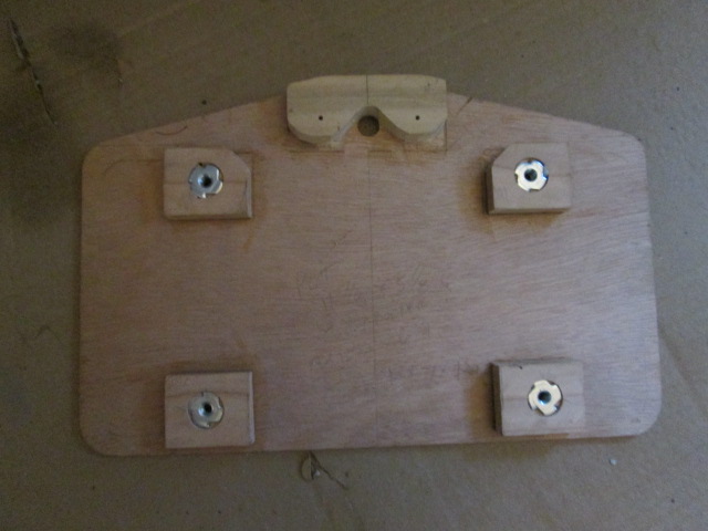

I decided that I was over complicating my approach to recessing the license plate mounting pad. I didn’t like my chances with the router template I had started as I was afraid that I would end up cutting the buried electrical wires. I decided that I could carve this out by hand if I could control the depth of my cuts. My cheap utility knife only has a couple of detents on the blade depth, and none of them hold securely, so I set the depth to match the thick end of a wedge shim plus a piece of the 5mm ply matching the thickness of the plate holder.
From there I cut a little piece of 5mm scrap that fit snuggly into the recess of the blade adjuster, preventing the blade from extending any further.
Using a wedge shim as a guide for the nose of the knife handle I was able to make scores with reasonably controlled depth starting out deeper at the top and moving out shallower at the bottom. The angle of the blade was kind of steep, so it tended to chunk rather than cut, but by making a few light cuts instead of one big gouge it seemed to go okay… good enough.
By using the edge of the shim as a scrapper and dragging it over the scores to knock out the crumbled up bits, then sanding a little, I could see that I was headed in the right direction.
36 grit then 100 grit on small blocks.
Flipped the plate holder around backwards to test fit.

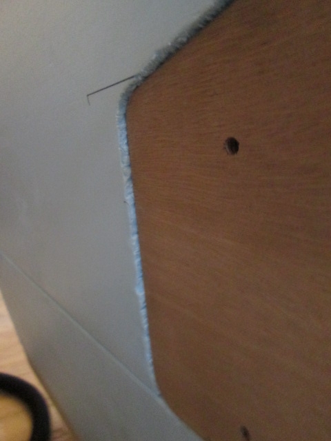

Next I cut down the piece I had intended to be a router template for the blocking on the rear of the mount so that it would fit into the recess, and just used that to trace the location of the blocking. Used the utility knife to cut out the rest of the outer layer of foam. For the top holes I had to go back and score into the inner layer of foam to account for the taper (after this pic was taken).
Test fit.
In the close up of the left side you can start to see the taper to the recess. Unfortunately, when I put my little layout square level up on it to check for plumb I could see that I am quite a way off, needing to bury the top of the plate a bunch more. At least the floor of the cabin is sitting flat now so checking for plumb was much easier than before.

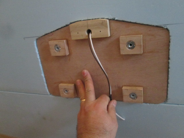

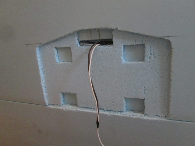

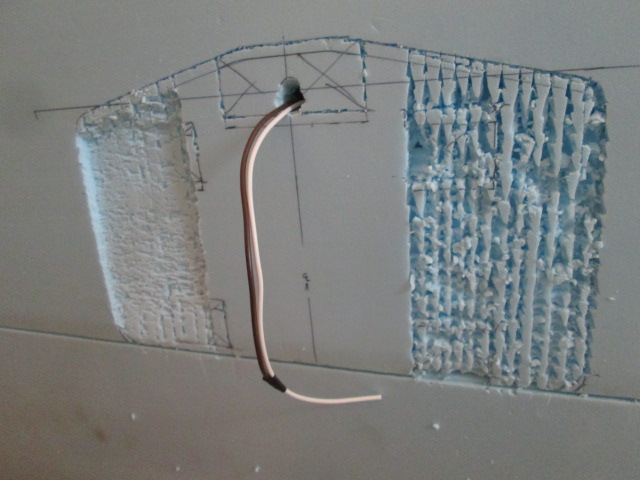

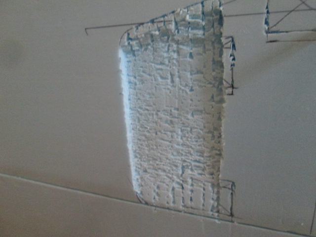

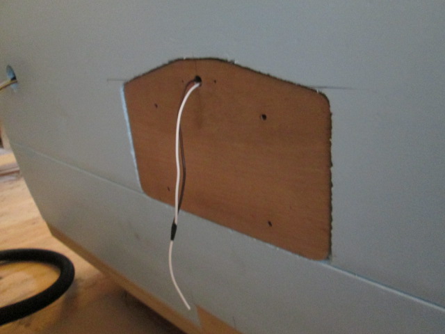

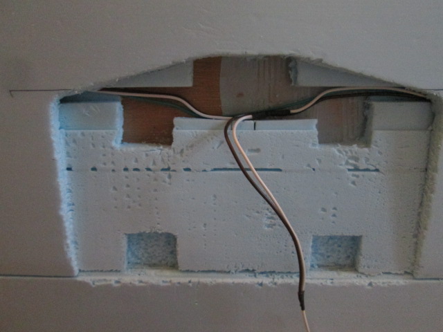

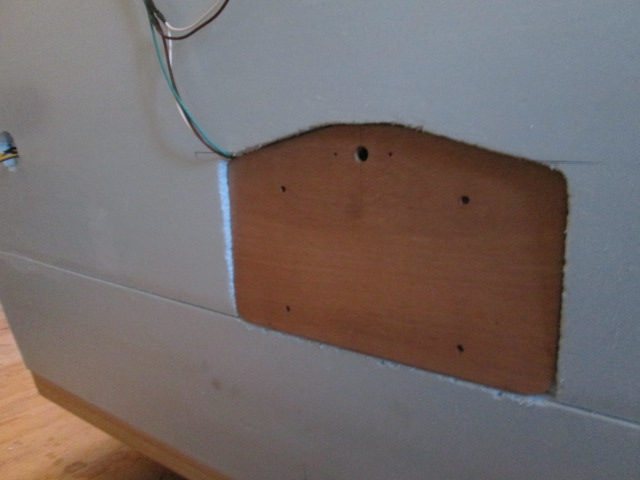

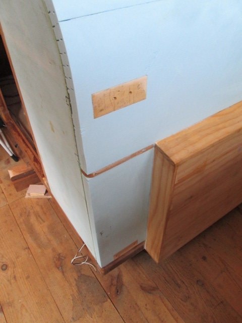

I decided to go deeper at the top of the license plate recess, closer to plumb. I didn’t get very far before I was reminded of a few things. First, I hit kerfs. Second, I hadn’t adhered the second layer of foam fully to the first, just bands of the PL300, so some areas where the first layer started getting thin became unstable when attempting to sand. Third, the reason I had originally settled on the depth that I had was due to the fastener allowance and depth of the blocking; I could only go so far without getting to the inner hatch skin and leaving no room for the wires to enter the back of the marker light block.

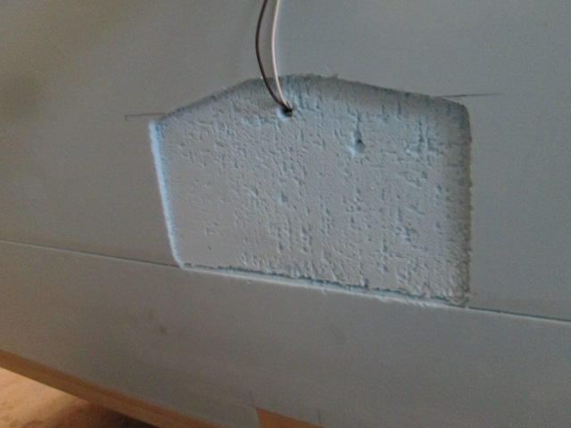

What you see here is the end result (for now?). Behind the top three blocks I went all the way to the inner skin. Then I cut the loose part above the exposed kerf away, plus the area under the wire trough, plus a little more to allow the wires to run between the blocks. I had to dig a little more out from the lower block locations, too. Also note that I pulled the right hand taillight wires back and taped them out of the way while doing all of this cutting.

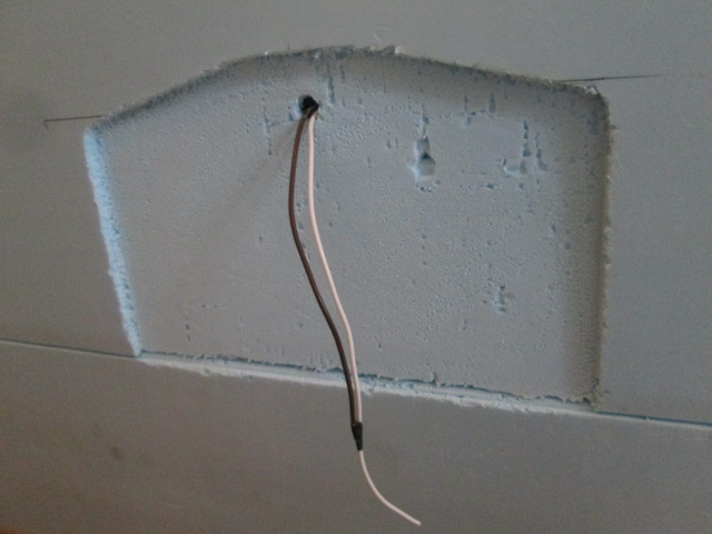

To make room for the wires again I carved out the underside of the marker light block and knocked the corners off of the upper plate bolt blocks.
I like how it is fitting better now, but will have to be careful not to pinch the wires or glue them in when placing the mount permanently. The wires will be harder to snake if the need should arise, and I’m not thrilled about the fasteners leading straight to the inner skin, so will have to waterproof very thoroughly.
Here’s how the wires need to run to avoid the blocks. I’ll have to fix them in place somehow, either with a few pieces of tape, some hot glue (but not so much that they can’t be pulled away), or… ? I would like to GG the mount in place but don’t want to stick the wires hard.
It's not bad, but I have half a mind to cut the rest away, or even a bigger area, and go the other way with a raised blister to mount the plate on, similar to how I am doing the taillights.

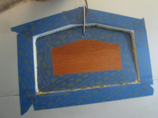

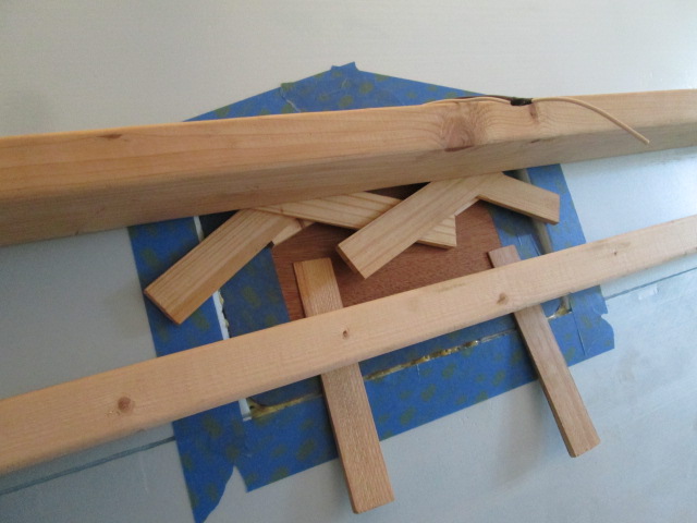

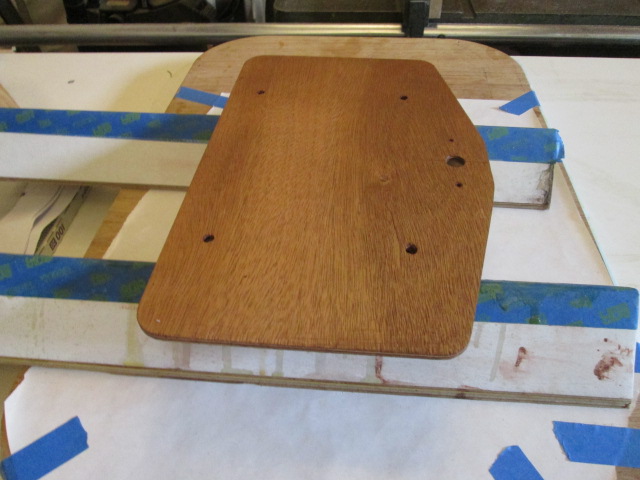

Here is the license plate mount after a couple of coats of the mix.

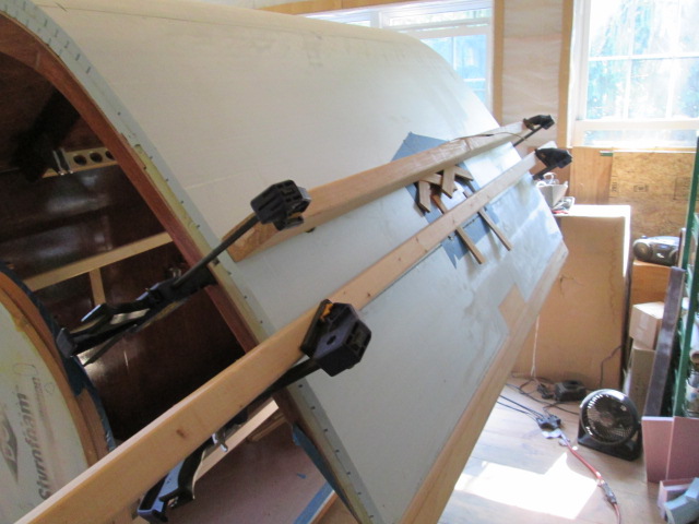

Decided it was time to go for it. Propped the hatch half open; masked around the mount and the recess; taped the backs of the plate bolt holes; smeared GG in block recesses, along edges and on flat areas being careful to keep it away from the wires as much as practical; stuck the mount in; clamped strong backs across the hatch; and put wedge shims in to hold the mount down in the recess.
Jumping ahead, after a few hours I removed the clamps and sanded some of the bubbles.
Because I was conservative with the GG, I will have to seal up the edges with something, maybe spread some GS in there, then this will get “jambed out” with glue and bed sheet.

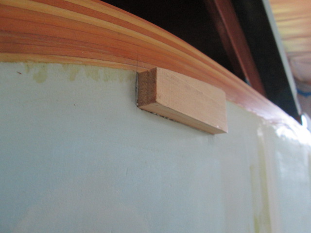

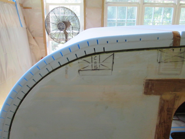

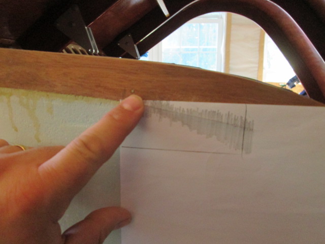

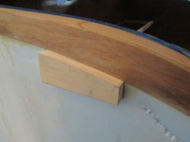

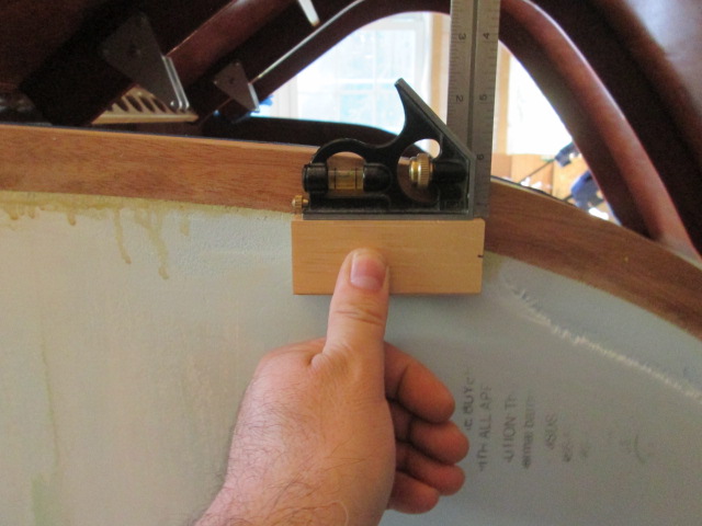

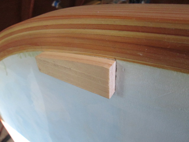

After cutting the blocking for the side clearance lights I finalized their locations. If you look closely at the sharpie outline of the inner cabinet face frame blocking, you can just see a thinner ink outline overlapping same. I held the block up where it looked about right, used my speed square to level and traced around the block. This is the street side front.
In the rear it was a bit of a compromise due to the more gradual profile radius. The light could be either at the same level as the front one, but further forward, or it could be further back but lower. I decided to push it up into the rear wall edging to mitigate this compromise. It puts the light a little closer to the edge of the wall, but I think it will be okay. The hatch is plenty thick that it will look okay with the hatch closed, I just hope that it doesn’t look stupid with the hatch up.

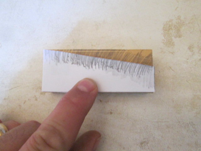

Here’s the levelling technique. Also note the little pen tick mark on the right side matching the inside of the wall edging.

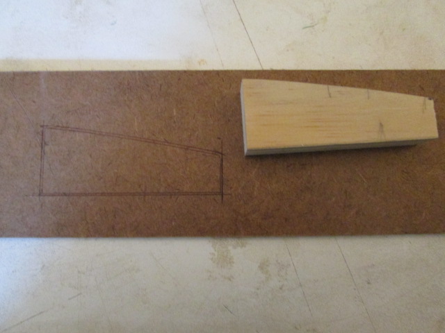

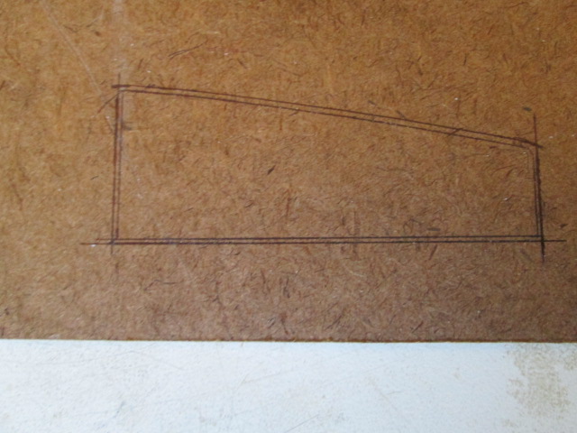

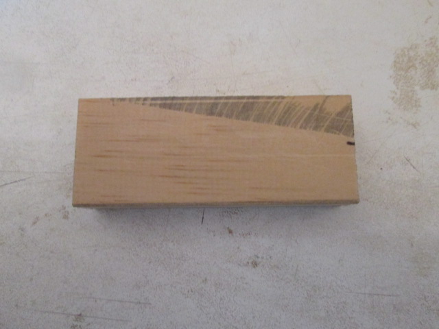

To transfer the hard edge of the wall to trim the block I made a little pencil rubbing. The line between the darker and lighter rubbings is where I cut with the scissors before remembering to take a picture.
After cutting the rubbing the rest of the way I rubbed across from the paper to wood to transfer the edge to be cut on the band saw.

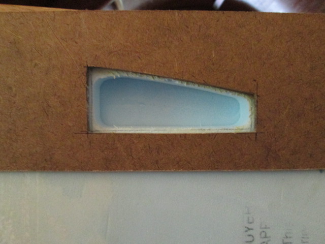

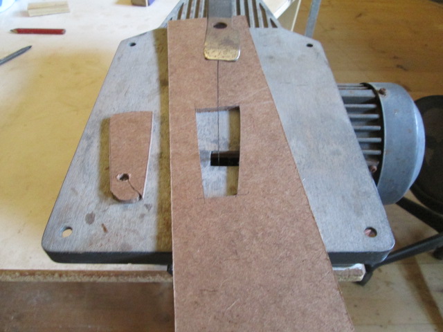

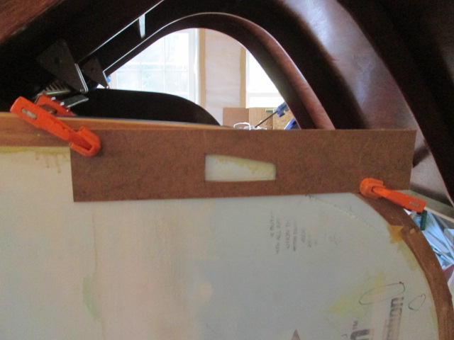

After sawing close to the line and sanding to the line on the big disc sander, I traced around the block onto a strip of melamine to make a router template. Then I stepped off the tracing by 1/16 inch to account for the collar offset on the router shoe.
Next drill a pilot hole to thread the scroll saw blade thru and cut out the template.
The extra length of the template allowed me to clamp it to the side wall w/o getting in the way of the router base.
Made the cut…

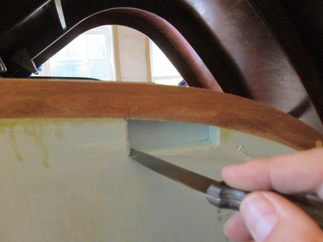

… and trimmed the corners out with the steak knife.

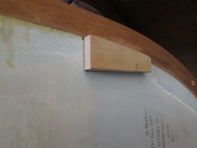

Dry fit test. It was so snug I didn’t want to push it all the way in for fear that I would have a hard time getting it back out again.
For the curb side block I just traced the first block and repeated the process. First pic is looking up and forward. Second is looking back and down.
