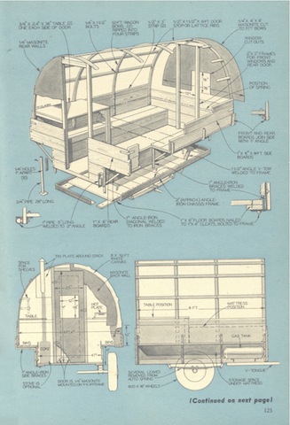

GPW wrote:Eagle , this drawing did it for me ...
A good ole sheep camp. Though the classic sheep camp was built on 4 wheels. At the corners. Was usually built on a salvaged wagon and then later some kind of worn out pickup/car. And having four wheels in the corners made so you didn't have to use jacks. And the classics used a canvas top. I see now that the new ones are built on a 4 wheel trailer chassis. I have never stayed in one but in my youth I did visit several and had a few excellent meals.
