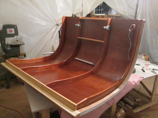

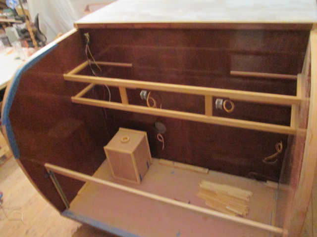

Tonight I went by Defender again and picked up another couple of gallons of 105, and 205 to go with. I think that should be plenty to finish the whole camper, and I didn’t want to run out during any of the bigger layups to come.

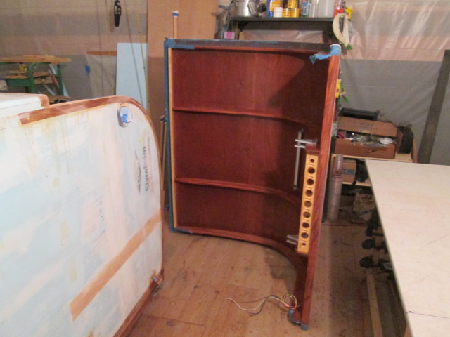

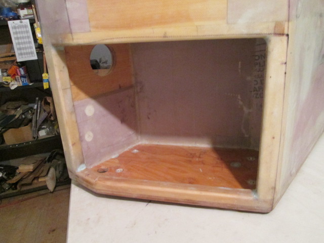

At the shop I cleaned up the bench some, moved the TB to the side and unscrewed the temporary deck screws holding the hatch on. It has been a while since we have seen the inside of the galley and underside of the hatch. I can tell you that the hatch has gained some weight and is not less awkward for me to handle by myself, especially given that you have to be careful not to dent, ding or crush the foam.
Here is the hatch sitting on its side on the floor. Note the extra masking tape at the corners as well as along the sides and sill.
The galley is still there; a little dusty, but none the worse for wear.
The old bed sheets I bought at a yard sale very early in the build came in handy again as pads to (hopefully) protect the foam. Getting the hatch flipped over w/o putting too much of its own weight or my grip on any one spot was a bit of a challenge working by myself, but I managed. Even though it felt like it might get away from me every step of the way. I spent the rest of the session with the hair dryer softening the tape and peeling it off in various size shreds. The back edge and tip of the utility knife blade, tweezers, my nubby fingers and finger nails all came into play. Here you can see that I have gotten the corners, one side and sill all stripped off; just one more side to go.
Tomorrow will be a family day; happy thanksgiving to all.

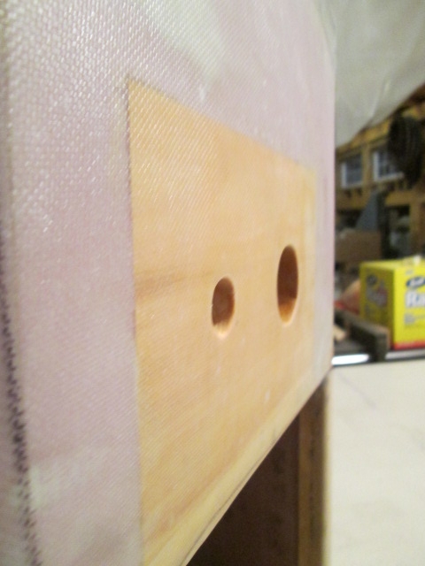

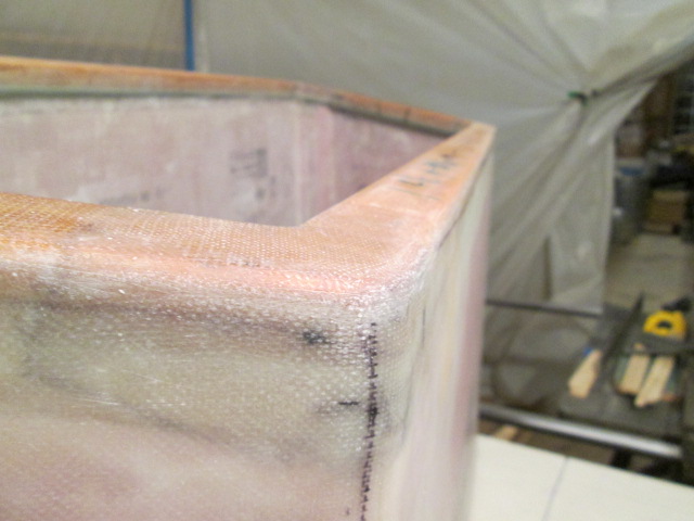

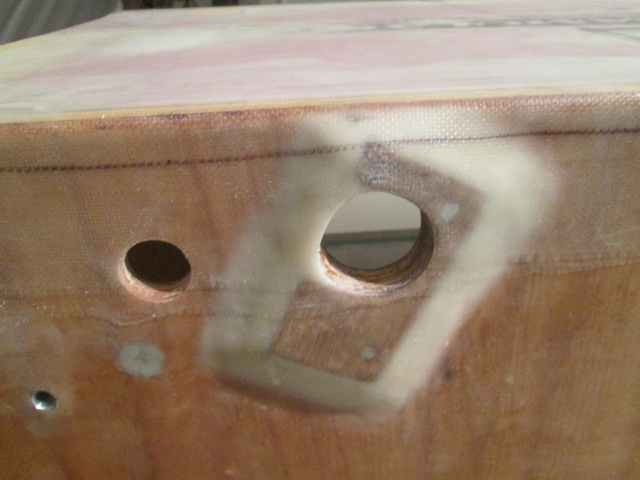

Friday I will experiment a little and do a test of a flox corner. I’d like to keep the crisp edge between the hatch and side wall, but I will have to work around the plywood inner skin of the hatch. My thought at the moment is to bevel the edge with the router first; make a temporary dam with release agent to build the flox corner; then glass to the corner from both directions. Option “B” would be to excavate a wedge of foam from the back side of the inner ply and rely on the edge of the ply to take the adhesive from both sides with flox backing it up. Option “C” would be no flox and just glass to the corner edge of the ply.
