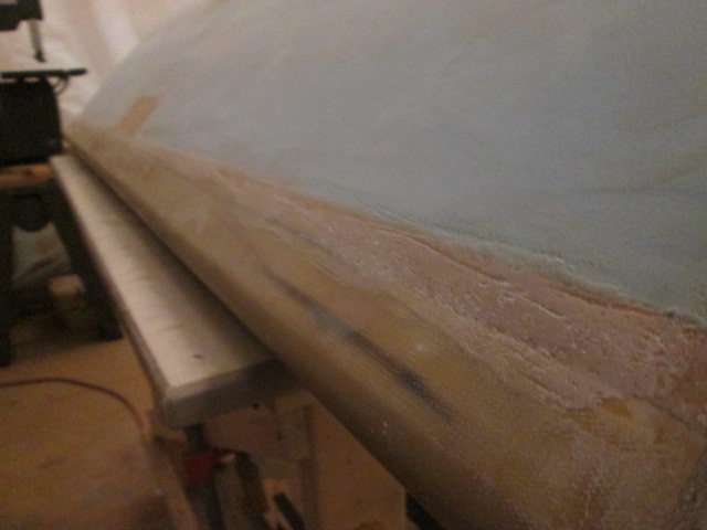

Moving on with prep for remounting the hatch to the cabin, I managed to turn the hatch around on the bench by lifting it up from the hinge side so that the already glassed (and therefore scratch resistant) bumper could be dragged on the table w/o concern. Then I just walked it around the bench to turn it around.
This gave me better access to the license plate recess and to do a better job sanding the fairing at the bumper glass edge.

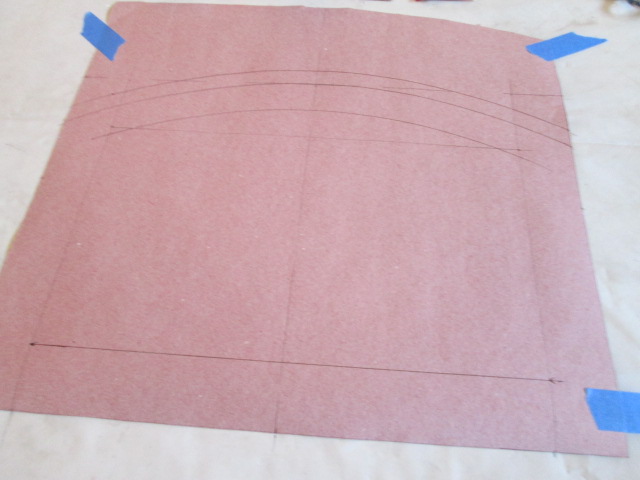

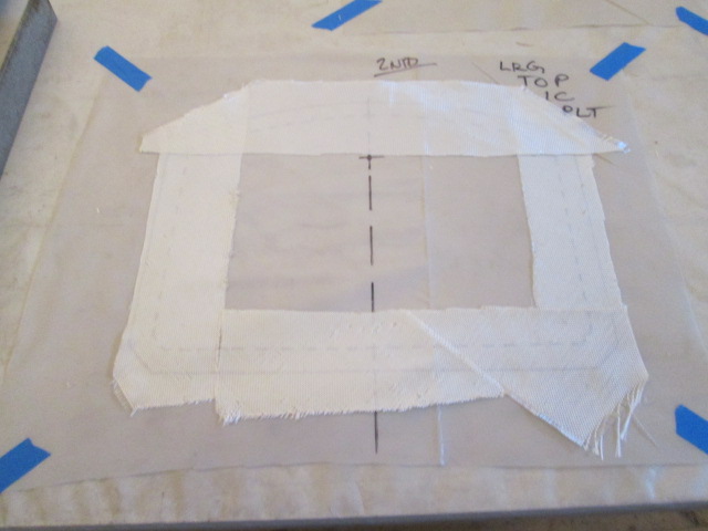

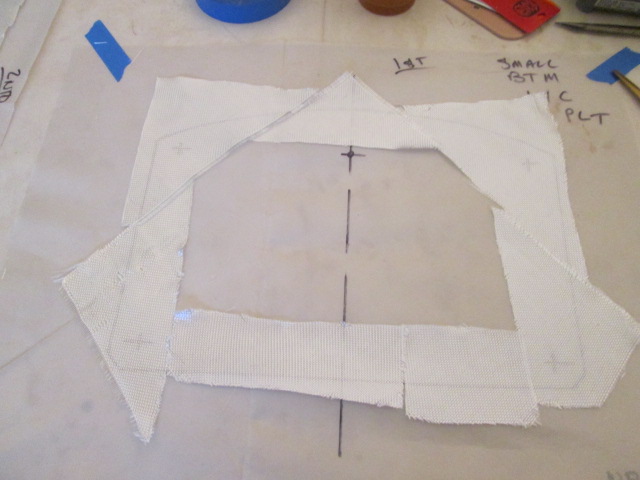

Next I made an oversize template for the license plate recess. The extra piece of blue tape represents the center of the top arc, which I matched to the hatch using the same trammel stick I had used to mark the foam before carving. Then I stepped it off further for the glass to extend out.
I’m going to try and step the two plies of bias cloth out and us the PMPP technique as I hinted at before, using a single ply PMPP to place the smaller ply over the larger, then cutting it all out and laying it down using the larger plastic cut out to help place it all. To that end I traced the template onto the plastic for the wider ply; then cut the template down by about 3/4 inch all the way around and traced it onto the plastic for the smaller step, adding centerlines and a few reference points to both in order to help line them up.
Again, I’m trying to avoid cutting random bits from the big roll of glass so as not to end up short on the big lengths. I did allow extra when purchasing, but until I layout and rough cut the big layups, I’m not comfortable snipping away at the roll for these smaller tasks, especially since bias cuts take up more yardage. This drove me to try and piece out the license plate border from scraps. I didn’t have enough to fill in the whole field, but since the plate is backed by a 5mm ply insert, that is less of a concern; and it might be easier to get the fibers to wrap the contour better as strips, rather than a full panel. At least that was my thinking at the time. Here is the wider ply border pieced together from bias cuts.
And here is the smaller ply pieced together, again just the border of the plate recess where it transitions from the hatch arch profile to the flat surface of the plate mount.
I’m a little concerned that this pieced together method could all go south and be more trouble than it is worth. Plus I figured this was a small layup and rather than stinking up the joint, I should get the cabin side hinge spar set up before I started mixing epoxy.

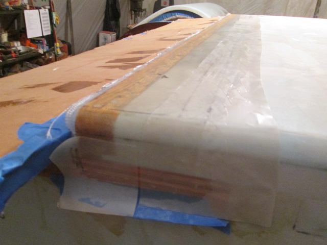

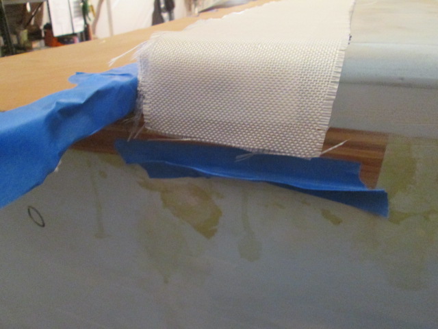

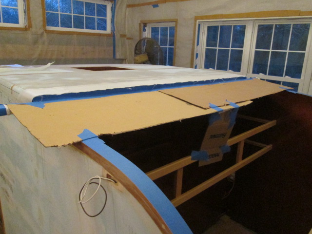

I had already masked the back of the hinge spar with blue tape, but I needed to protect the galley walls and upper shelf face frame; so I laid a stick of the Red Grandis scrap (that I had been using as a temporary hatch prop rod) across the upper end of the galley walls. This helped support some cardboard panels along the leading edge. That I then taped to the back of the spar. Another small scrap of cardboard propped up on the shelf frame supported the back middle of the cardboard splash shelf where the two pieces overlapped. On the side walls under the point where the glass would wrap onto the wall I formed drip edges using 2 inch wide blue tape, and also taped the part of the Red Grandis sticking past the wall to keep it from getting goobered up.

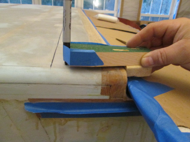

Once that was all set up I found an old block with a nub already screwed on, that I could quickly turn into a scribe; and marked a guideline for the wider of the two glass strips. Then I cut the block back and marked another line for the narrower of the two strips. The nubby block gauged from the back edge of the hinge spar.

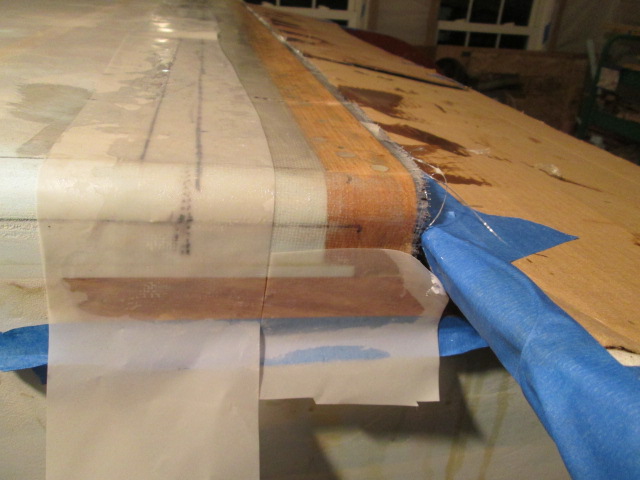

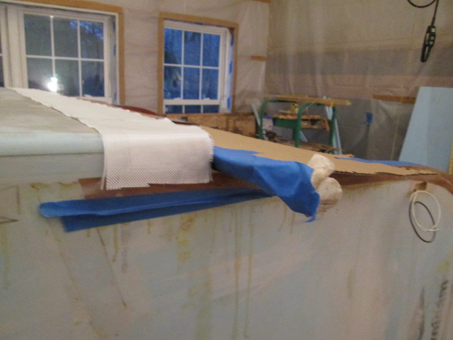

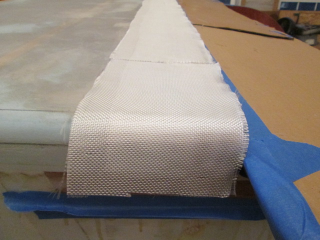

At first I laid the 5 inch wide strip of cloth down first and then the 4 inch wide strip over it, adding in a couple of extension pieces to make up for the 60 inch long strips; but then I remembered a technique that I learned from the Rutan builders that I keep intending to use. By flipping the wider strip on top, the rough edge from the narrower strip will automatically be faired and the rough nubbies along the edge of that strip won’t stick up. Here it is dry on dry before I added some toothpicks to help hold it all in place during the wet out.
You can see the cardboard drip edge masking shelf better in this shot.
Here you can see the narrower strip under the wider, the butt joint at the extension piece, and a little better look at the tape drip edge on the side wall.
Same thing on the curb side.

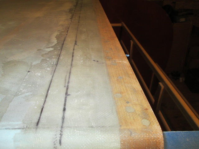

I decided to layup the cabin hinge glass first, since it was a little more straight forward and, by this time, I wasn’t sure how far I was going to get with the license plate. Here I have wet it out, pulled the toothpicks, and laid some strips of the 6mil plastic along the edges of the layup as a poor man’s peel ply. That should reduce the amount of raised nubbies along the cut edge of the glass cloth and reduce the amount of sanding required later to get it faired for the next step.

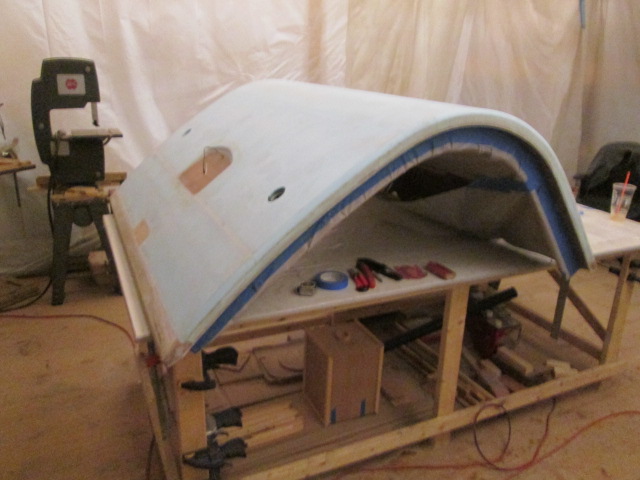

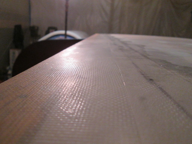

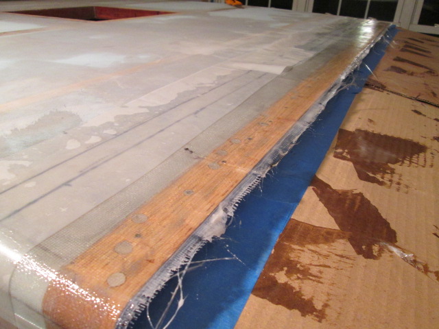

Cabin side hinge glass came out pretty good. Overall not quite as nice as the hatch side, but the plastic peel ply worked really well at keeping the nubbies down along the edges. It did create some puckers and waves where the plastic had some creases and flaws in it; and a slight ridge along the edge of the plastic were it met the cloth, but the advantages were better than the disadvantages. I could have done a better job squeegeeing the edge out, but all in all I’m happy with it.
Clean up consisted of pulling the plastic off (easy); rough trimming the back edge of the glass off with a razor knife; scraping it a little closer to the spar with the paint scraper; and sanding it the rest of the way with the small block. Then there was the standard amine cleanup with water and greenie pad; a little more sanding with a radius block in the corners; and some light sanding up top to take down the ridge lines from the plastic (which was still quicker and easier than having to sand nubbies). In the third pic you can kind of see how the weave in the areas under the plastic is pretty much full with cured epoxy, whereas the area that wasn’t covered by plastic is fully textured with the weave pattern.
Now I’m trying to decide if it’s worth the effort to dry fit the hatch to confirm the glass hasn’t affected the fit enough to mess with the hinge screw locations, or if I can get away with drilling the holes back out now while everything is easier to reach. Since I have only run the cloth over the existing holes and didn’t fill them in it’s not like I’m going to change their location, even if I wanted to; so I’m thinking I’ll just drill them out and see what I get (crossed fingers).

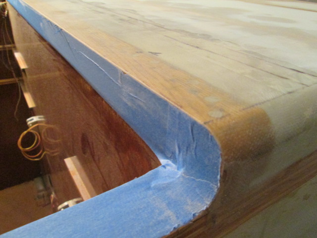

I did drill thru the glass to open up the hinge screw holes on the cabin side hinge spar, and did a little nit-pick sanding here and there on the hatch bumper; but mostly I just walked around the build contemplating.
I’m back to wanting to fix the dip in the curb side wall top, and I think I have a plan to improve my under counter storage options in the galley.
The theme for all of the cabinet face frames has always been three spaces side by side separated visually at the face frames by two stiles. In the galley the spacing was determined by the width needed for the cooler tray with a bulkhead partition between the cooler bay and the rest of the under counter space (with the cooler bay on the street side of the galley). The larger bay has a free standing stile spaced the same distance from the curb side wall providing a symmetrical appearance. This stile is also structural, helping to support the relatively long span of the counter rail.
There is a lot of available storage space in the wide bay under the counter, but the stile would really limit the size of the items that could pass thru to this space. For example, I’d really like to hang the portable solar panel and side wing tables lying flat under the counter (leaving the floor space open for totes), but neither of those items would fit past the stile.
So in this contemplative state, I came up with a plan to make the stile removable. I’ll cut the stile away from the frame; add a tab to the top of it to engage a clip behind the counter rail; and put a small sliding bolt latch at the bottom back of the stile to lock it into a striker plate let into the floor. That way I can easily reach behind the stile, lift the bolt and tip the stile out for loading and unloading; and still have the stile there for support and appearance otherwise.
