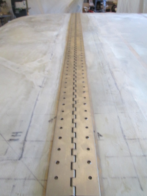

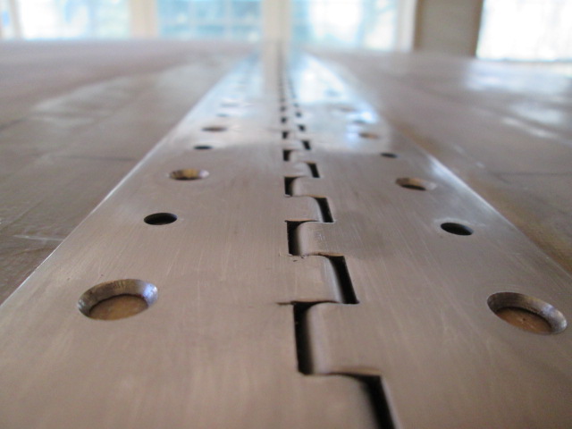

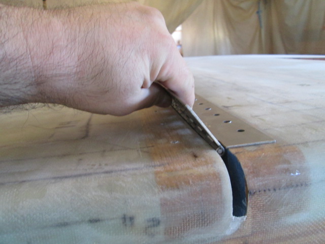

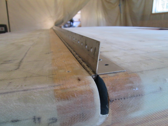

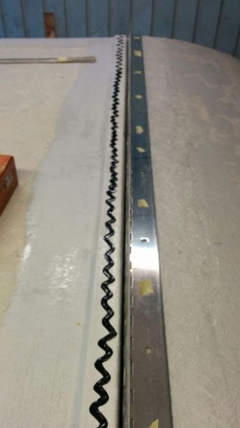

Let’s get caught up again. Between yesterday and today I got the hatch hinge modified. To recap, this was a triple win.
First, I had screwed up when I cut the hinge to length. The end goal was to have one set of holes where the hinge screws down hard to the spars and a second set of holes for the aluminum trim strips that will clamp the outer rubber seal strip to the top side of the hinge leaves (rather than just screwing down thru the rubber and having the hinge squirm around under its resiliency). And when I cut the hinge I forgot to offset the OEM countersunk holes so that the trim retaining screws would be symmetrical across the camper. So by drilling and countersinking the second hole pattern I get the symmetry I want.
Second, by flipping the hinge over so that the barrel of the hinge nests down in the gap between the spars, the seal rubber will lay nice and flat for a much sleeker look. I saw this done on another person’s post and I really liked it much better (sorry I don’t remember who to give credit to).
And third, since I would have to countersink the new pattern anyway, I could increase the size of the screws from #6 to #8, hopefully solving my issue with snapping screws.
Now if you consider the diameter of the screw heads and the 82 deg taper, compared to the thickness of the hinge leaf… a mere 1/16 inch SS… the thru hole in the bottom of the countersink is actually larger than the nominal screw diameter. That means that the OEM holes are already big enough to accept the increased size of the #8 screws since the countersinks for their heads will be up in the seal trim pieces. In a way, a fourth win; nothing had to be done to them.
On Saturday Yvette and I ran some household errands, so I got a late start. Then I finished up early since we were going out with Karl and Chris to celebrate Chris’ upcoming B-day, so it was a relatively short session.

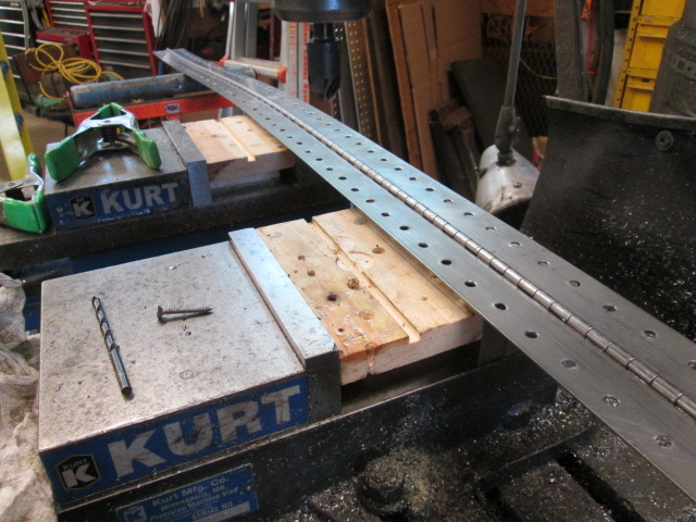

I did manage to layout and prick punch the second hole pattern. I used spring clamps to clamp the tape measure and hinge to the edge of the bench; then used a combination square and carbide scribe to pick off the hole spacing; and finally, adjusted the square for the edge distance and went down the line making the cross hatch marks.
If you’ve never done this type of layout there is a technique to placing prick punch marks very accurately. A nice sharp tip on your punch is the first thing. If you can’t “feel” the tip of punch into the cross hairs of your scratch lines, get it as close as you can by eye then just barely tap the punch with a light ball peen hammer. If you’re not happy with the accuracy of your initial mark you can tilt the punch a bit toward the direction you want and move the mark by tapping a few more times a little more firmly and driving the mark to where it needs to be. Once you get the mark well centered, straighten the punch up and give it a good rap or two to really set the mark.
Karl and I made a few fine tuning adjustments to the iron worker, taking the slop out of the spindle guides and lubricating all of the grease points, so that the small punch would center in the die consistently. Then Karl gave me a hand running the hinge thru punching all of the new holes. It was a big help holding the hinge as it can be a bit floppy when laid open flat; and running the iron worker is already a bit like rubbing your tummy, patting your head and dancing on one foot at the same time. You have to unlatch the punch ram with one hand, hold the part into the punch prick, press the foot treadle and lift, all while getting the hand held stripper tool in the right place on the up stroke. Do that 60 times.
I did the layout and prick punch work upstairs while my camera was downstairs, then while punching the holes my hands were oily from the WD40 we used as a tool lube, so I didn’t get any pics of any of it; but here is the hinge flipped over with the second pattern punched.

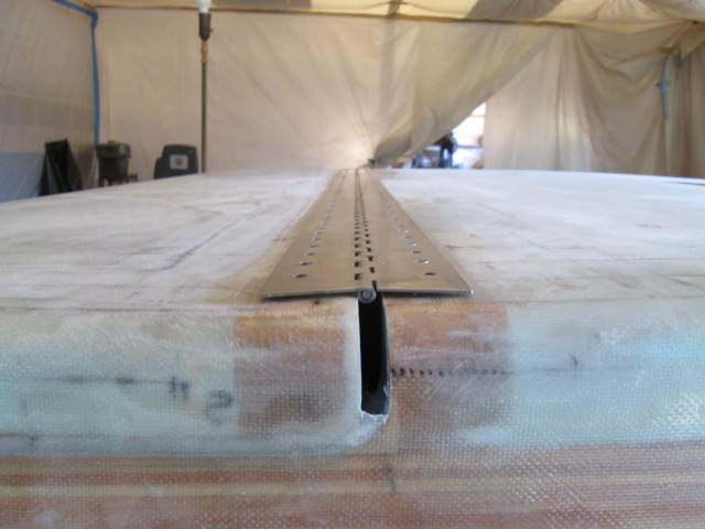

Just eyeballing to make sure that the existing holes in the spars still line up well. I had some concern that I might have to shave some off of the rear face of the cabin side spar, but there ended up being plenty of clearance with a little wiggle room.

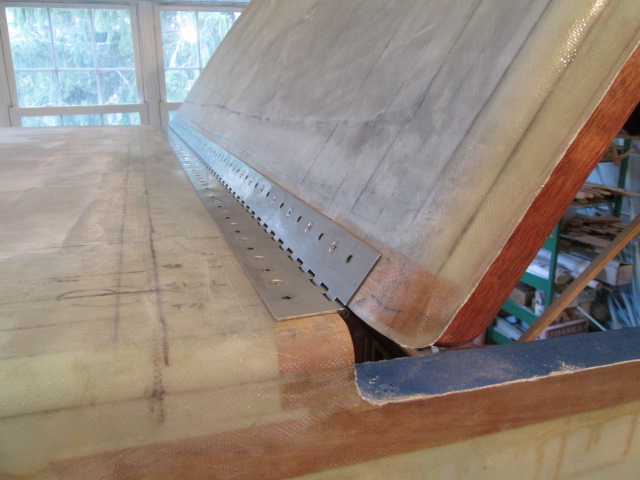

This pic shows the hinge opened all the way back past 90 degs, followed by a pic showing the approximate position the hinge will reach when the hatch actuators are at full stroke, approximately 60 degs, showing that there is plenty of travel with the hinge reversed.

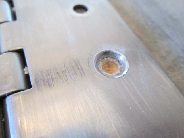

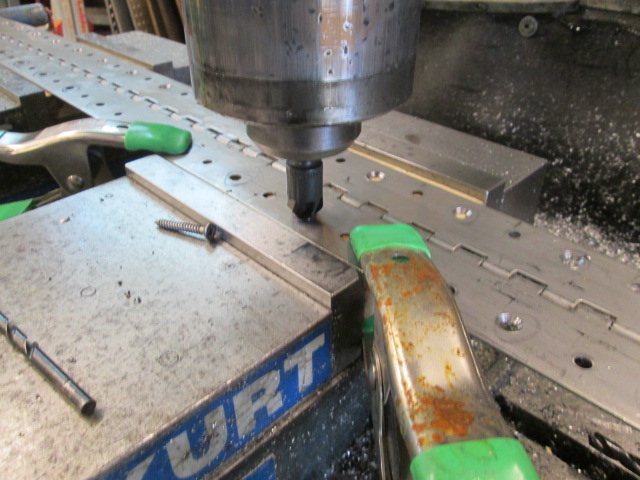

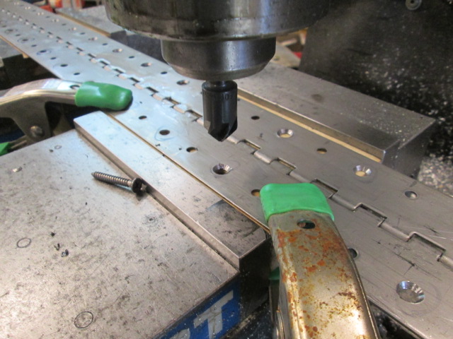

Today I did the countersinks. I used a couple of pieces of waste wood shimmed up in the double vises on the mill, then ran a 1/4 inch cutter down thru the middle to cut a slot for the barrel of the hinge to register into. One of those holes was drilled thru to align with the hole offset in the hinge so that the chips would fall thru and I could drop a screw in to check the depth of the countersinks as I went.
With the hinge flipped over and the barrel just snug in the slot I used spring clamps to hold the hinge down pat. Even still, the leaf had a little flex and the wood isn’t as stiff as a chunk of aluminum would have been, so it worked best to eyeball the depth of each countersink and check frequently with the screw. The size of the punched hole worked out great so that when the depth of the countersink was about perfect there was just a hair thickness of cylindrical hole left at the bottom, so I quickly got the hang of finding the right depth fairly accurately. I moved the hinge for each hole; the spring clamps with rubber pads had just the right amount of give to where if I gave the initial feed a little jab like poke it would center up the hole, rather than starting and staying lopsided.

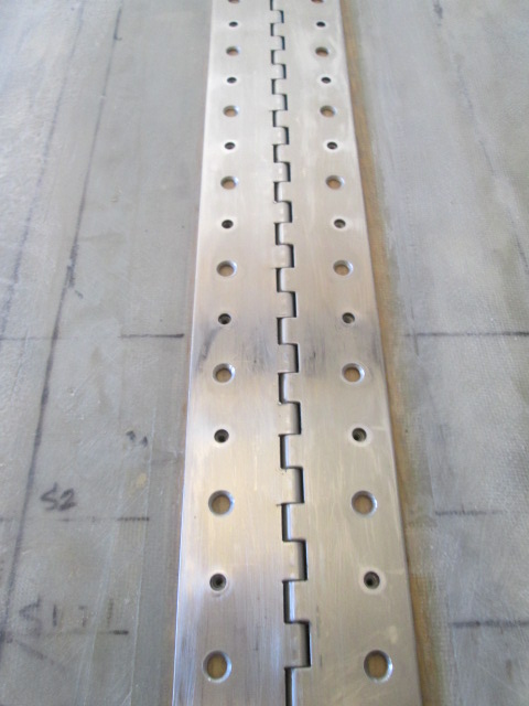

Not bad. You’ll note that I circled every other hole with a sharpie just to make sure I didn’t mess up the pattern, and although the lube acted as a solvent dissolving the ink, I could still differentiate the marked holes. Also, you can see how the countersinking bit made just the slightest raised burr around the edges of the holes.
Back upstairs in the loft I used the small very fine file and small sanding block to scuff off the burrs on both sides of both leaves, cleaned the hinge well and did another test fit.
I’m pretty happy with that! Unfortunately the local orange box didn’t have enough of the #8 screws in SS, so I will have to order them.

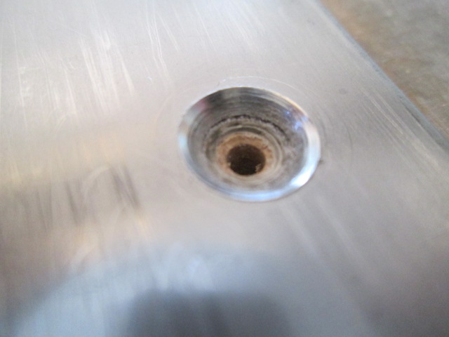

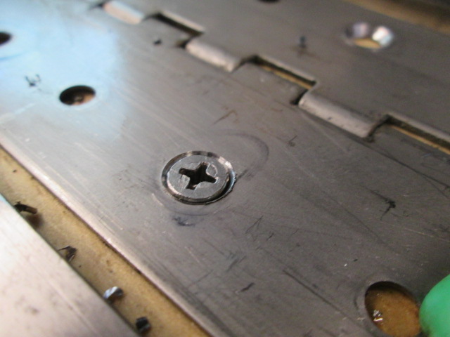

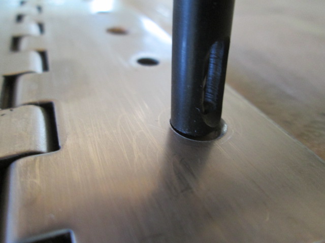

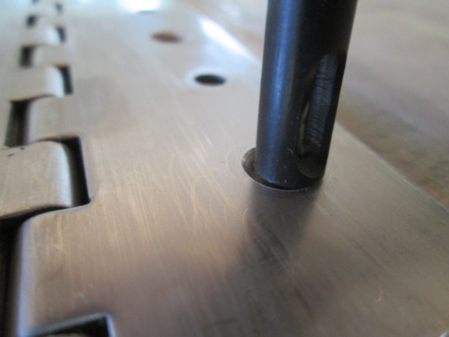

I checked my new centering drill tool against the countersinks and found that the diameter of the tip of the tool is just a little smaller than the countersink, meaning that it won't necessarily center itself perfectly. WTH :?
Oh yeah, it's because the hinge leaves are so thin the bottom of the countersink isn't as small as it would be at the full depth of the screw head. I'll have to run a counter sink down in the hinge holes to scoop out a little of the wood/FG first making room for the lower portion of the screw head and giving the centering drill something concentric to pilot off of.

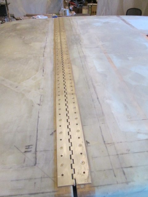

I got the hatch hinge refit tonight.

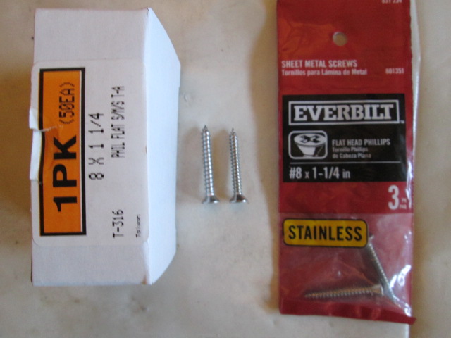

The orange box store only had the #8 x 1-1/2 inch SS sheet metal screws in small packs of three (3) and only had a few packs on the rack. I needed something like 122 screws, so I bought them from McMaster-Carr. Since the seal trim screws will be exposed to the elements, I selected 316SS. Lesser alloys in the 18-8 family are more likely to rust, especially if exposed to salt, such as in coastal regions or from deicing road salt. Since they came 50 to a box and I needed 62 for the trim, plus 60 for the hinge, I just went ahead and ordered all three (3) boxes in 316.

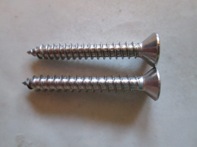

Here is a comparison of the Everbilt brand from the orange and the bulk 316 from McMaster. The store bought ones (top in second pic) have a finer thread count and a little more thickness at the top of the head.
Note that I am using sheet metal screws in lieu of wood screws. The sheet metal screw threads go all the way up to the head making them well suited for fastening thin items (like this hinge and the 5mm plywood), whereas wood screws have a shank that would require a clearance hole to be drilled.

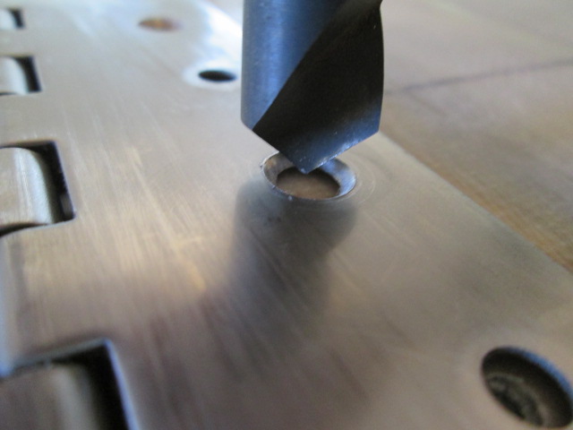

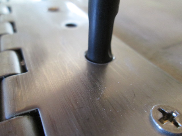

Here’s what I was talking about with the self-centering drill bit. The thinness of the hinge leafs make the bottoms of the countersunk holes larger in diameter than the guide was designed for. In the first pic the guide is all the way to the left, and in the second pic it is to the right.
The solution was to use this 82 deg chamfering bit to hog out a bit of the FG and oak. The bit self-centered in the SS and made a nicely centered conical divot.
Now the self-centering drill guide actually had something to find the center of and I could drill the pilot holes. (The screw in the foreground is one of the old #6’s just being used temporarily here to locate the hinge thru the original holes until I get the new #8’s zoomed in).
The self-centering drill didn’t drill deeply enough for these screws so I used these holes as pilots and deepened them with my Dewalt pilot/countersinking quick change drill/driver.

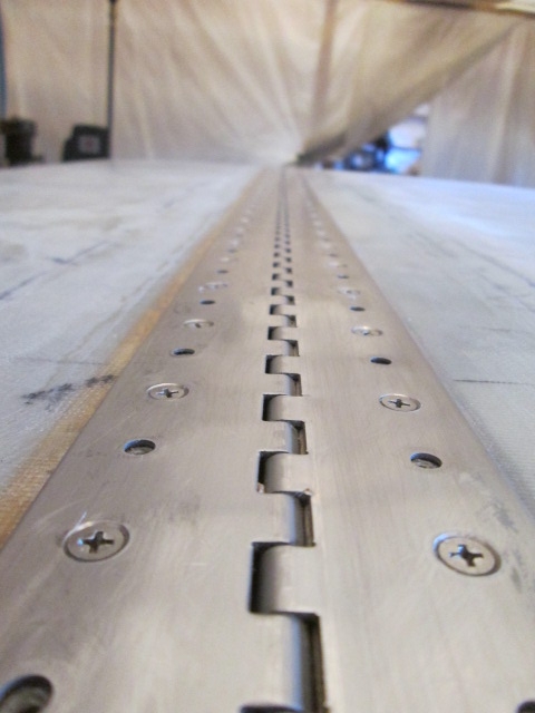

Here is the finished result. All of the screws socked down nice and straight with very little variation. I’m pretty happy with the result.
Doing all four of those operations (centering, drilling, drilling deeper, and installing a screw) 60 times took most of the session, but I couldn’t resist making an attempt to cut the hatch free and opening it again. I started with the serrated steak knife but found that it was a bit difficult to follow the curve. Due to the relative thickness of the blade it wanted to bind.

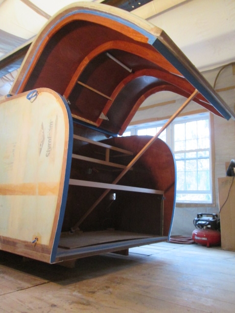

The hatch is cut free again. It is notably stiffer than before, and slightly heavier.
I like the hinge orientation much better now.

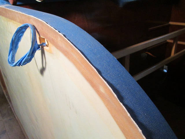

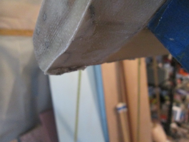

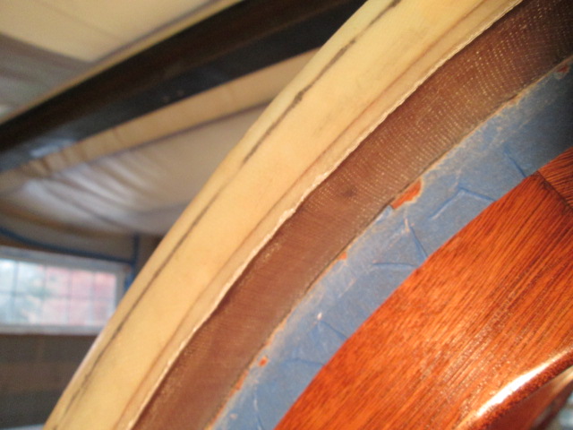

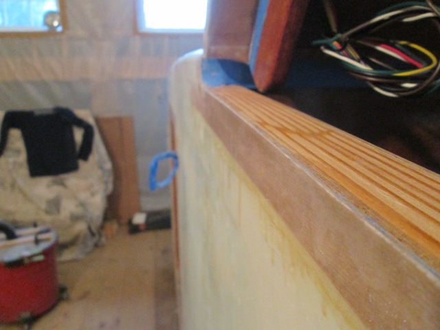

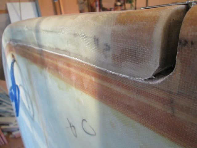

The corners of the bumper need to be faired back. This is where the wall glass wrapped onto the hatch, where I cut down the middle of the seal gap.
A little higher up on the street side of the hatch you can see where I will need to scrape and sand back to the glass on the seal lip, but it all seems to be well adhered to the flox corner.
In this pic of the street side galley wall you can see the other side of the cut where the rough edge needs to be brought back to the wall edge that was masked with blue tape previously.
After scraping the bulk of the edge down; sanding flat (-ish) to the wall edge; knocking the sharp edge off a tad; and removing the tape it looked like this.
I did this right away mostly to avoid getting hurt by the rough edge, or having it rough up the hatch when I close it again, but it didn’t need to be perfect at this point. This edge will get a rabbet soon for the hatch seal to nest into.
I got the curb side scraped down mostly, too, all but to the floor before having to bug out for the night. I’ll clean up the hatch edges once it comes back off, since it will be easier to reach and I won’t have to work overhead. The hatch has to come back off anyway to fix those broken screws and for better access to glass the roof.
