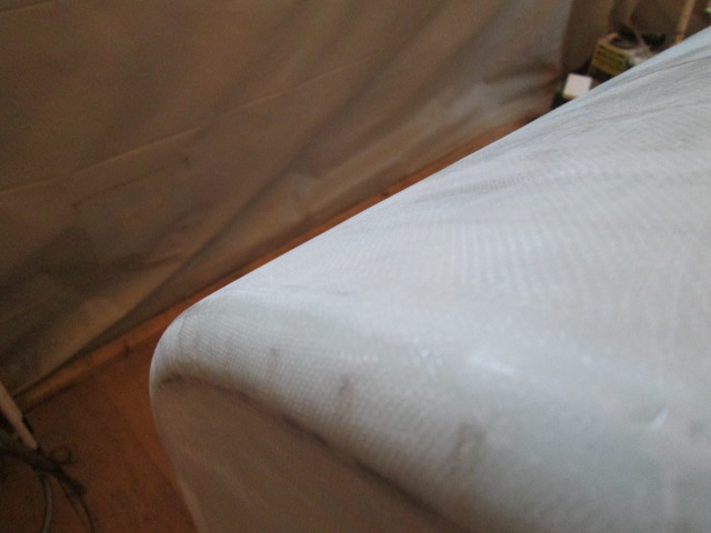

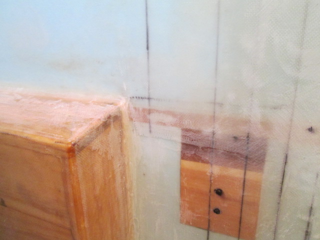

Tonight was clean up of yesterday’s layup. The plastic strips came right off. There was a little fringe on the street side of the locker that I trimmed away with the utility knife; a few drips that ran down the street side lower front that I scraped off; and then it was straight into washing amine.
Where the creases were in the plastic strips (from how it came folded and rolled in the OEM box) it actually created slightly low spots. Not really low, but leaner. Whereas where the plastic was squeegeed down and stayed down it tended to draw epoxy to it filling the weave and zipper edge, yet still leaving a smoother transition to the surrounding area. The top only required a quick scuff with the small block and 80 grit.

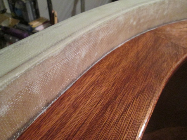

Even though the lower wall below the sparettes will be covered by rock guards, I went ahead and faired the “zippers” there (the cured fringe along the edge of the weave); nothing too crazy, just knocked them down close. The end of the locker top only needed a little sanding and touchup of the fillet where it wrapped from horizontal to vertical.

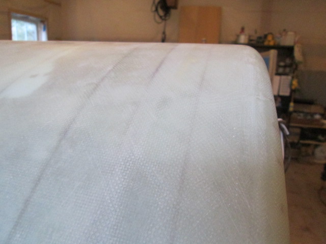

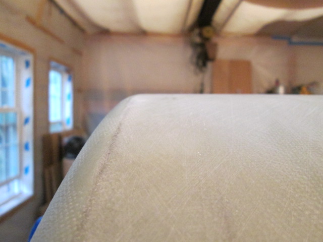

After working along the top of the locker, I moved up and faired the zippers along the profile. I used the 36 grit medium block some, then switched back to the small block to finish up. Curb side first then street side.
One more of the street side looking over the profile radius downward.
I finished up by lowering the front of the cabin back down level and wiping it all down with a slightly damp paper shop rag one more time.

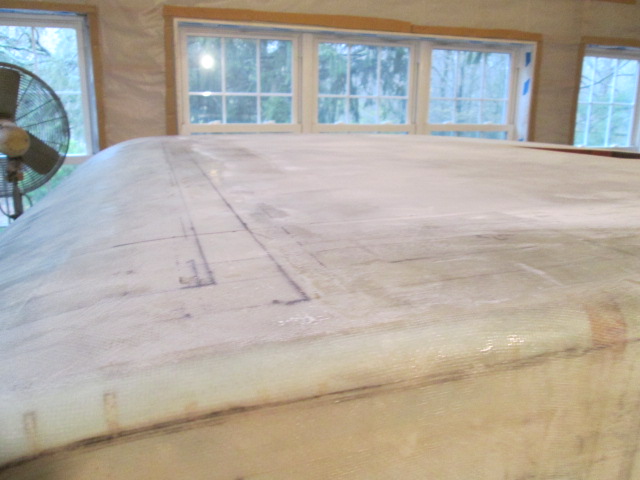

Next things on the agenda are to get the hatch flipped over to fair the other edge; and prep for glassing the rest of the roof. That involves masking the roof vent opening (or at least moving the doors out from underneath and putting some cardboard inside under the opening), and going over it all with the fox tail brush and vacuum cleaner. I’m trying to decide if I want to try and do dry on wet and stack the plies as I go, or do it 2 plies dry on dry. I’m leaning toward dry on dry at the moment.

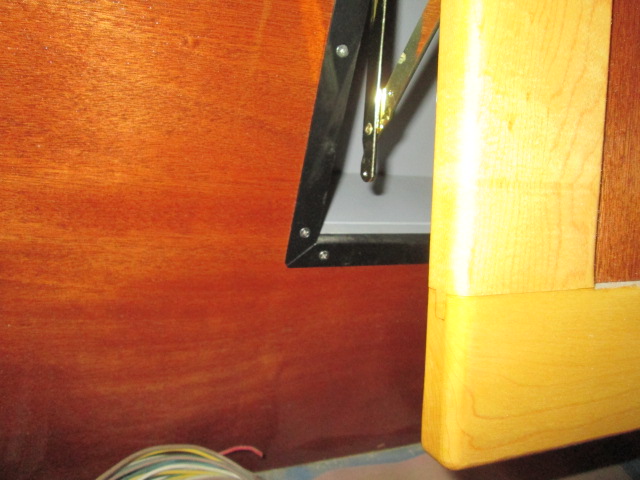

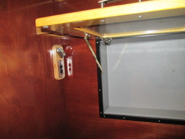

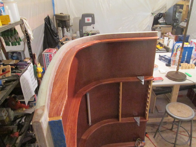

The last time I had a visitor to the loft and was giving a tour I couldn’t get the front locker door to open. I knew it wasn’t locked, but the door would barely budge. I suspected that the hinged strut had somehow managed to invert and bind. I figured I would take a look at it later, but more or less forgot about it for the time being.
Well I’m expecting a visit soon from a fellow TNTTT’er who has traveled a long way, and I wanted to get that sorted out before giving the next tour. I could get the door ajar enough to slide a thin stick in thru the side to try and push on the strut, but that didn’t change anything. Then I tried to come in from the bottom to get behind the strut and see if I could knuckle it forward; still no good. Finally I got my flashlight out, laid down on the floor and looked up under the door. I could see right away what the problem was likely to be.

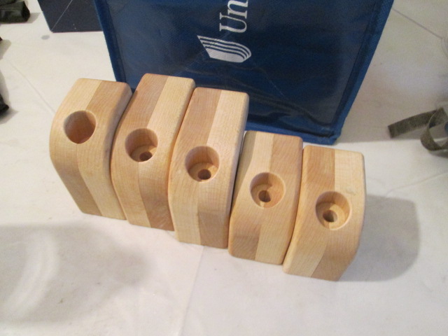

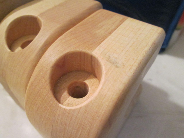

Remember these?
I had stowed the rifle rests sitting loose in the locker and when I jacked the cabin from the side they slid over to the strut side. When the door goes closed the elbow end of the strut actually sweeps past bottom dead center and rises up slightly as it goes back the last 10 deg or so. Here’s a pic of the locker door open with the strut unfolded and extended out to hold the door open.
Compare that to this pic as the door is going closed. The strut is nearly folded back on itself. One leg of the strut is slightly longer with the detents formed in it that engage the other leg extending past the hinge point. Because of the articulating link style of hinge that I chose, that extended part of the strut elbow sweeps up at the end of the travel just as the door shifts up on the hinges upon closing.
So when the rifle rests slid under the strut they blocked it from sweeping back downward, acting like an internal door stop, or wedge, preventing the door from opening. Essentially it became a locked cabinet with no key or access to open it.
I was able to bend a piece of welding wire so that I could snake it up under the door and nudge the rests out from under the strut, which allowed me to get the door open again.
The offending rifle rest suffered a minor dent, which can be sanded back out and reoiled.
I have never much liked the brass colored strut, so will look for one of those spring style props to replace it. The spring would be flexible enough that it shouldn’t be able to get hung up on anything inside of the locker. The other option would be to install a thin partition creating a dividing panel that the strut slips behind, preventing things from being able to shift under the strut elbow.

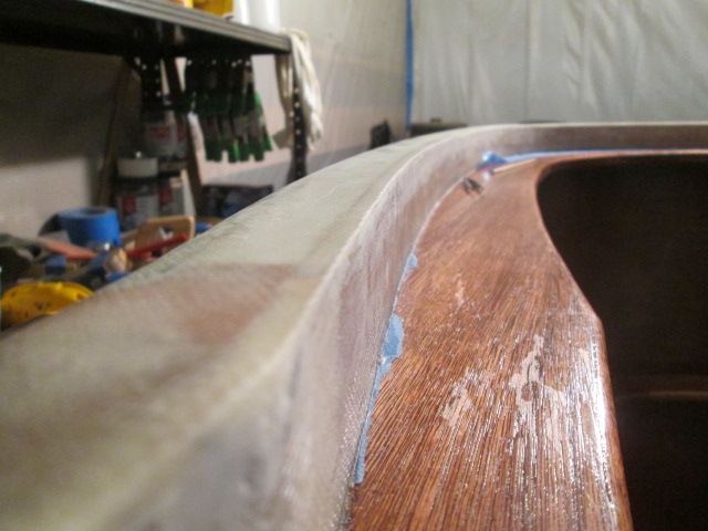

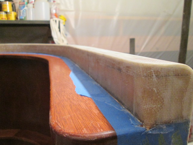

Karl helped me flip the hatch onto its street side edge so that I could clean up the rough cut glass along the curb side sealing edge. Here it is after scraping and sanding, hinge end first then bumper end. Note that I had also started peeling off the blue tape. You can also see the spots where polyurethane got lifted by previous applications of masking. I'll fix that all later during the final finish out stages.
I used the hair dryer to soften the tape, hedging against more poly damage, and for the most part it went okay, except on the front of the hinge spar where more poly peeled off.
