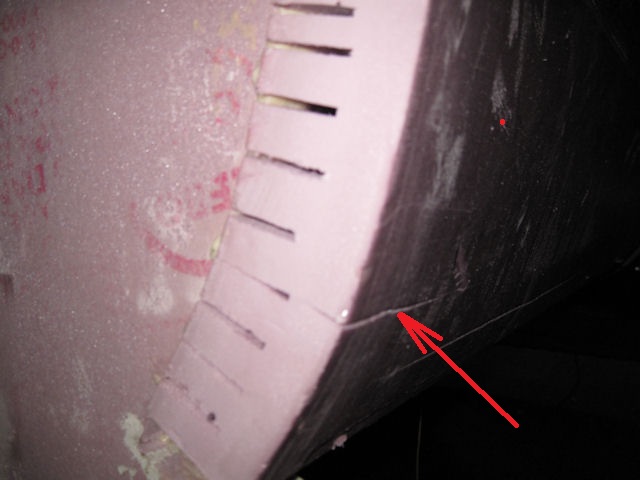

Postby Cliffmeister2000 » Mon Jan 02, 2012 9:53 am
mikeschn wrote:
Cliffmeister2000 wrote:Mike, I haven't seen where you posted what cracked? :thinking:
Ah, you're right.
Here's the crack. I've since filled the crack in with gorilla glue, and it's just waiting to be sanded back down.
If that's a major stress point, I wonder if it would be a good idea to make a cut (kerf) clear across the width of the trailer, and fill the kerf with spray foam that you can sand before covering the outside?

Postby mikeschn » Mon Jan 02, 2012 5:08 pm
Too late Cliff, It's all glued up. I think it'll be okay now!

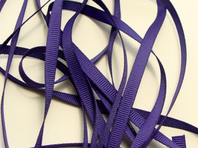

Postby bonnie » Mon Jan 02, 2012 5:38 pm
The ribbon I would recommend is grosgrain ribbon. It's finished on both sides and edges and is fairly sturdy. You would want to test it with the glue before you commit to buying enough for the seams. It comes in differing widths and colors.

Postby mikeschn » Mon Jan 02, 2012 7:43 pm
bonnie wrote:The ribbon I would recommend is grosgrain ribbon. It's finished on both sides and edges and is fairly sturdy. You would want to test it with the glue before you commit to buying enough for the seams. It comes in differing widths and colors.
Bonnie
Hey, that looks interesting.

Postby bonnie » Mon Jan 02, 2012 8:43 pm
Hot glue will certainly work. It might need a pin or two to hold it until the glue sets up. It doesn't ravel as much as many of the more decorative ribbons would.
A quick google brought up this site. The ribbons come up to 2.25" wide. Don't know anything about the company, but should give you an idea of what's available. Avoid anything with wire edges.
