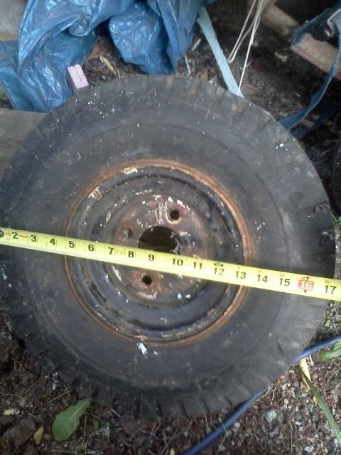

I‘ve got a tire question ... can I use the smaller 12” tires instead of the 13’s on there now ? If I keep the 13’s , I’ll have to construct wheel wells .. grrrrr!!! Although HUGE , the trailer should still be fairly Light ... I see HF uses the 12” tires on it’s heaviest trailer ... Curious !!! :thinking:
Re: FoamStream...
Postby Wolffarmer » Sun May 19, 2013 6:46 pm
Check the load rating on the side walls. Could go with pop up trailer tires if you have to.

Pop up trailer tires ... who Dat ??? I guess they’re tiny eh ?? that would be cool ... schmaybe’ ? ... I don’t planning on towing it far or Fast ...
Re: FoamStream...
Postby Wobbly Wheels » Sun May 19, 2013 7:35 pm
GPW wrote:Pop up trailer tires ... who Dat ??? I guess they’re tiny eh ?? that would be cool ... schmaybe’ ? ... I don’t planning on towing it far or Fast ...
Here's what mine have right now:
Tire size is 5.70-8, which is an 8" rim. The ones I've seen all seem to be rated about 800lbs per. There is a 12" that fits the bolt circle and takes you to about 1000# per tire (that's I figure on switching to). OD is 16-17".

They are wide but from what I have heard can be expensive. And all things else equal would give a rougher ride. But if you wait to bug out, 5 miles per hour won't bother a thing.

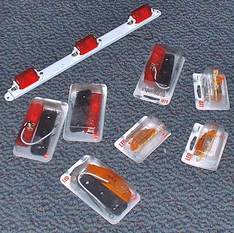

First thoughts this morning after looking at the Beast ... Marker lights .... Although I’m just under the size limit @79” wide ... some markers might be a good idea anyway .... have a bunch of LED markers left over from previous builds . (bought and never used :roll: ) Should be easy to install in the foam and I can run the wires inside through the lightening holes in the ribs ... :thinking:
so many little details ... :?

I would caution against running the wires thru the holes in the ribs in any fashion that might temp someone to use the wires like a hanger rod; lest you run them inside of conduit.
Re: FoamStream...
Postby GPW » Mon May 20, 2013 9:30 am
KC, Hmmm??? never thought of that ... True huh !! OK,wires through conduit :thumbsup: 8) ... PVC plumbing pipe should work , and maybe “she” can hang stuff on it , although there’s a gazillion rib holes to hang things on already ... :thinking:
Here’s the lights I have already ...
