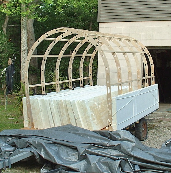

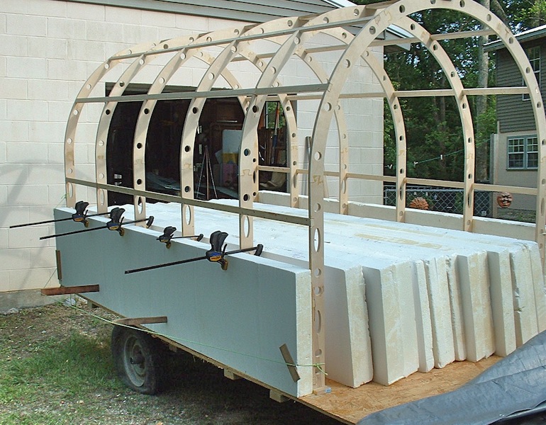

I went by Vinnie’s yesterday with my Australian friend who was in town , planned the ribs for the front .... will go back this week for the cutting part (CNC) .. That will be the last of the CNC cut parts we need to finish this trailer ... 8)
Going to try and fit some foam sheets to the sides today ... the bottom straight ones anyway ... then comes the kerfing ...
Re: FoamStream...
Postby GPW » Tue May 21, 2013 5:30 pm
The two bottom sheets are glued on and drying ... :D Best of all the foam is now stored in the trailer and NOT in my Studio .... so life there can return to normal .... if it ever was “normal" ... :roll:

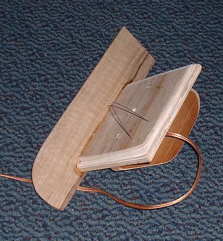

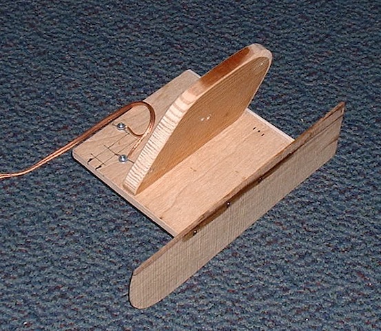

GPW wrote: Bonnie , the kerfing ...that’s Next ... I have to make that kerf tool ... quick ... :o
Took me about 20 minutes to make mine....

Postby pchast » Tue May 21, 2013 9:13 pm
George,
In the photo your jig looks like you used a heavy wire. Can you tell me what it is?
When I try to do the same with .035 welding wire in 1.5" blue foam it
bends before making 'cuts'. Even with 'no' pressure...

pchast wrote:George,
Thanks,
Pete
Are you using .035 or .35? I am using .30 welding wire. I am using a car battery charger set on 2 amp charge for the power supply. I found 3 feet of wire to be a good length to keep the heat right. Check out my hot wire thread for more info. viewtopic.php?f=55&t=55323

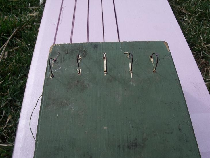

Got my kerf tool made ... :D I’d try it out straight away , but have to bring my truck in for servicing this AM ....

Postby pchast » Thu May 23, 2013 9:05 am
What I have a spool of is 30 thousandths, .030. I stopped at the local body shop and got 10 ft of .035 but found that no better. I am using 3 ft lengths and it bends before it cuts. I have a 10/2 amp charger on 2a and the start setting. In the charge setting it keeps cycling, clicking and getting cold. :thinking:
