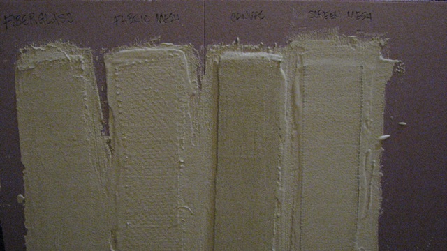

I used the Foam Coat with the Boost additive to see how well that stuck the cover materials to the foam. They all did real well with a pretty thin coat. Here's the pic
As I expected, there are no issues with the foam and all the materials adhered well to the foam with no turned up corners or anything like that.
I'm about to put on a second coat to see about getting a smoother finish. I also forgot to use the technique of tapping the object while it is drying to promote self leveling
